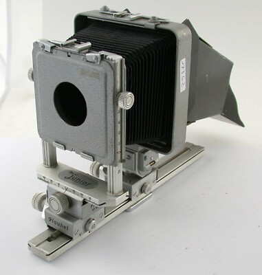

Been wanting something lighter recently. Have 50+ Makina 6.5x9 planfilm holders, and about as many RADA glass and film holders. Also have a good supply of 6.5x9 Makina 120 backs in 6x6cm and 6.5x9cm. Many lensboards here Peco Jr which were my mistake, this stuff looks kinda identical some times. I do have a Pecoflex Adapter for my Makiflex Autos, it's identical to the front end of the Peco Jr so I already like the handling. I have most of the original lenses in the catalog, just need more Peco Jr 95x95mm boards to move them around to. Starting with the 47mm chrome Super Angulon, up to the 180mm chrome Symmar. Should be another interesting system which fits in with my other stuff. And I am contemplating a medium format digital back in the far future and this could very well be the ideal platform for it! So anybody here own or using the Peco Junior? Your experiences please :smile:
Here's my new camera, on it's way from Germany. Interesting rear hood included, not sure what the deal is with that.

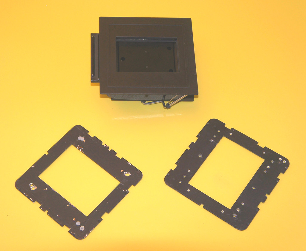

I've perused my Plaubel stash, and all of this is original Plaubel Peco Junior pieces and parts. On the far left, 6.5x9 and 2x3 Linhof Plate Film Holders. and Graflex 2x3 Holders. Also the Jim Galvin 6x9 back I bought twenty years ago from Glenn Evans. Will be modified to fit Peco Jr. Moving further right, PJ1/325 Adapter for spring loaded ground glass screen, 6.5x9cm, for Universal Darkslide 6.5x9cm with Normal Double Groove. I'll bet these are RADA and they came with the adapter, fit very precisely. They hinge open to load as you can see. Then the PJ1/431 Soft Wide Angle Bellows. Bellow the soft bellows, three original lenses yet to be mounted. The 47mm F8 SA, 135mm F5.6 Symmar, and 150mm f5.6 Symmar, all in original Compur. Lensboard upper right, more are coming. In lower right are Rear Mounting Plate, maybe for a digital back? Something like the Hasselblad or similar would be sweet. So MF film and digital all in one small package.

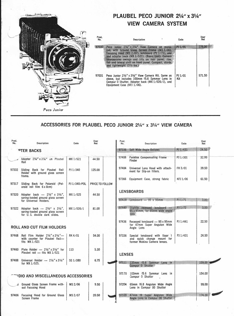

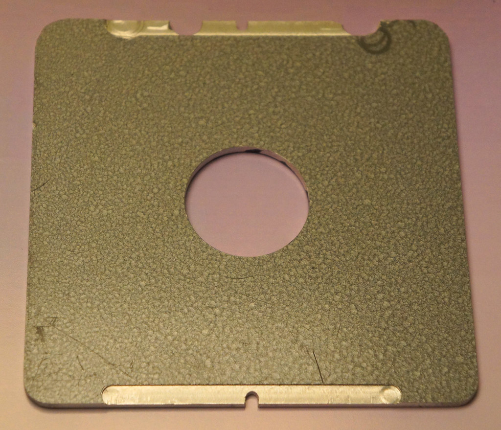

I forgot I had this mixed in with my extra Maki boards. Glenn Evans designed this custom Peco Junior Rear Board, it was excess and I got it cheaply. It is a good design, very heavy and thick and Hammerloid finish. Exactly the right thickness to fit super tightly on the Peco Jr. This will hold the Jim Galvin Back or maybe the digital. We will see.
Plaubel Peco Jr Catalog by Nokton48, on Flickr
Three additional original Peco Junior lenses are on their way; the 100mm F5.6 Symmar in more modern Compur, a 65mm f6.8 Angulon in vintage Compur, and from Igor in Cleveland, the 135mm f3.8 Xenar in Compur. The Xenar should be extra bright to look through. The 4.5 Xenar is also in the European catalog, I think I will prefer the F3.8

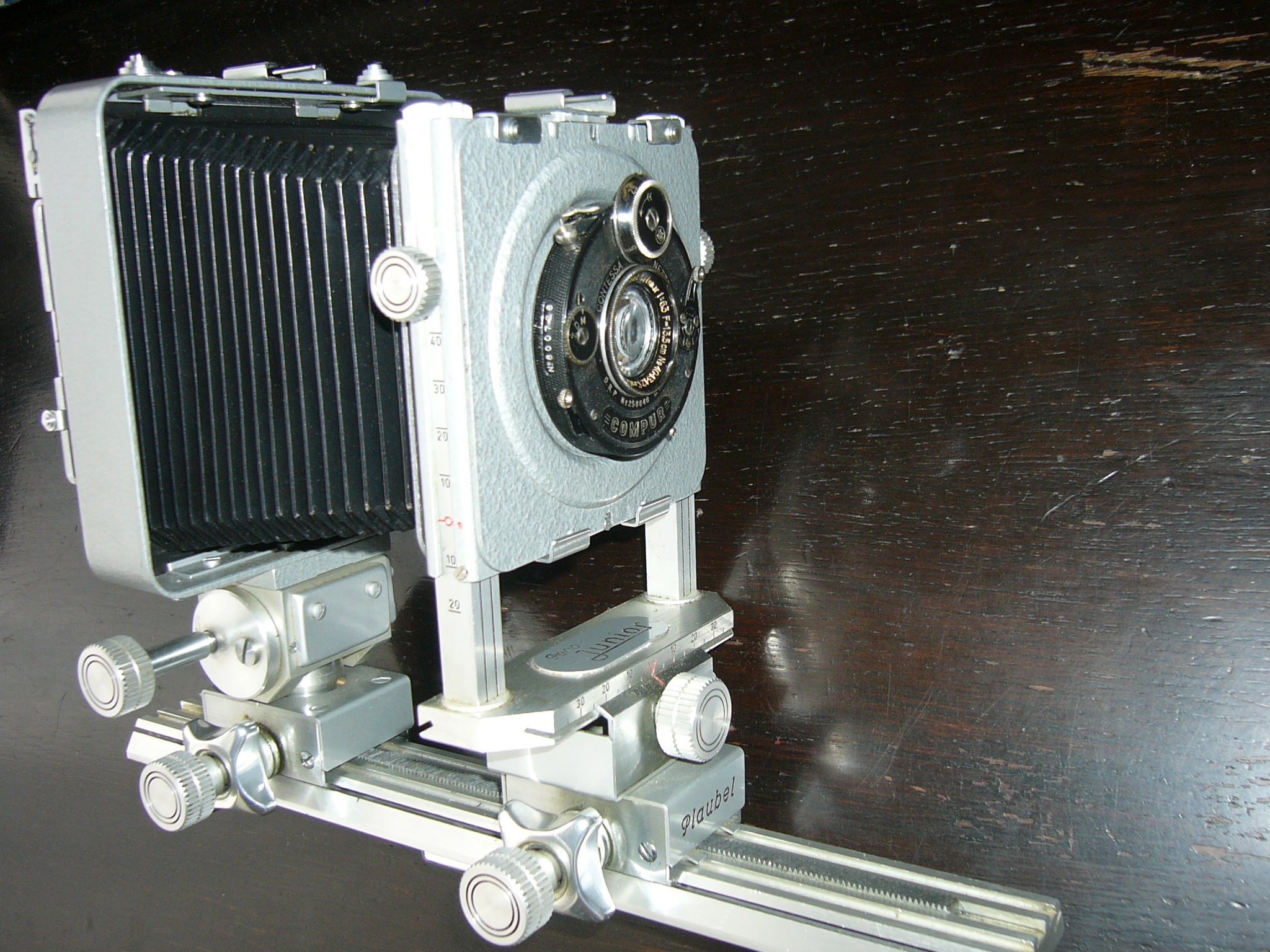

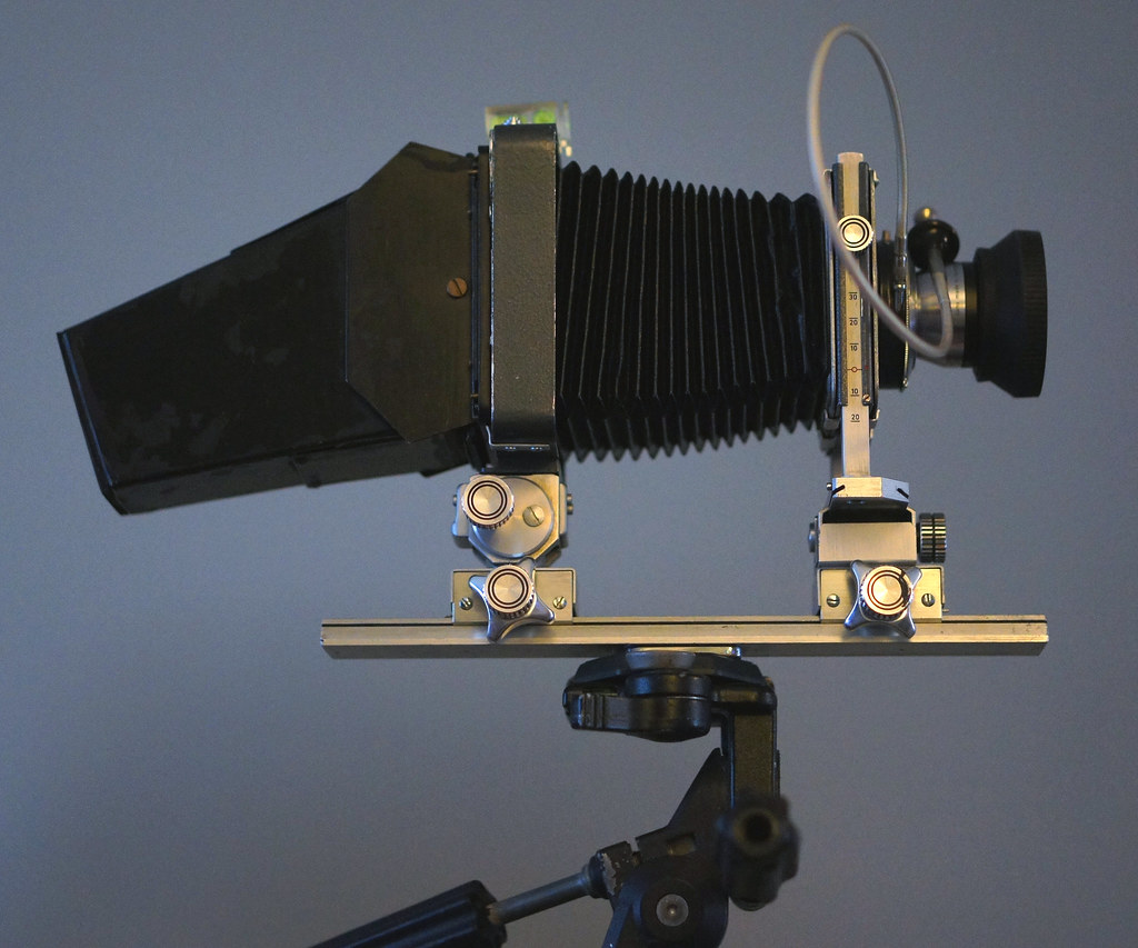

My new to me Plaubel Peco Junior arrived from Germany today. Shown with my 210mm f5.6 Symmar lens, will focus close-up with max bellows extension. Amazingly light weight. I love the Reflex Viewfinder, the hood is adjustable side to side. But I don't think it will take film holders in any way. But I have other film backs that will fit, I guess the Reflex Viewfinder works with Makina Rail Backs and Holders, I just rebuilt one yesterday with a nice popup hood.
Looking forward to learning to efficently use the new camera.
Congrat with your Junior! Nice piece of hardware. Especially the swivelling angle finder is nice, never saw that before. Early this summer a took my own Junior to the Copenhagen harbour, as I hadn't been using it for quite some years. It turned out the light sealing betw. bellows and camera and lens panel /camera had all but turned to dust, whence I got no pictures but only false light. Have not fixed it yet, too many projects. Here's a pix of my Junior, it has, as you will se, the ordinary ground glass back fitting the ordinary Rada roll holders and cut film holders.
Oh - and by the way, thanks for taking the trouble of keeping us opdated with your many experiments in this field!

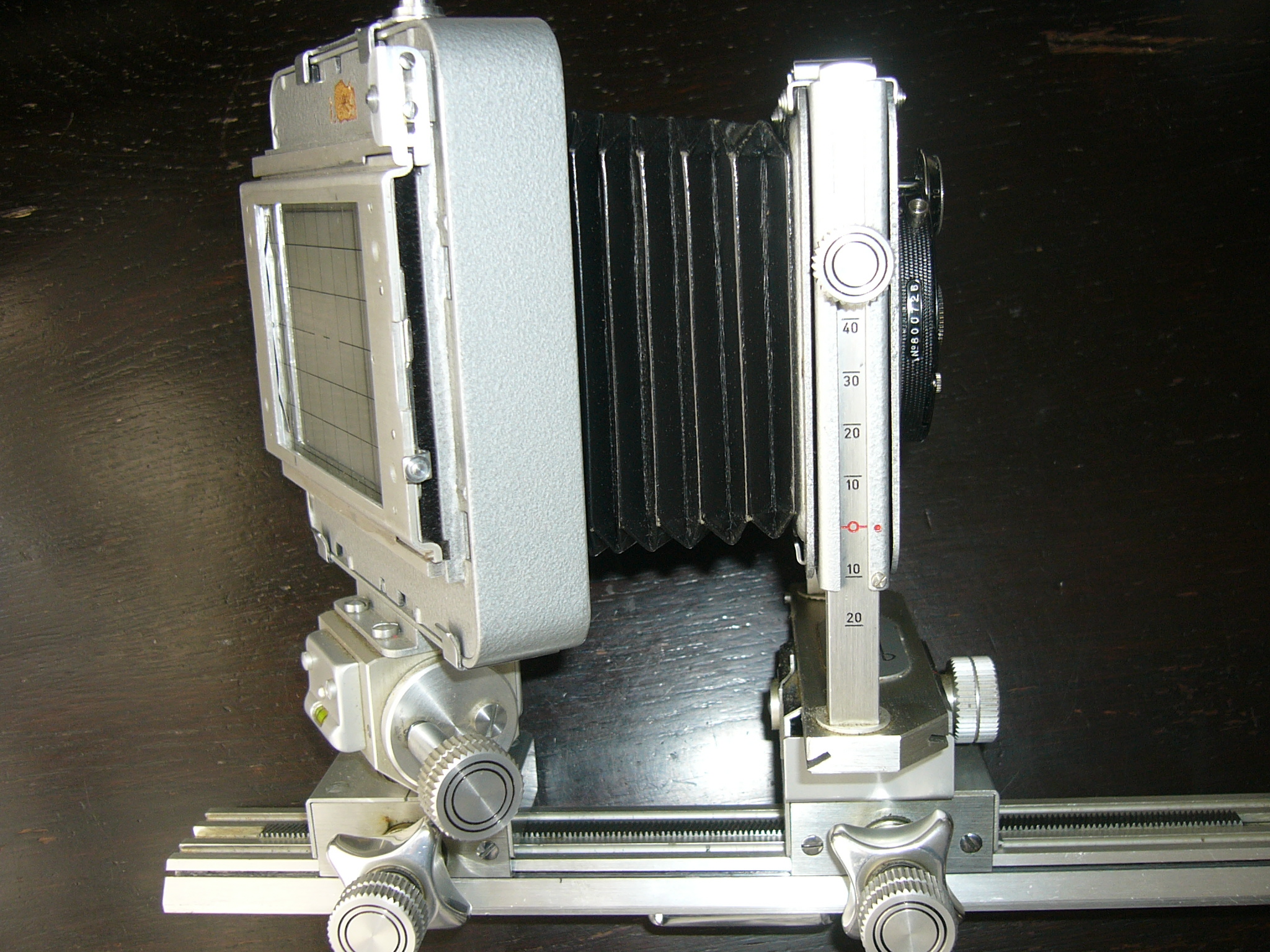

The Magnifying Hood is really interesting and I love it. It has a large rectangular diopter in the rear. to see the entire screen with high eyepoint. Nice border area around the glass so excellent. It has an original Makina screen inside, along with a fresnel arrangement that looks factory to me. It dosen't look to me like it's ever been adapted. The strange metal cutout at the back perfectly fits one side of your face only, allowing beautiful viewing even in full sun. Quite clever device actually. And of course you can just leave it parked in the center, but that's not the point of this.
The strange front of the Magnifier (that attaches to the rear standard) pivots and swivels about 45 degrees left and right. Why would it do this?? Because it allows you to BRIGHTLY view the left side (or top) of the screen, then swivel over, and BRIGHTLY view the right side (or bottom) of the screen. Bright and crisp enough to focus every lens I have tested so far. Really cool and -useful-. It really does the job. View one side and then the other. No need for a loupe with this.

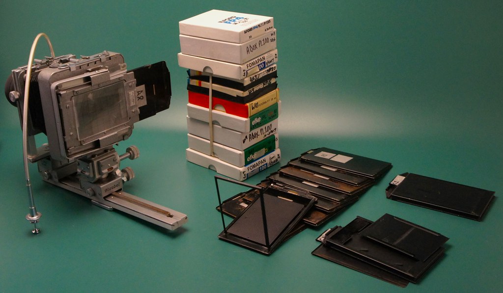

Here's Peco Jr with PJ1/325 Adapter with spring-loaded ground-glass screen, 6.5x9cm, for universal darkslide 6.5x9cm with Normal Double Groove Has four heavy clamps that keep the film holders tight in the back. As you can see the Back came with Single Shot and Double Shot 6.5x9cm Double Rail Holders. In a bundle I am hoping it works together since it came to me as a bundle. And also you can see I have a lot of 6.5x9cm sheet film in many flavours ready to load into these holders. The camera is now fully light trapped which has taken a while to get it right but now it is done and ready to test. I did try a quick roll of 120 in the Makina Roll Film 6x9cm Back and this thing is a blast to use.
