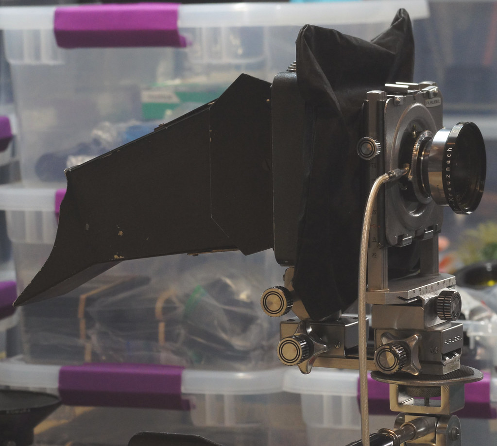

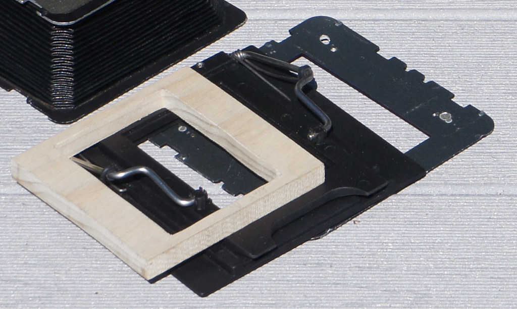

How I modded my Galvin Back to fit the Peco Junior:
I cut a piece of Alder wood to size in my workshop, took a while to get it all just right. Painted it black, then used brass wood screws to attach it to one of my Makiflex Rear Plates. It allows horizontal and vertical attachment. This does increase the overall extension a bit, so it won't work with widest lenses. Works great with Normal and Tele lenses.
Here are the pieces I put together:

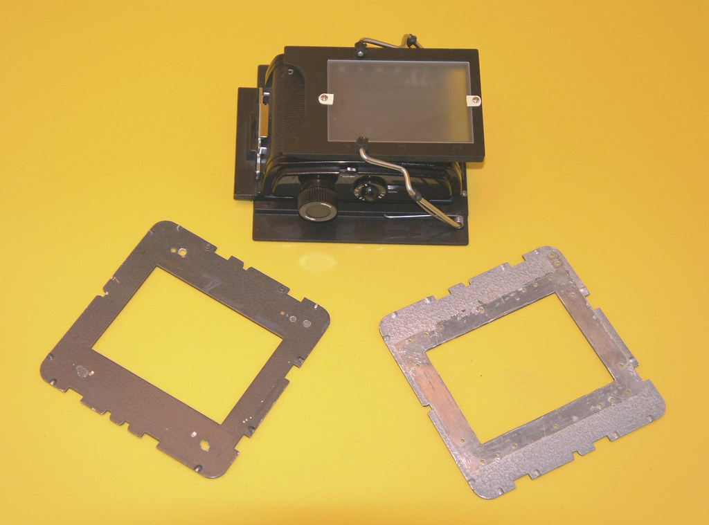

Jim Galvin 2x3 Back bought from Glenn Evans, who bought up his entire inventory of these. Great with Graflex Wind Knobs (early) and Lever Wind (later) ones too. Even 220 I have around. In the lower left is a Profia hammered grey finish board for the back of the rear standard, fits the Junior. On the right lower is an earlier vintage Rear Board, so I can make two backs out of these if I decide to. Shown with inserted Graflex Wind Knob 6x6cm back inserted, what is really great is how greatly you can pull the wire bail back, just about anything Graflok 2x3 will fit. Attaching an older digital back on one of these is another possibility I am thinking about.

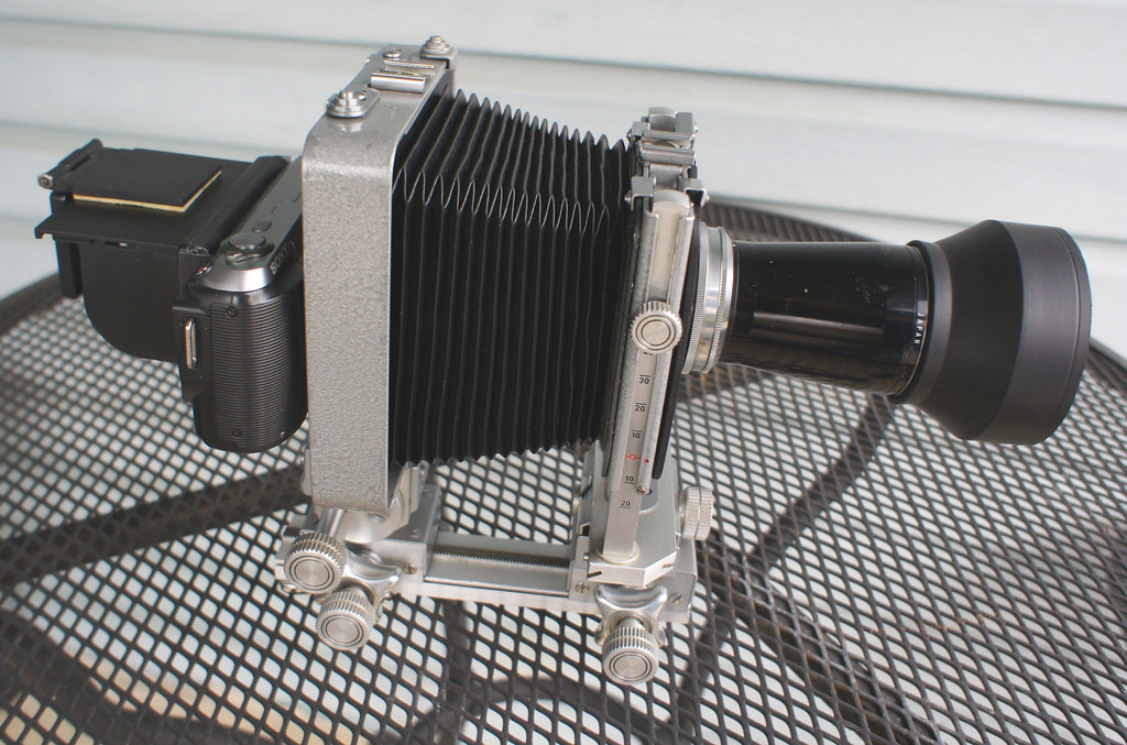

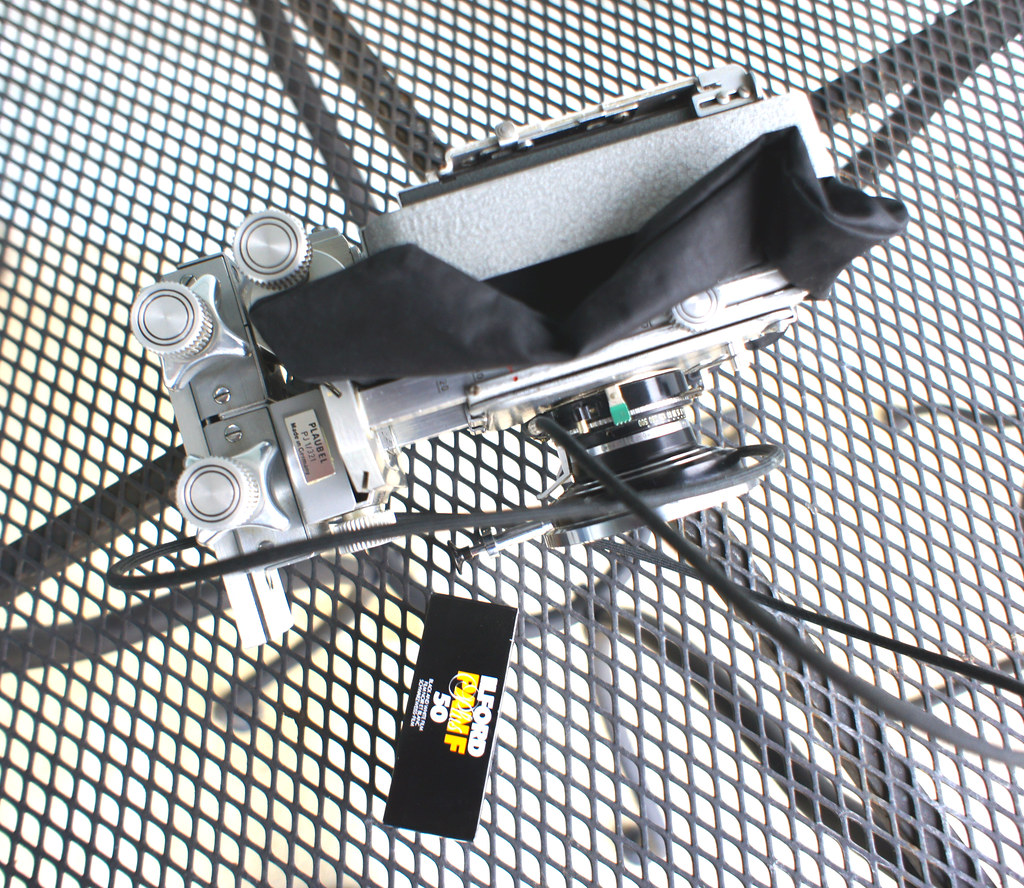

I took my second Peco Junior Rail (It has three attachment points) and precisely cut into two shorter rails, using my Lil' Machine Shop Band Saw. Finished with hand file and two new perfect, Small, and Medium length rails. Very very useful to me. See how teeny tiny the camera is now, with the shorty Sawed-Off Rail. Perfect for use with my 65mm F8 Super Angulon in Compur Shutter, and with Schneider Center Filter For 65mm F8. So Schneider-matched parts. This digiphoto was shot with my other Peco Junior, with a black Schneider Componon 100mm F5.6 Mint condition great standard focal length. Captured onto Sony Nec C3 JB Welded to a Plaubel 120x120mm lens board. Nice lens for this type of use, like the 1970's rendition no multicoating. This digital back for the Peco Junior is going to get a lot of use! :smile:
These same rails also interchange with my Plaubel Pecoflex Adapter.
SONY DSC by Nokton48, on Flickr
Peco Junior with sawed-Off Medium Sized Rail, 240 chrome barrel Schneider Tele-Arton, Sony NexC3 Digital Back. Lens Board is the 3D printed one from Italy; quality pretty good for the low price, well worth having. Camera focused at about forty feet with this lens; the sawed-off medium Rail is good with the 240mm tele focal length

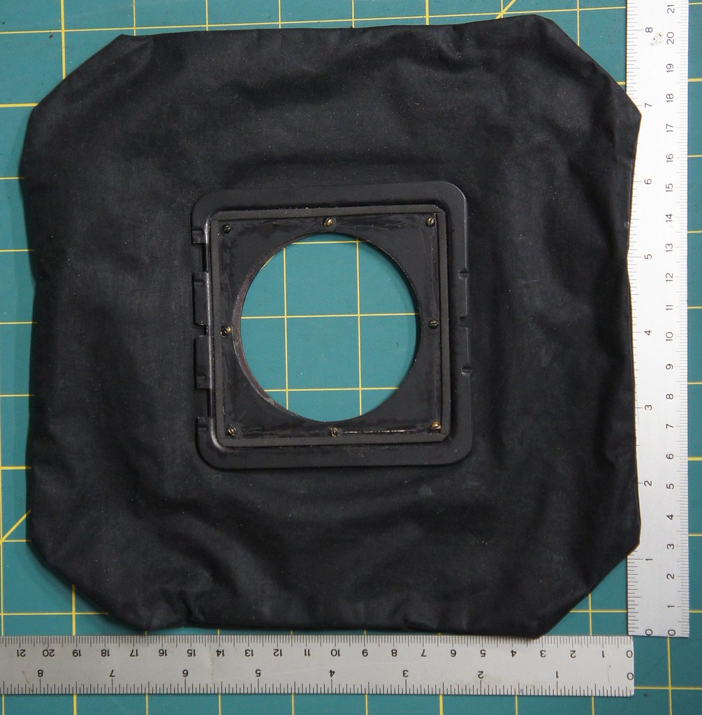

Baggie Bellows for Plaubel Peco Junior. I added the light trapping, I have a lot of trapping material of all types. Brass Hobby Modeling Screws hold it all together. The front is 95x95mm, and the back is 120x120. Same as their lensboards
Here's one more. The interior of the Rear Baggie Bellows Board. Washers are screwed on in the four corners, glued on as well.

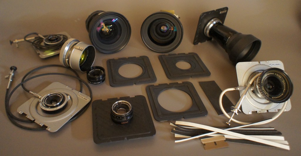

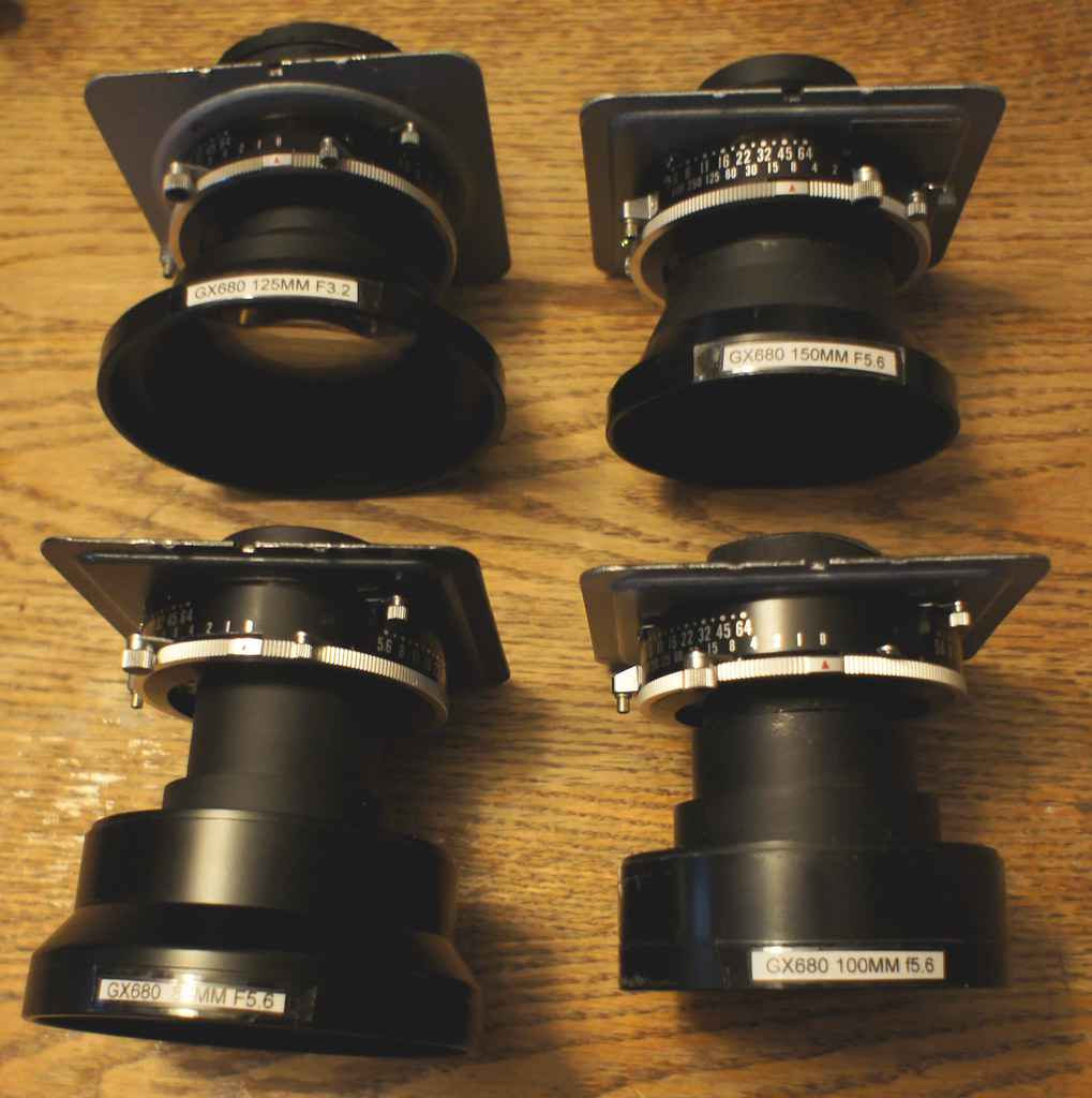

Onward with the Plaubel Peco Juniors. Center front, the 3D printed boards from Italy, flocked with strips of adhesive foam shown front right. Many lenses to try out with this. New sub-project: I have nearly all the Fuji GX680 lenses, I adapted them to Plaubel Makiflex, to use with focal plane shutters. Now I am adapting them again, mounting them Seiko Shutters from the WS Fuji view lenses. I buy shutters with bad glass, for the shutters, you see. And onto the Peco Juniors they will go.... Gx680 are modern, very hot glass, a good match to Peco Junior actually. Big image circles and nice to look through. This will be an ongoing project as I find what I need over time. Five more lenses will complete my Peco Jr GX680 set. Useful for film or digital
Yesterday I put these four lenses together, had been using them on Plaubel Makiflexes. Have four shutters from Fuji WS 210 and WS 270 lenses; these perfectly fit the GX680 front and rear cells.
Shown from left front: the 65mm F5.6 GX680, front right 100mm G5.6 GX680. Back left the 125mm F3.2 (hot glass!) and back right, the 125mm F5.6. These lenses are heavy, metal Peco Jr boards are solid and they balance well on my two Peco Junior cameras. These lenses are 90's modern uber sharp, and have big image circles, a perfect choice to go on these 6x9cm view cameras. I still have five more GX680 lenses to convert to Peco Junior, I need some more metal PJ lens boards, and some more Seiko shutters. I do like the olde glass from the 60's, but it is great to have modern glass as a choice. This project will continue as I find what I need to finish it.
