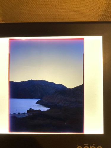

First trial photo I developed turned out OK, then I tried using the same chemicals the next day and this happened. Look at the discoloration and weird shapes:
Another photo had similar issues, but far less extreme (mostly discolored along the edges).
Any idea what's going on here? Am I not stirring properly?

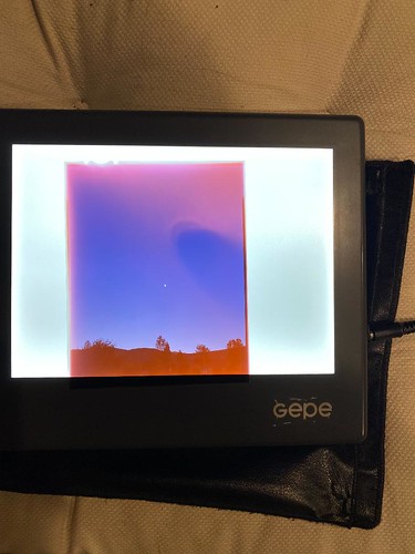

trondsi

Here's another trial photo from the same batch (chemical mixes were slightly more than one day old). Mostly acceptable, but the edges are discolored.
Sirius Glass
Jan 18, 2007
50,423
Southern California
Not addressing the color issues, there are light leak issues on the edges.
trondsi
Jun 29, 2015
454
I just realized something. This is from an old pack of Provia that I had to transfer in a haste because it got soaked in water (freezer ice melted). I guess this could explain part of it at least. The other half of the pack was still sealed though so I’m guessing that part should still be fine
Sirius Glass
Jan 18, 2007
50,423
Southern California
That explains a lot. Thank you for your feedback.
