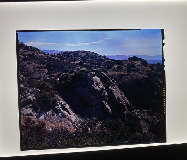

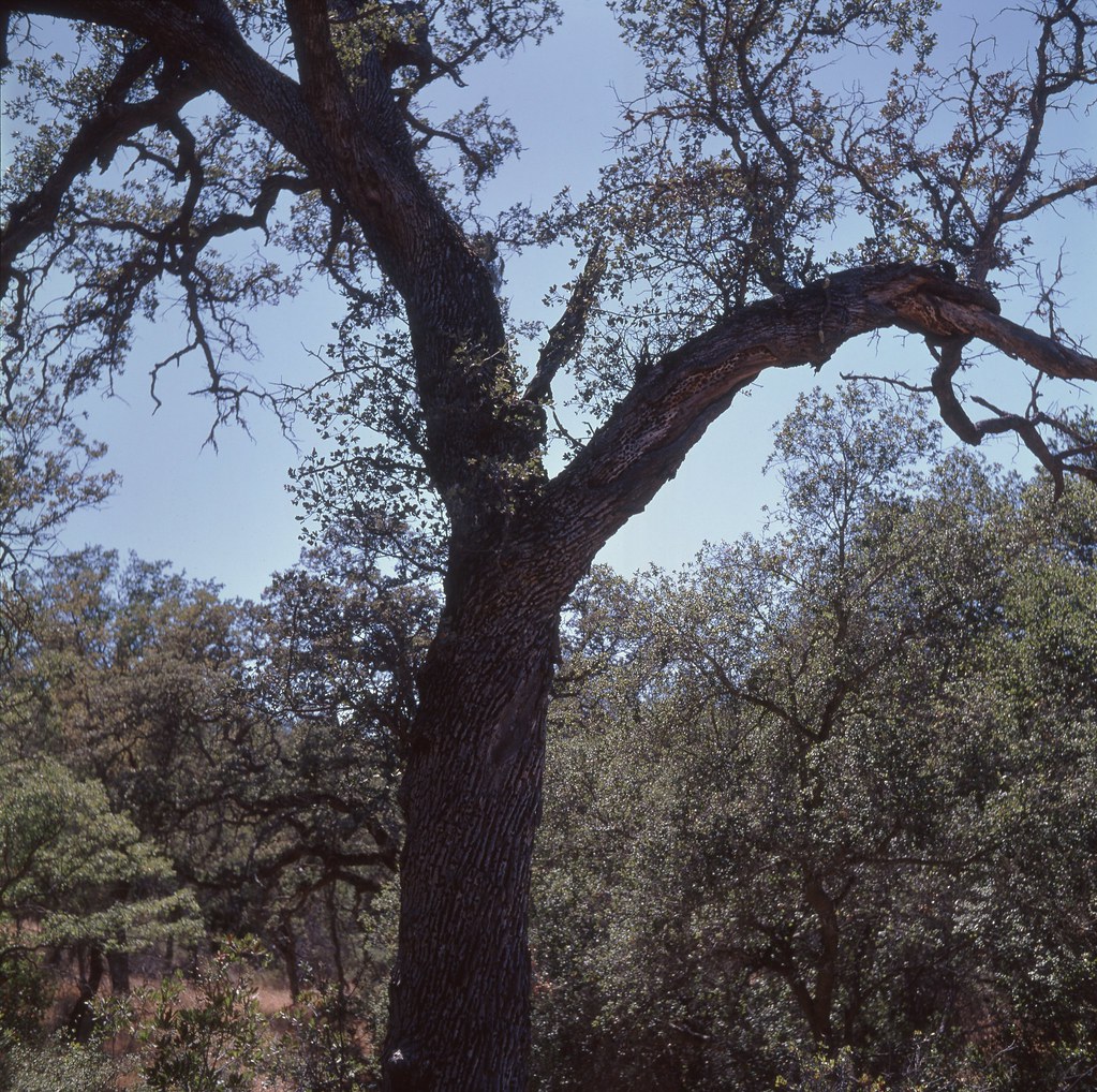

As an update, I thought I should share that I am developing slide film quite successfully now.
I am also getting more economical: Over the last three days, I used half the fluid in the small Tetanal E6 pack (the one that makes 1L working fluid), and developed 8 sheets of 4x5 and one roll of 120 film. Never having developed roll film, and after having used the fluid twice already I was skeptical about how the 120 roll would turn out, but I think it's fine apart from the last image being creased in my spiral. The SP-445 tank was used for the large format sheets. They way I did the one 120 roll was by filling my Paterson tank half way with the same fluid. Here's a sample:

Hmm, something went wrong here, as the sky is looking weirdly cloudy. Too little stirring of the tank?
Probably. I understand the Stearman is kind of prone to agitation issues as it is. Also, I wouldn't hold much trust in manual agitation for color processes. Not saying it can't work, but it's flirting with the kind of problems shown here. Your 120 format frame also seems to suffer from it although it's less apparent due to the subject matter.

Ok thanks! Yes, the Stearman has relatively little room for moving fluid. I moved it less this time because of some leaks and a sheet apparently shifting previously. I will change how I handle it.

Did another 4 sheets. I used slightly less fluid (to create more room inside the tank) and more rigorous agitation (last time I could barely hear the fluids moving in the tank, this time I could). It worked well this time, so thanks for the feedback folks!
