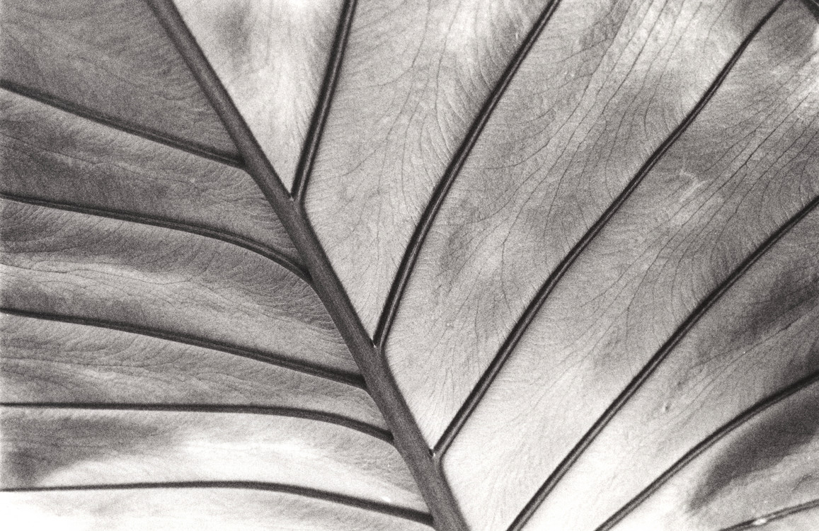

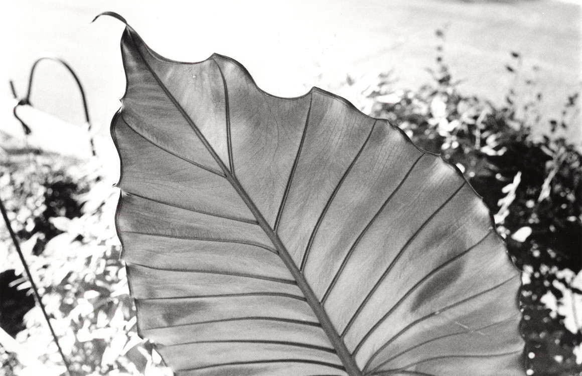

Here are a couple images shot handheld with a Nikon F3 and a 35mm Ai-S f/1.4. I was experimenting with what Double-X would do in a small format with respect to edge transitions and apparent grain. I have no doubt that a mirror lockup and tripod would have made these even sharper. Even so, note the nice edge transitions and how the midtone local contrast is held by means of highly dilute, low agitation (EMA) in Pyrocat-HD.
These are scans of my "workbook" silver prints. The only post scanning adjustments I make is to try to match the physical print as best as possible to overcome scanning artifacts. They're not final and could still bear futher refinement. But these are 8x10s I make as a record of work I may later want to make into wall hangings. These are printed pretty much edge-to-edge from the negative onto an 8x10 sheet:

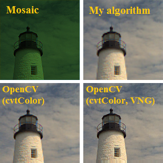

But here’s the thing: an entire *system* is designed to optimize high resolution (or whatever the requirement is), of which film or a digital sensor is only one “subsystem”. That is important to keep in mind. From an imaging system perspective, either imaging media can be used. A simple example of this is converting to sheet film to out-resolve a digital camera.
This is the data the demosaicing and all subsequent processing mechanisms has to work with. An ordered mess, low contrast with low colour information.
Especially interesting is the naive, super simple demosaicing in the upper right.
The demosaiced image is to big degree an invention.
You get a big delta if you compare an uncompromised image scanned with a synthetic simulated Bayer photo.
Edges and contrasty textured areas, are treated much differently than the rest of the image.
The very apparent moire is also present as harshness in a less obvious way in random textures. It’s baked into the data.
