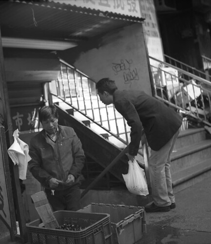

Beautiful film. Feels like there's never enough time in the year to shoot all the great b/w films out there. This was developed in DD-X.
