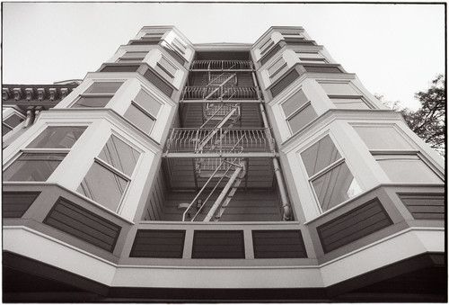

This was on 135, developed in Rodinal 1+50, Nikon F3+20/2.8.
Negs were moderately underdeveloped but contrast was easy to dial-in on the print (Agfa MCP+Dektol+Se):
Great film.
