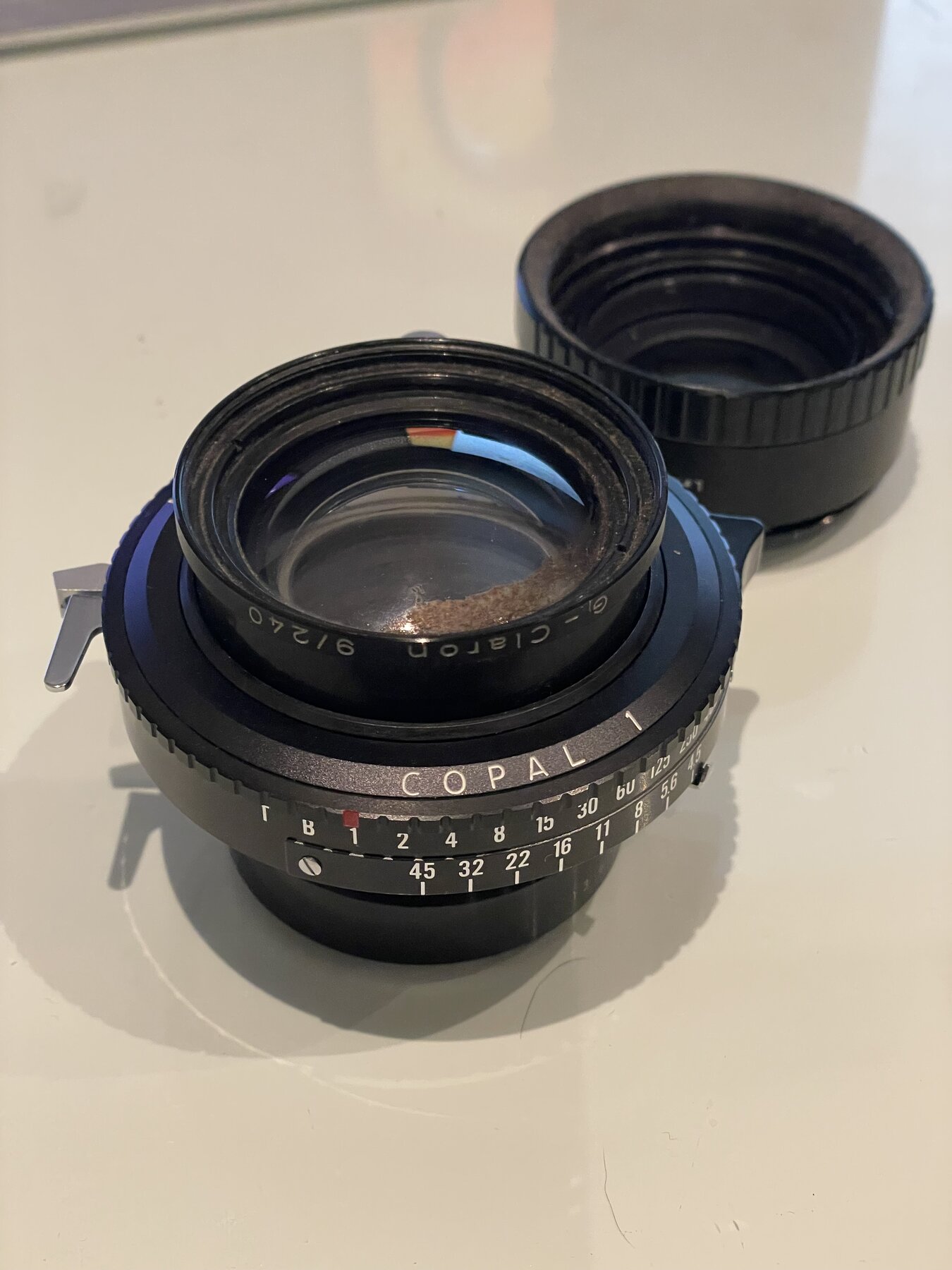

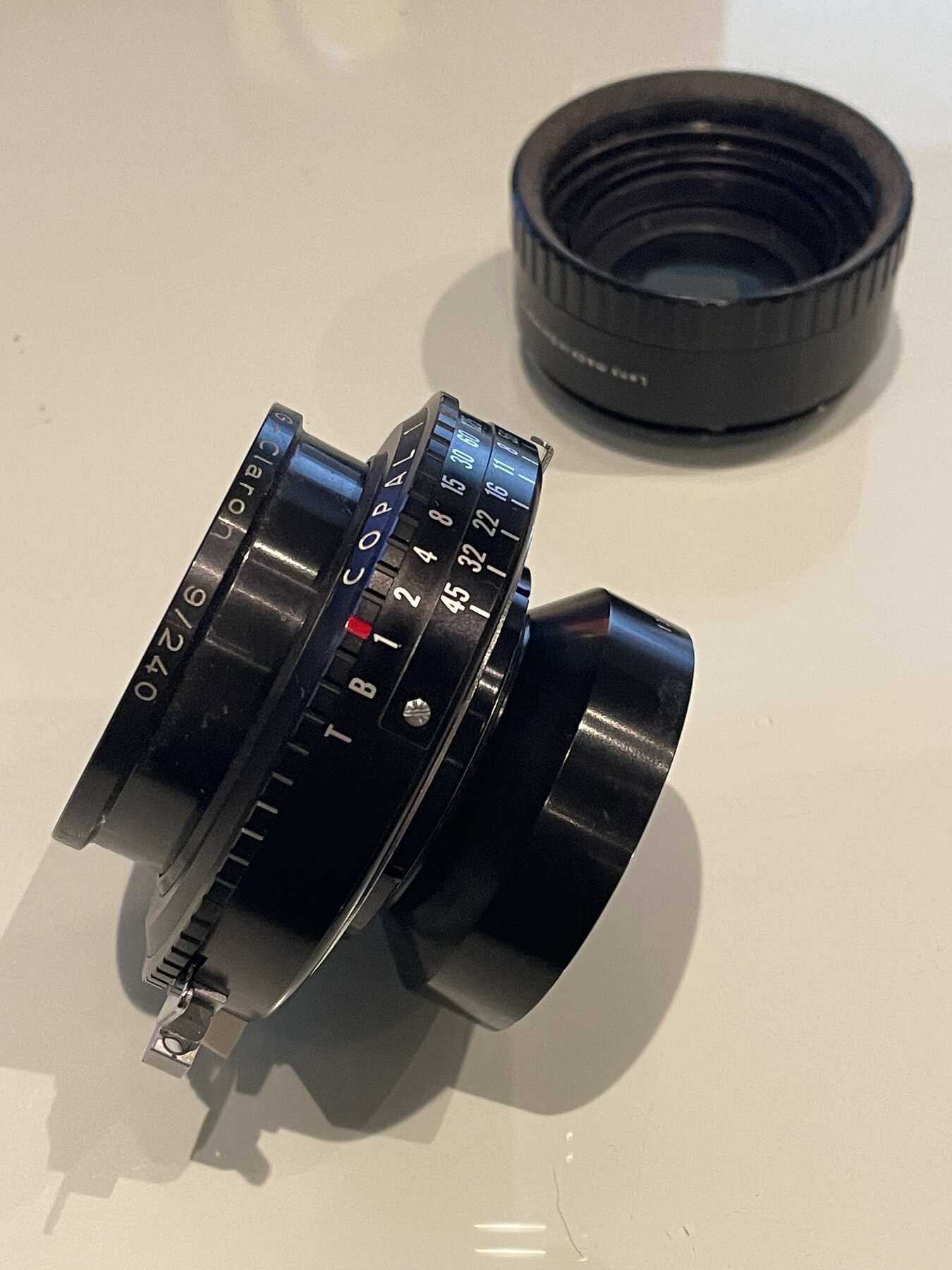

Isn't it supposed to be just the front and rear glass cells of the G-Claron lens that are removed from the lens and then screwed into the front and rear of the copal shutter respectively?
Not the whole G-open, and the aperture ring on the front of the G-Claron would be used.
Bingo! ?
Thanks Martie & Dan!
I didn’t realise that the front group just completely screws out of the housing. Now it fits the shutter correctly.
Housing length in shutter 53.44mm
Sorted!
Now just for the crud and a makeshift aperture scale.
