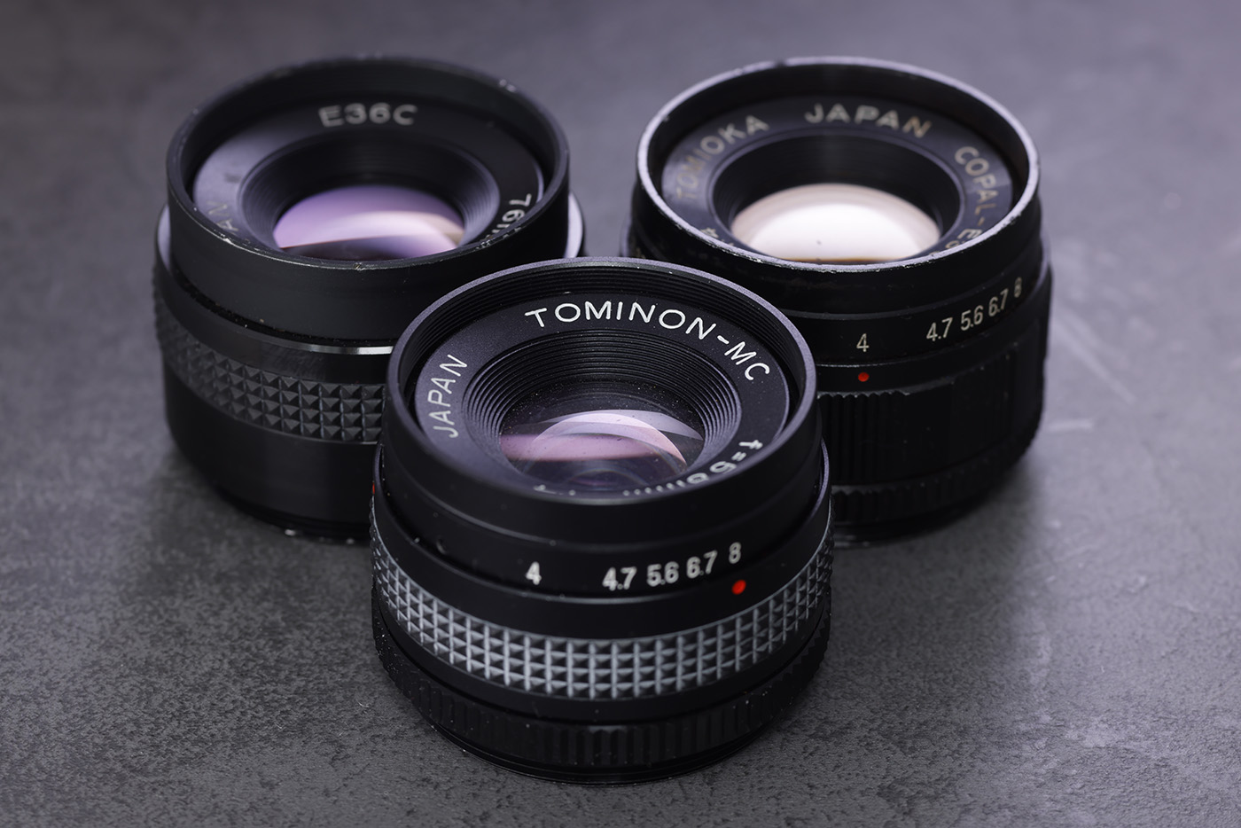

Thank you for the information! I'm not familiar with the Durst MiniPrinter but from the images I found online it looks like a very interesting device. Is it similar to a classic enlarger in its functions and which kind of lenses did you use in there? Regular enlarging lenses on lensboards - probably some of the Durst labeled ones?
I would assume it was a varifocal lens because we never changed lenses when switching from 35mm to medium format. As to what the lens was, exactly, I have no idea. I don't remember ever actually seeing the lens.

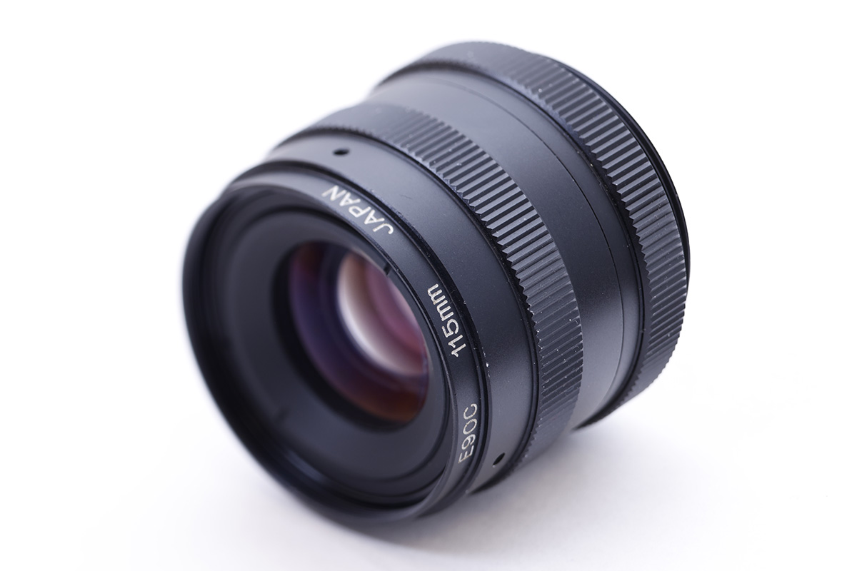

In case you're curious this is how the E90C lenses look like:
Because multiple sellers of such lenses have told me they were used in Agfa minilabs, I've always assumed the MSC might have been the one to incorporate these in addition to the varifocal ones. Some of them were labeled COPAL, others only E90C and JAPAN. They are fixed aperture lenses and have a common LTM/M39 mount.

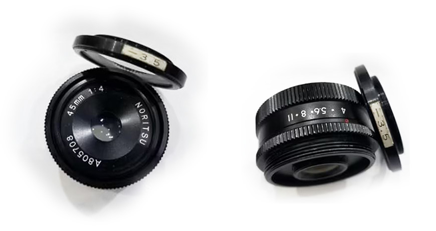

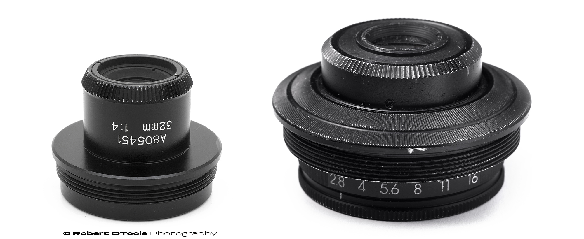

Thanks for sharing - I'm very interested in both Copal and Noritsu. Have you ever used (or seen) any of these lenses?
I know that the second one (varifocal lenses) were used in a range of Noritsu QSS machines, but I'm not quite sure about the rest, so any hint would be highly appreciated.

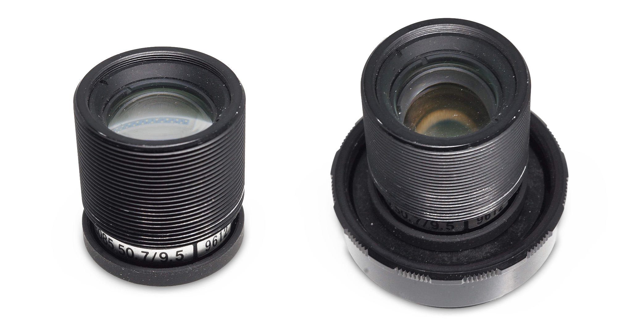

I'm a former lab guy myself, and you are correct in that the lenses are mostly hidden inside of the machines. High-production machines were typically designed to be used in normal room lighting. And since the lens can put light directly onto the photo paper it stands to reason that the lens assembly should be tucked out of the way of the normal room light. Meaning that printer operators are not generally gonna know exactly what the innards are.
The people who are most likely to know, I think, would be former service techs. And I think these are typically NOT the sort of enthusiasts found on forums like this. Even at that, these people may have not paid that much attention to the exact make/model of the lens(es) in use.
The tech's main job would be to clean, then check/set focus, perhaps fine-tune the focal length and alignment, etc. So they would know exactly how to do this with whatever lens is installed, but possibly they don't pay specific attention to the exact model of the lens.
Something that is not well-appreciated by regular photo people is how accurate the focal length must be in a machine printer. Typically both the paper guides and the negative stage are rigidly located. It's always possible to set focus in this situation, but... the exact amount of magnification is gonna depend largely on the exact focal length of the lens. Someone using an enlarger can adjust print size by tweaking enlarger height (and refocus) but with a machine printer this option doesn't exist. So the lens focal length has to be right on the money for whatever exact "size" you need. In post #32 you showed some images including what looks like some -3.5 diopter "corrective" lenses. This is about the only way to adjust a fixed fl lens. So if you wanted to make slight adjustments in magnification you can see how useful an adjustable lens would be.
Thanks for your valuable input on the matter - that sounds very plausible. For a while I was convinced that it was quite common to switch lenses in those minilabs and that this was the reason for sticking the lenses on a kind of lens board in the first place. But that doesn't seem to be the case at all. And if a bigger change was made, it was probably technicians - just as you stated - who were responsible for the swapping of lenses and fine adjustments.
You're spot on about the "accurate focal length" those lenses need. It's not common for regular taking or enlarging lenses to use 49.9 mm, 64.5 mm or 94.1 mm focal lengths... 😉
It's also true that diopters seem common on those lenses. Another thing that quite a number of them come with are aperture disks, limiting the max. aperture to a certain f-stop (probably the ideal one for the application). A lot of the time these can be removed though. And in a vast majority of cases the aperture range is limited in general (often to 3 stops) compared to regular enlarging lenses.
While it is true that many of the tech-people maintaining these types of machines might not be drawn to message boards like this one, I think time is also a factor... The whole scene was already diminished when the internet really started to become a thing.
On that Durst machine, I did swap lens assemblies when I switched formats. But I'm sure that those assemblies were kept calibrated by the technicians!

Thanks a lot! Didn't know a lot of that. Those "package printer" must have been quite expensive, given the lens prices I found... if you need multiple of those "lens decks" than that really adds up!
Given the precise focal length needed for something like this to work out well, I get it now that Noritsu and others started to go down the road of using varifocal lenses. At least the need for a 94.1 mm focal length lens then wouldn't mean that you have to develop an additional one, when you already have 93 mm one. (I know of some cases where lenses are really THAT close)
This is actually the first time I hear of "Nord package", "Lucht Engineering" or "Photo-Control" at all... (and believe me, even though it's just my personal interest in the matter that drives me in writing my little, I've wasted quite a bit of my free time to research on the topic.) But it looks like some minilab/printer companies - not named Noritsu or Fuji - mostly stayed within their origin country for the most part, which makes it even harder to find any hint.
Given that Photo-Control made their own lenses: How would you rate their quality, compared to the Rodenstocks? So much of that stuff seems to have been made in Japan, it's really interesting hearing about an US made lens.
