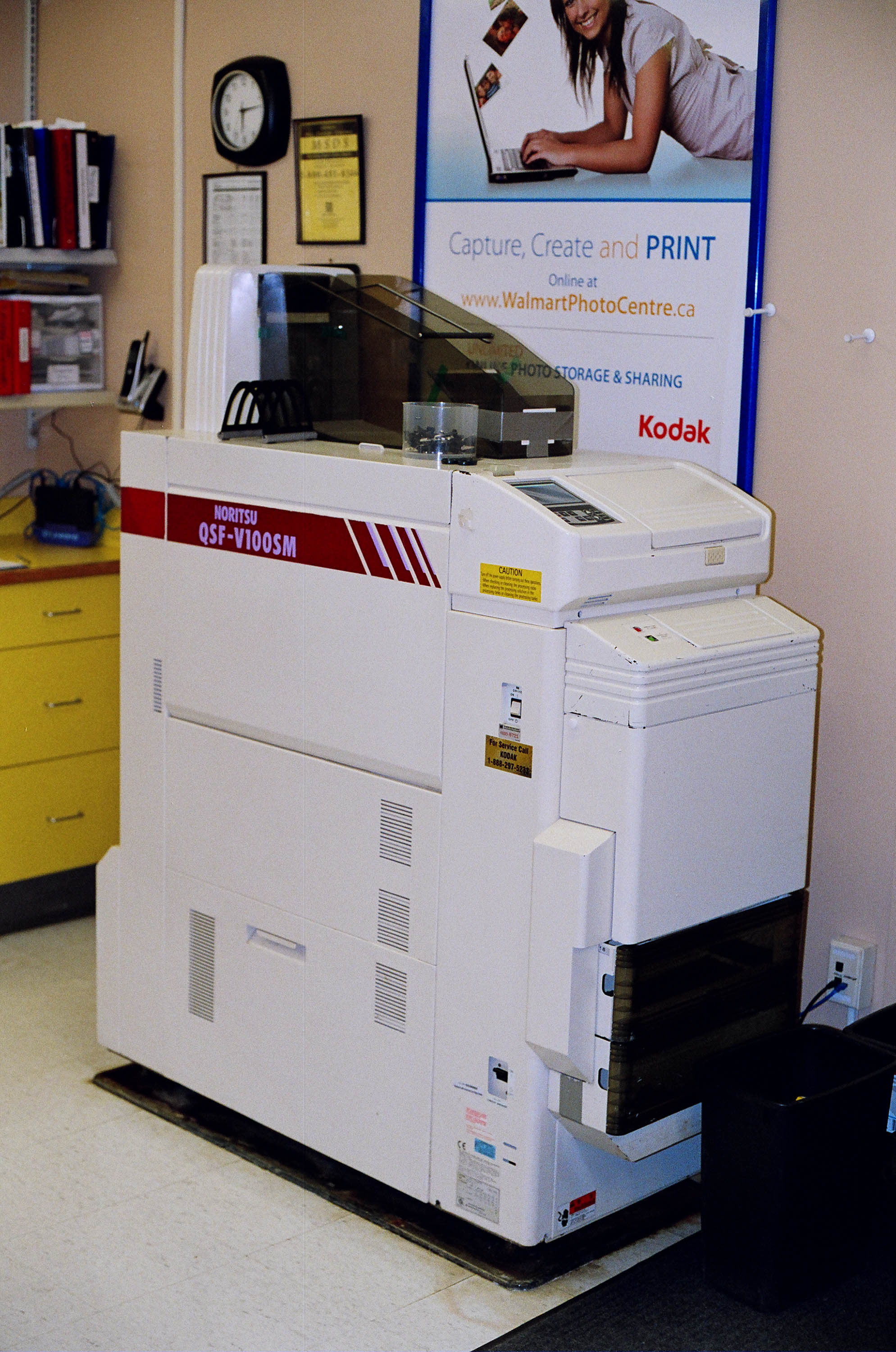

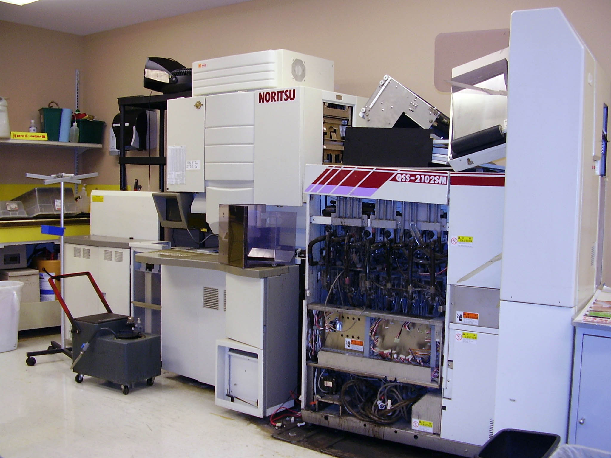

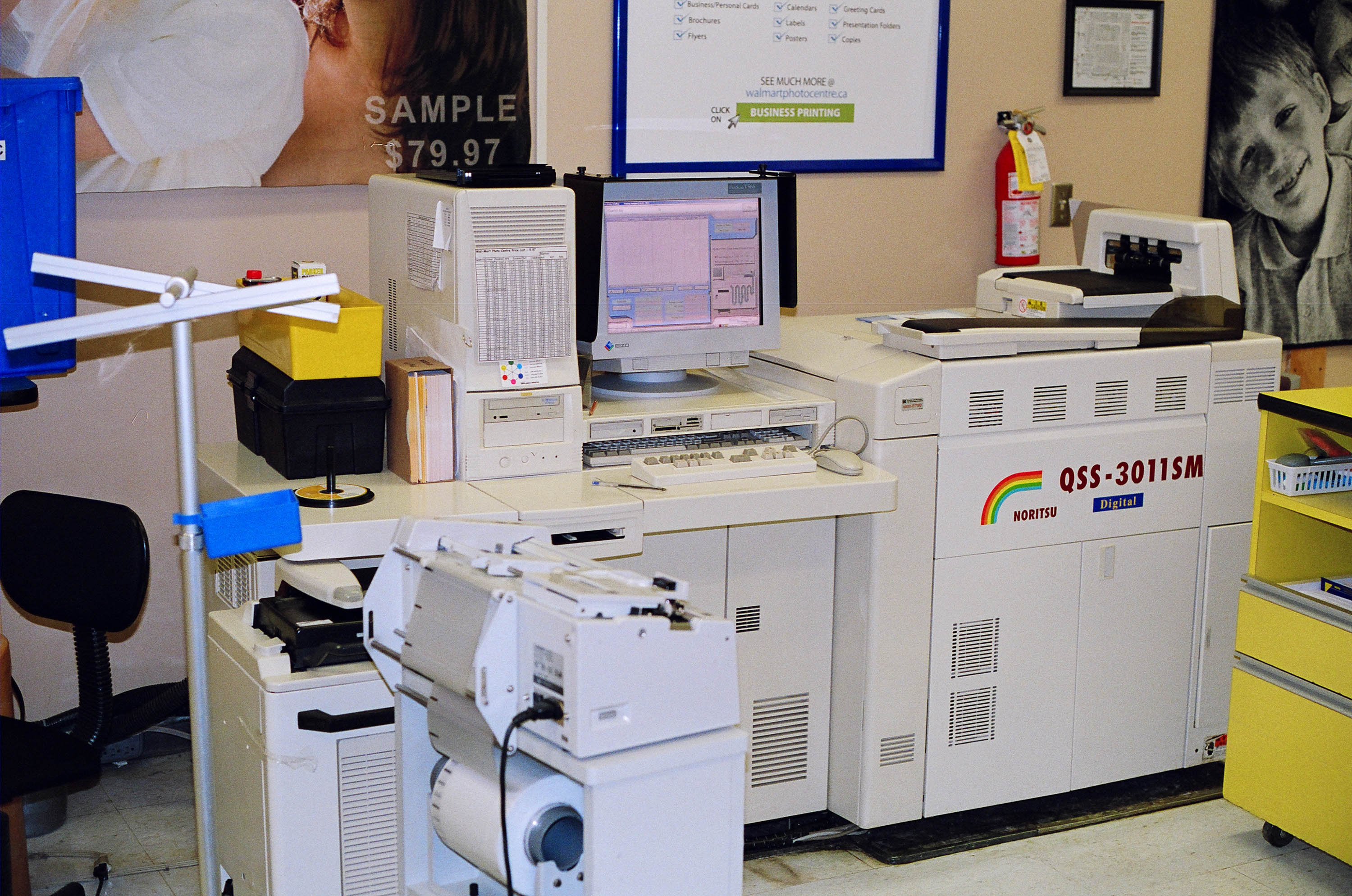

I worked in a department chain store 1 hour photolab for 18 years. I was right in the heyday of film to the transition to digital. I actually worked 19 years between 2 labs. I started in 1997 in one lab, and went to a new store lab in 1998. I stayed in that lab till 2016. Kodak and Noritsu were our suppliers/ machines in the second lab. The first lab used Agfa equipment. I was the guy who kept the machines maintained when chemicals needed replacing, etc. Also did lots of work with tech support on the phone to help with machine issues. I loved the job, but digital pretty much killed the photolab. It didn't stay open long enough for the resurgence of film again. We got rid of our C41 machine a year or two before I left. Went from using an analog chemical printer, to a digital chemical printer, to a strictly dry die sublimation printer. I saw it all, for a 1 hour type of lab. Even went to Noritsu for training for a week, to come back and train the rest of the staff. I dont know how many times I had to call either Noritsu or Kodak for fixing the machines. When I couldnt do it, they came to the store to repair in lab. The fact people made less and less prints over time, pretty much killed the lab. It was getting staffed less and less the last few years open, to the point no one worked in the lab and others from Electronics had to come over and help. They finally shut the lab down completely and removed most of the machinery just last year. I do miss working in a Noritsu lab. I often scanned my own films on their professional scanner, which was so much easier than having to do it at home today with what lousy scanners we have today. I got really good at color correction. I was the techie guy in the lab, so I did all the stuff the others didn't want to touch. If a memory card had its photos deleted, I was the one to recover the data off of it. I would have stayed in the lab if they didnt cut my hours to bare minimum the last couple years there. I wish I could open my own lab today, but the cost to do so isn't feasible today. Its too risky. Lots of old chemical printers for sale for cheap. Id put one in my garage if I owned the place I live in. Its all a dream now, and there is no local lab I could work at that gives full time. Only option here now is London Drugs and they only give part time. Good if you were retired though.
Thank you so much for sharing that and also the on-the-scene photos - very interesting! Seems like you really got a lot of experience with quite a number of different machines and also had some real knowledge on their inner workings. I'm not sure if you've looked through the thread, but just to summarize in case you didn't have the time:

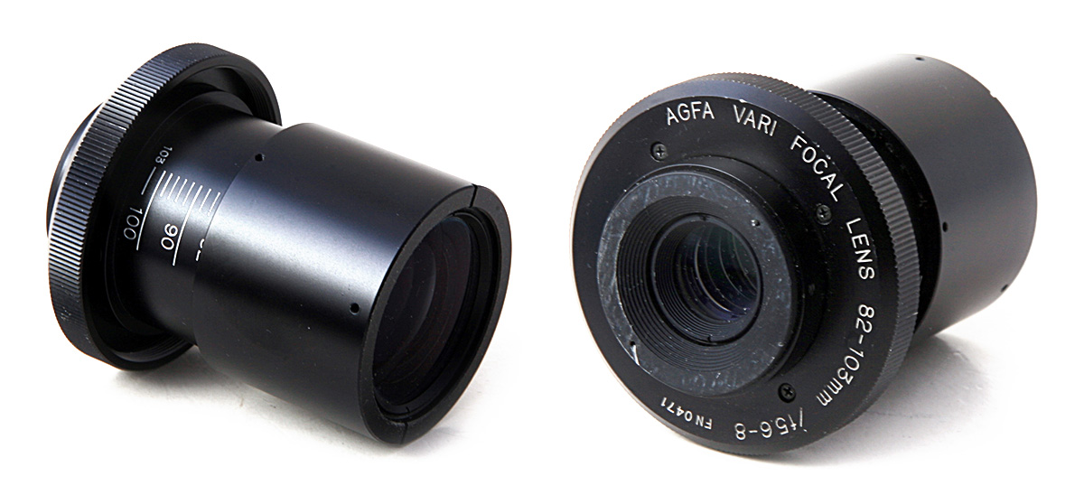

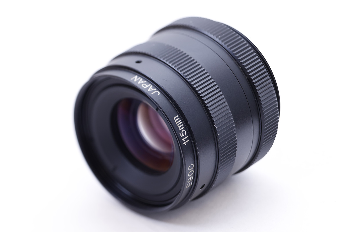

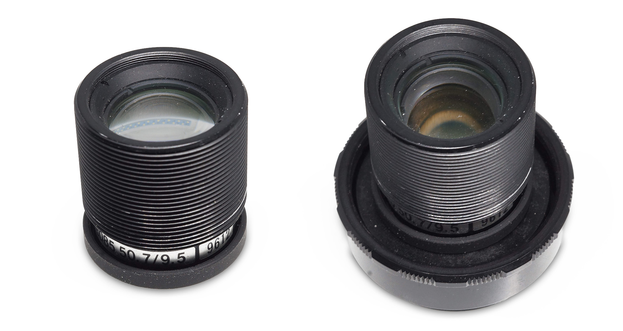

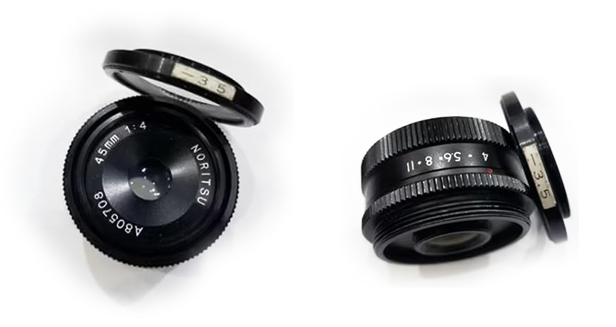

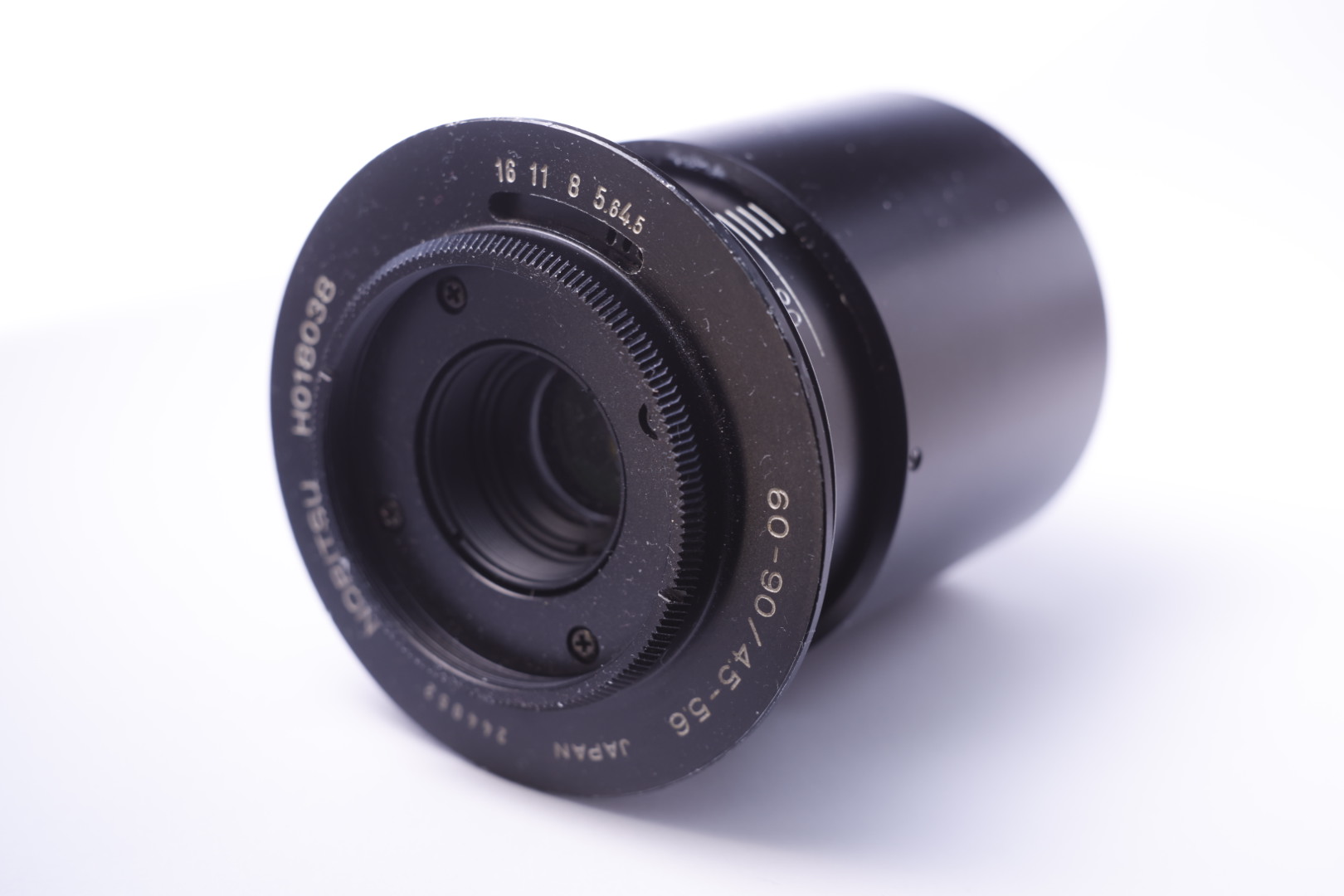

I'm personally very interested in the lenses which were used in those machines, because I'm writing a small article on Noritsu (and have already written an article on Agfa, where I've only touched on the subject of minilabs so far, but have plans to expand it in the future). So if you have any additional information (on the possible manufacturers, constructions, properties...) of one of the lenses below, that would really be an immense help.
Thanks a lot! I think you're right - that's exactly how (surprisingly similar looking) varifocal lenses were used in Noritsu QSS machines as well. I initially thought there must have been some mechanism in those machines to change their focal length, but all the samples I've seen so far were actually used at a certain focal length fixed with some screws - so it looks like many of those minilabs probably made use of a couple of those varifocal lenses adjusted to the print sizes, just like you described. If that's true it's even more surprising that they seem so hard to find... I'm afraid most of those machines have landed in the garbage bin when they stopped working and the lenses with them.

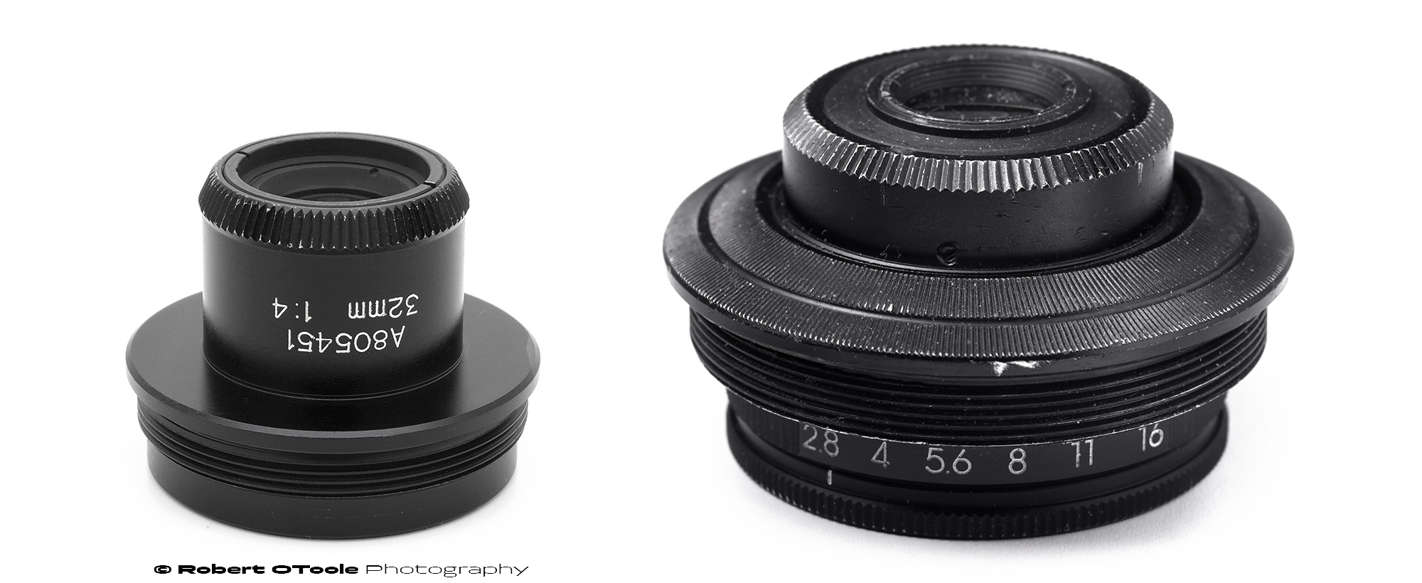

What I find the most interesting about the MSC2 lenses is that they seem very different to the MSC1 lenses. For the latter Agfa produced quite heavy and unique looking lenses:
Because multiple sellers of such lenses have told me they were used in Agfa minilabs, I've always assumed the MSC might have been the one to incorporate these in addition to the varifocal ones. Some of them were labeled COPAL, others only E90C and JAPAN. They are fixed aperture lenses and have a common LTM/M39 mount.
I know that the second one (varifocal lenses) were used in a range of Noritsu QSS machines, but I'm not quite sure about the rest, so any hint would be highly appreciated.

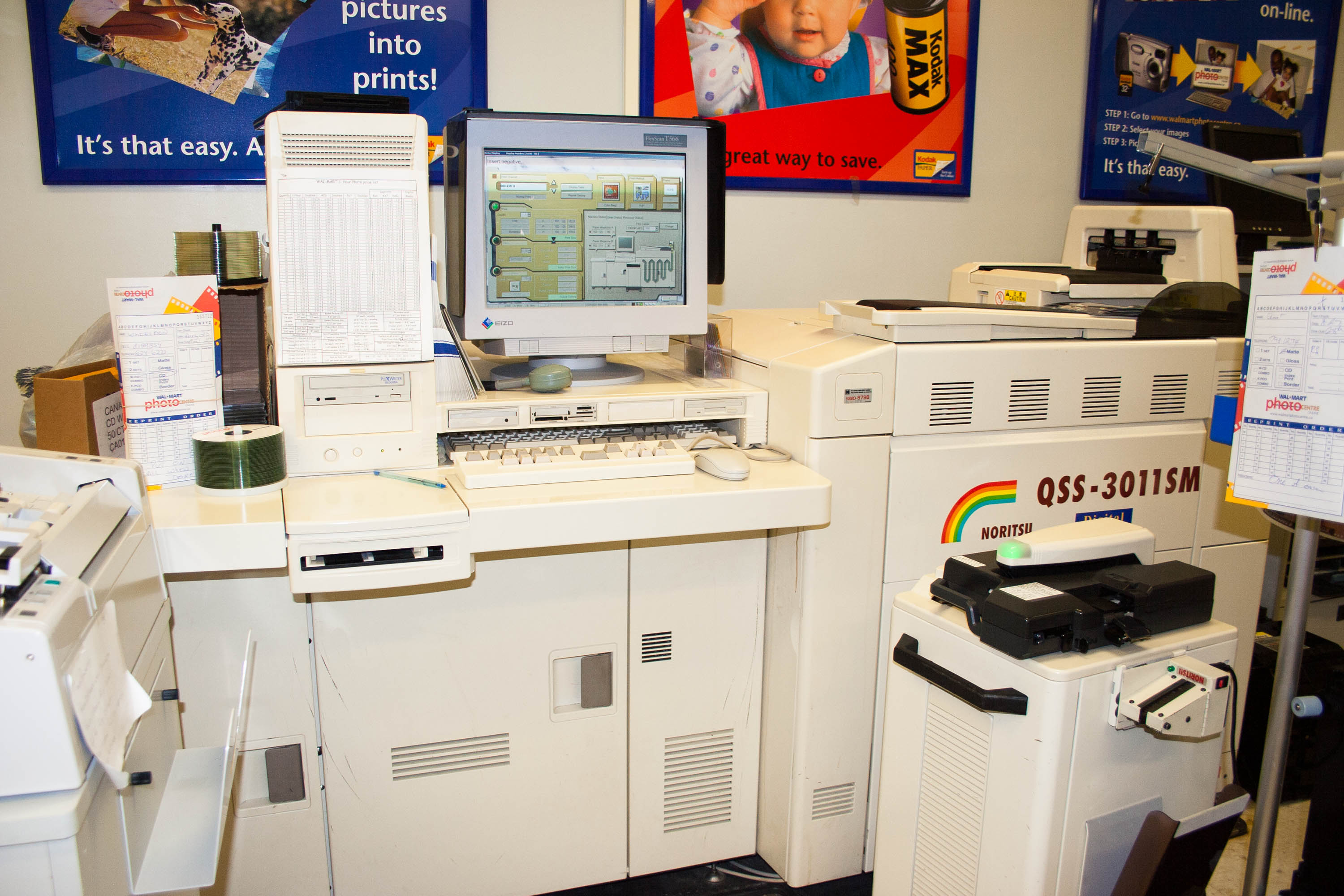

And if it's okay I would like to ask you one additional question about the QSS 3011 you've also worked with: was that a fully digital lab? And if so, did it still feature lenses for scanning? I know the above mentioned varifocal lenses were used from the QSS 8XX to at least QSS 2611, but I'm not sure about anything that came later. Thank you very much!
I have very little knowledge of the technical aspects of the lenses used in their specifics. The 2102 machine used a sliding zoom lens for 110 all the way up to 35mm. If you wanted to do 120 film, you had to plug in another lens by pushing the zoom lens out of the way. Thats as far as my knowledge goes on that. I cannot say how their construction was, in terms of type. We never got into that, as it wasn't relevant to doing the job. That info was more to the repair technician who worked on our machines at times. My knowledge is just based on using the machine and maintaining it.
As for the 3011 machine, its based off of the 3101, but is just more compact and only does smaller rolls of prints. The 3011 was a partially digital lab yes, but it still used chemicals to develop the prints. To make the prints, it used a laser assembly in the machine itself to output onto the chemical print. The laser assembly was prone to going once in a while, as we had to replace ours at least once. Very expensive part. This was long before dry prints came into being. We got the 3011 machine in around mid 2004. You could scan up APS, 35mm, and 120 film on the 3011. You just needed the correct film tray to plug into the outboard film scanner. Rez was limited to 3000x2000 on that scanner. And it was painfully slow to scan at that rez. The newer Noritsu scanners are way faster. As for the scanner itself, I believe it used some sort of lens in it yes, but I never actually got a good look at it. The outboard scanner (the r2d2 looking unit next to the printer itself) used a plug in light, and works similar to most other film scanners that consumers would use. Nothing fancy here. It was a very good scanner though. Best scans I ever got were off that machine. There was a slit of glass in the scanner itself that the film would shine through to get the image. Dust on the glass was an issue. You could easily ruin entire scans if you didn't deal with dust on that glass. The machine did use Digital ICE for the film itself, but the glass became an issue on ocassion.

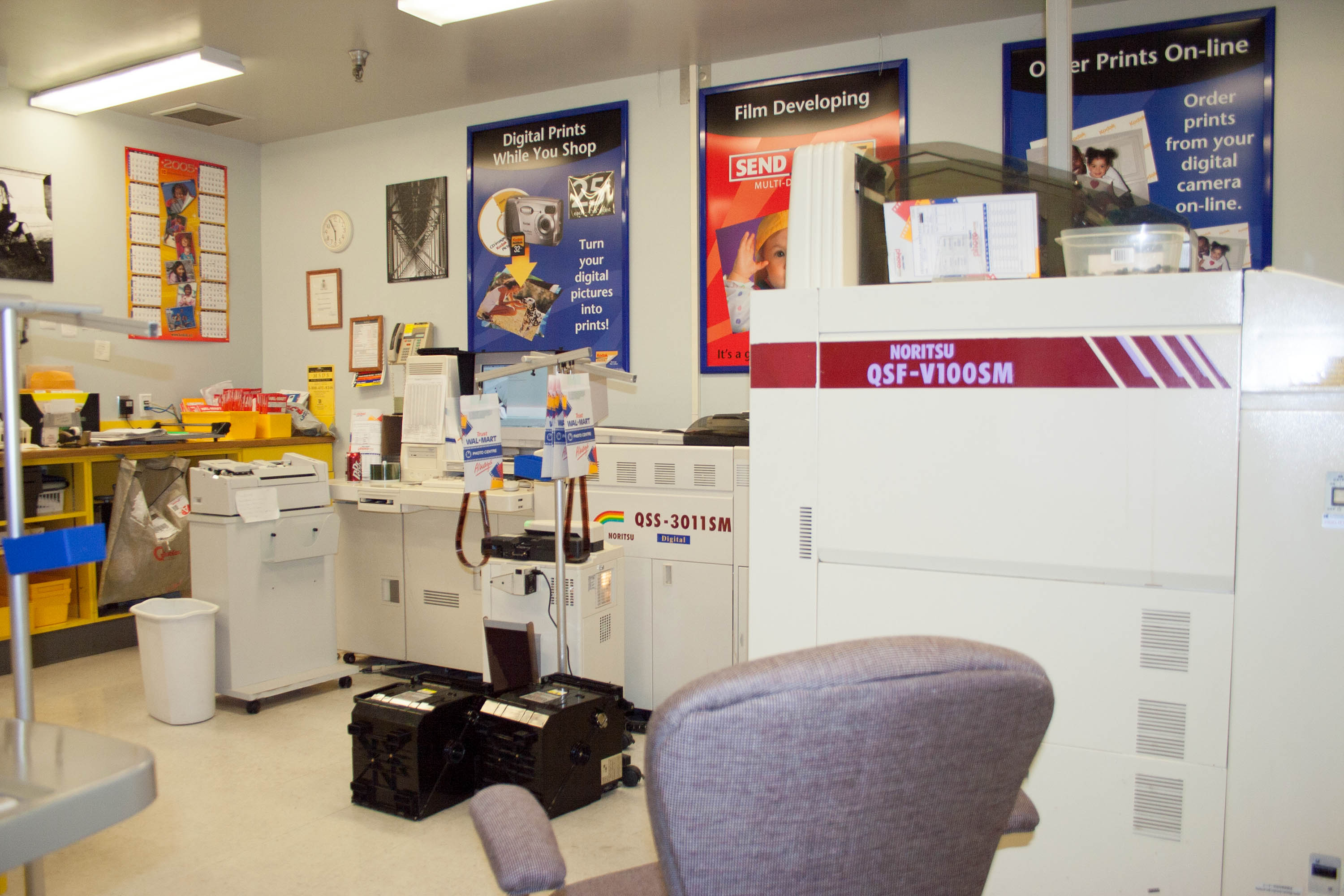

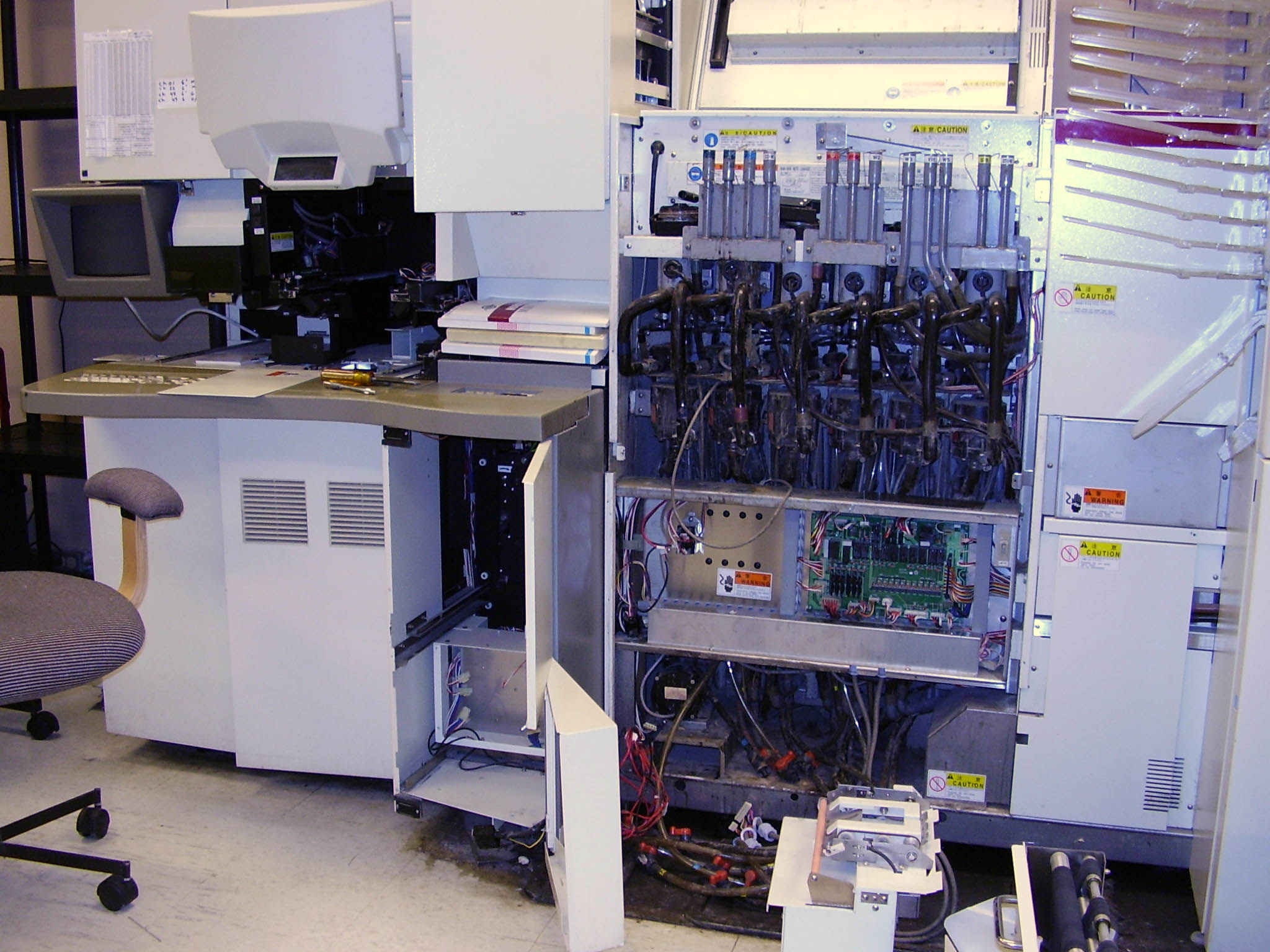

Here are a few more pictures of my lab time. The 3011 machine moved around once, depending if we still had the 2102 or not. Same with the V100 film processor.
Many thanks for your detailed response and the images - it's really fascinating to read about! Your statement about the 'repair technician, who might know more' was echoed by other people in this thread and elsewhere online a couple of times already... It's really unfortunate (for me at least, I doubt many people care 😉), because the likelihood of some of those repair people reading about this here and providing some answers seems to be almost zero.
I also have one of those zoom lenses (not sure it's similar to the one you used - there have been a number of them), but it's not of much use for anything than its original application unfortunately.
It was moved by two tiny motors originally and probably able to cover a large amount of formats with that magnification, but optically speaking it seems rather weak compared to the Noritsu-labeled varifocal & prime-lenses which preceded it, as well as the zoom-lenses used by competitors Agfa and Fuji in their minilabs. But that being said it's far from impossible that I'm not just unaware of the need for some additional device, (like a condensor etc)., which might be responsible for the lack of performance here.
@braxus Again thanks for posting the lab and equipment photos. It is a joy to see such well maintained machines and how tidy the lab is.
Even the drip trays under the machines are clean and empty, always a good sign.
