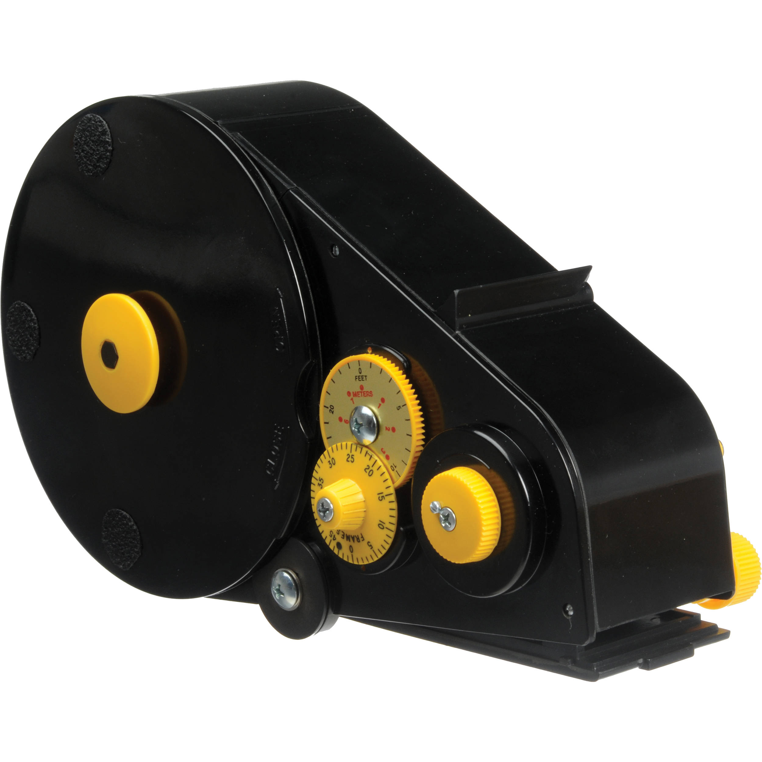

Of all this one I like most, maybe because of rounded corners and a match to my iPhone, not sure.
Kaiser Bulk Loader also sold under AP brand.

I have 3 in the same style as the Kaiser / AP bulk loaders - an LPL, a Konica/Minolta (newest) and a US made Telesar (my oldest and favourite from about 1980).
The LPL has a spring loaded gate lined with felt which I feel could lead to future scratching problems so this one will be sold soon.
The other two loaders have nothing that touches the film between the bulk spool and the 35mm cassette - except the lips on the cassette.
