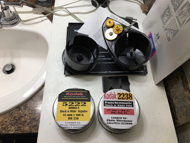

I’ve used the Alden and the Lloyd’s, and prefer the Alden for the click stops. I like bulk loading for the inexpensive access to unusual emulsions like Eastman Double-X and Kodak 2238.
