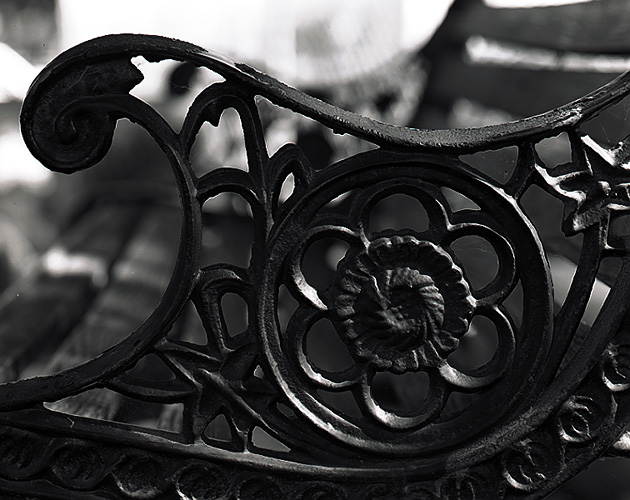

A-130 with Delta 100 4x5
Here is an example of using it as a film developer. Just a test neg shot in my back yard.
Delta 100 exposed at box speed. Developed in Ansco-130 (Photographer's Formulary version anyway) 1+4 for 4 minutes at constant agitation. About 68*F temp. This is a neg scan.
It seems to work very well, and holds wonderful shadow detail.
- Thomas
