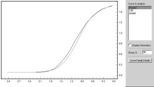

I did some comparison tests today of AZO in Ansco 130 1:1 and Amidol using Michael Smith''s Amidol formula.
Data as below.
1. Paper = AZO #2 (old #2)
2. Exposure = 4 seconds with 65 watt R40 lamp, at 33" from print frame. Test negative was a Stouffer TR 45 step wedge.
3. Develop for two minutes at 72º F. Amidol stright as per MS's formula, Ansco 130 1:1, standard 130 formula.
4. Tone with Rapid Selenium 1:100 for three minutes.
5. Air dry.
6. Read densities and plot curves.
Conclusion. Results were virtually identical. Both developers gave the same exposure scale (ES) of 1.45, Dmax was identical at 1.99, and printing speed at two minutes of development was also virtually identical. The only significant difference was that Anso 130 1:1 has a slightly shorter toe, which results in a curve that is slightly more straight line than the curve of Amidol. Howver, if compared to the typical curves of silver papers other than AZO, the curves of AZO in both Amidol and Ansco 130 1:1 are much more straight line.
After evaluating the tests I made two real prints from a digital negative, exposing both for the same time. I developed one in Amidol, the other in 130. The prints are now dry and they appear to my eyes to be identical. For all practical purposes they are so similar that I can not tell them apart from visual inspection, even when observing them side by side in the same light.
I am attaching three images. The first shows both curves plotted together, the second is the Ansco 130 1:1 curve, the third is Amidol straight.
All of these prints were developed with constant agitation and timed to the second. No water bath was used, either for the test prints or for the *real life* prints.

Thanks---that's an interesting test. It would be interesting to see if Azo responds to water bath processing in 130 the way it does in amidol.
Sandy, your results are similar - but not identical to mine. I notice (your Azo Forum post) that you developed for 2 minutes in both developers.
I developed for 1 minute (- 0, +5 sec) in MS amidol at 21C, followed by the MS recommended (strong) acetic acid stop bath & fix.
I diluted the Ansco 130 stock 1:1 with water and developed for 2.5 minutes (- 0, +5 sec) at 21C, followed by a standard strength acetic acid stop bath & fix.
I did not tone the prints - I wanted to compare image tone/color after dry down. I can always tone them later - if I wish.
David, Morris Germain states that contrast can be controlled with Ansco 130 by dilution of the stock solution.
Morris Germain recommends a 1:1 dilution for normal contrast; undiluted for high contrast; 2:1 for low contrast. I expect that use of a water bath would also lower contrast.
Recall that Ansel Adams left out the Hydroquinone, which yielded a soft working version of Ansco 130 with lower contrast and delicate fine detail rendering characteristics. He would then add Hydroquinone - if needed - to increase contrast.

BTW, when doing the AZO Amidol vs 130 tests yesterday I also tested both Amidol and 130 to see if dilution affects contrast. The answer is basicaly no for both developers. There was virtually no differnce in contrast between AZO when developed in both Amidol and 130 straight, diluted 1:1 and diluted 1:2.
Different dilutions do result in curves that are slighly different in terms of both toe and shoulder, however. The most straight line cuve with 130 was obtained with the 1:1 dilution, whereas the most straight line curve with Amidol was obtained with the 1:2 dilution.
I later tested 130 with water bath development, with the following scenario: a) 2.0 minutes in developer, 1.0 minutes in water bath, b) 1.5 minutes in developer, 1.5 minutes in water bath, and c) 1.0 minutes in developer, 2.0 minutes in water bath. The water bath resulted in a change of speed but no change at all in exposure scale, which was 1.45 for all three situations described above.
Sandy
