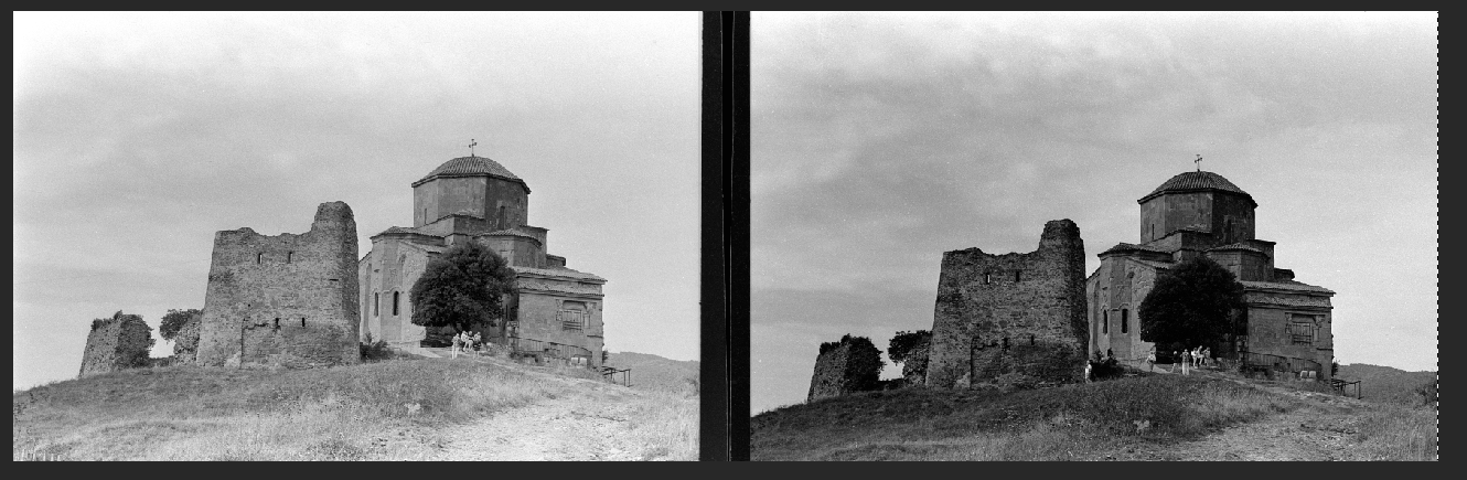

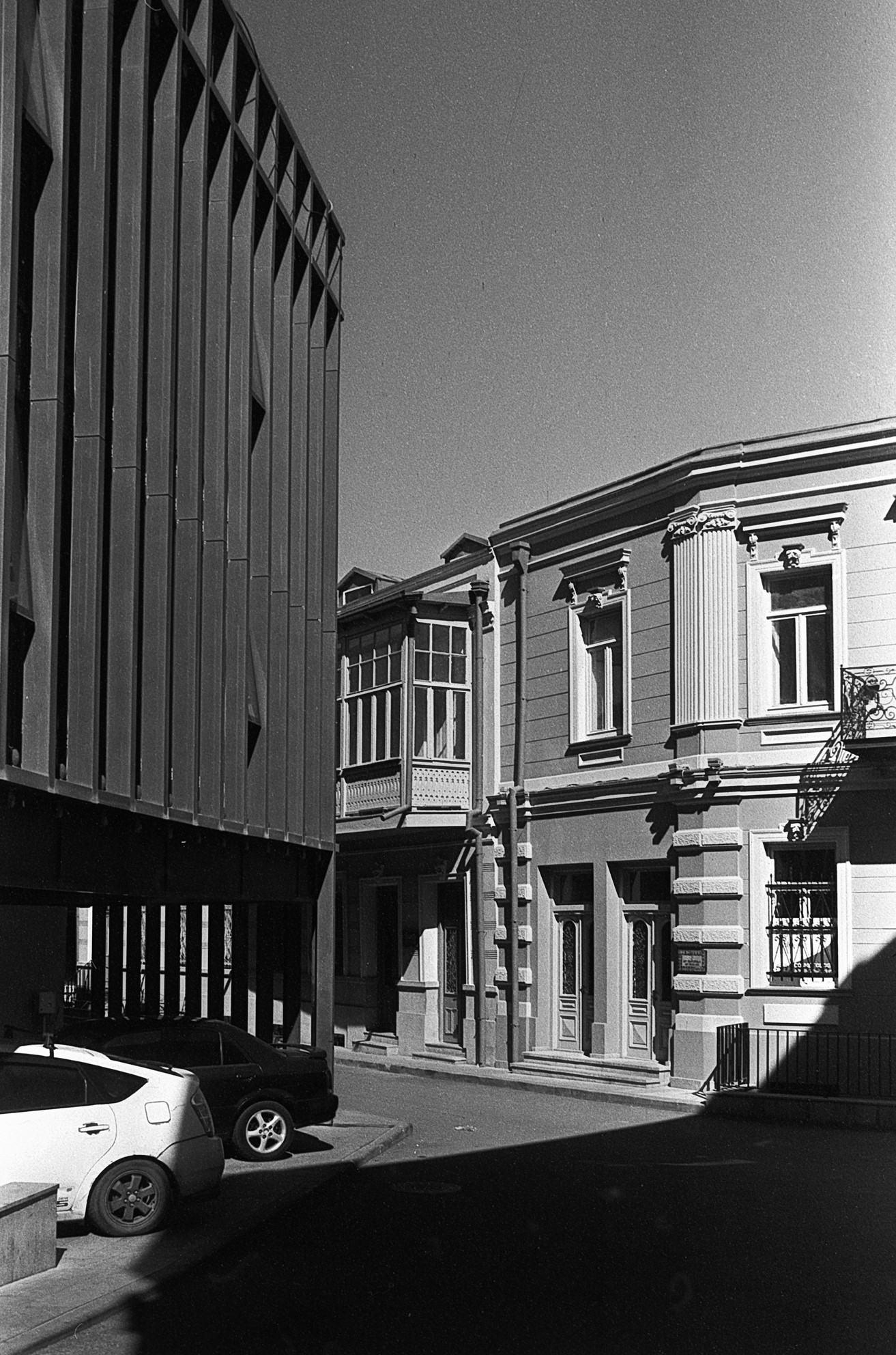

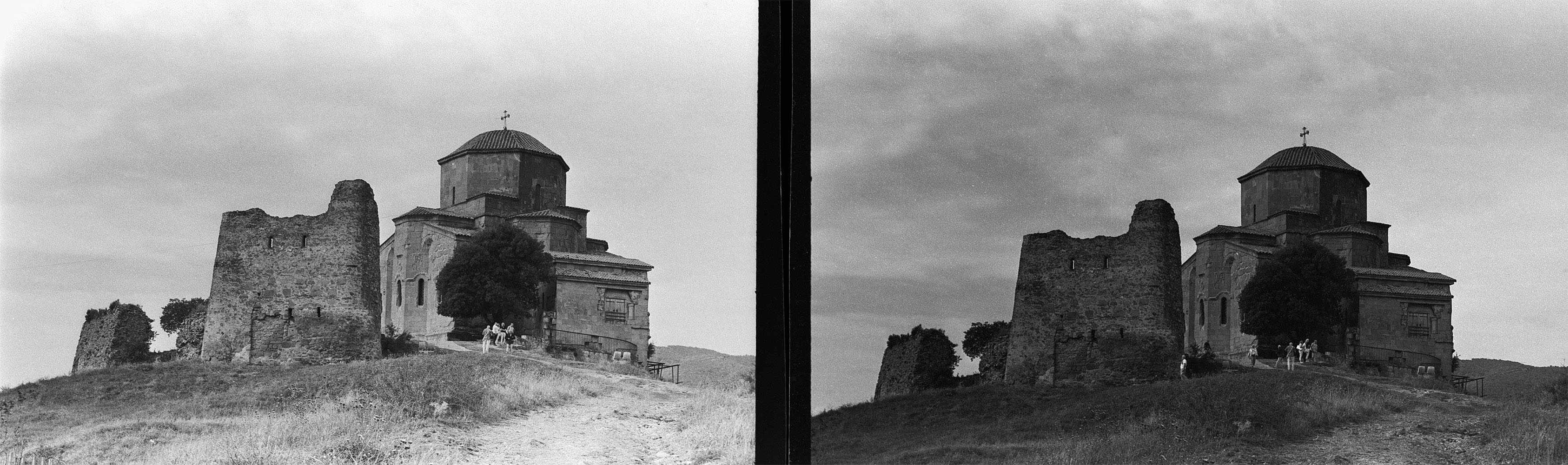

@M-88 there's less shadow detail in the Lucky example. You might have to give it an extra stop of exposure to get similar shadow density as the FP4+.
Does that mean it's underexposed, underdeveloped, or both?
Maybe a little underexposed, but it could also just be a difference in the exposure latitudes or characteristic curves in the films. Maybe Lucky has a longer "toe". See if Lucky is giving you blocked up shadows to your taste in your final images. If not, you don't need to adjust anything. If so, I'd give it another stop of exposure. You usually can't recover much shadow detail through increased development. Some of it is down to personal preference.
I shot two identical images on Lucky at EI125 and developed one of them in D-76 1+1, for 10.5 minutes, while developing the other one for 45 seconds longer. Then scanned them as positives side by side and did a colour inversion. One that was developed for 11 minutes and 15 seconds is on the left and other than the blown out sky/clouds, looks decent. One on the right, on the other hand - not so much.
I think I'll shoot whatever frames I still have left on the roll at EI100 and develop for 11 minutes. Should give me good results.
The example above is not ideal for telling what is what, but the tree is reasonably well-detailed on the left image. At least it's adequate for my taste. I think it would be beneficial for me to pick a few decent shots once I'm done with this roll and print them in the darkroom, to see how it all translates on paper.
Nice shot. When comparing the two, it can be helpful to do one normalized comparison (in other words each image is displayed where the darkest value in the image is at 0 and the brightest value is at 255). And also to do a "subjective" comparison (by first doing the normalized comparison and then applying additional curves to each image to put the shadows, midtones, and highlights where they look most pleasing to you). On the second comparison, you can get the images looking pretty similar in tonality, but they will have some differences in graininess and resolution.
I tried to make a normalized comparison and unsurprisingly, the frame with less development time ended up being darker. Once I'm done shooting what's left from that roll, I'm going to develop it for 11 minutes, instead of 10:30
I'll also make sure to do darkroom prints of few frames (including the one above). I'll be back some time later, with more results.

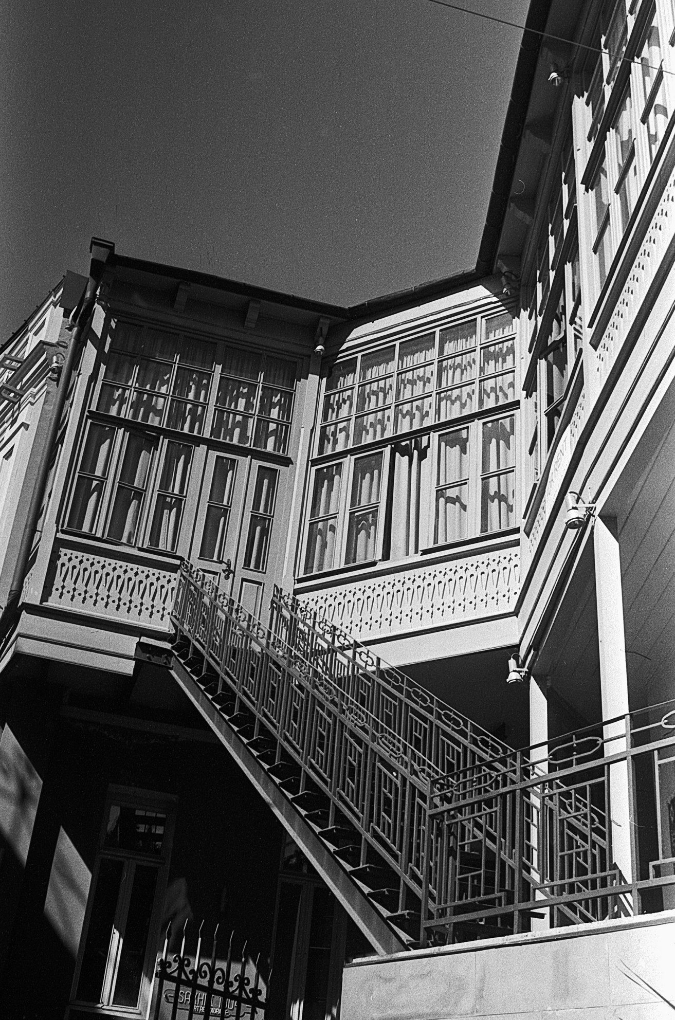

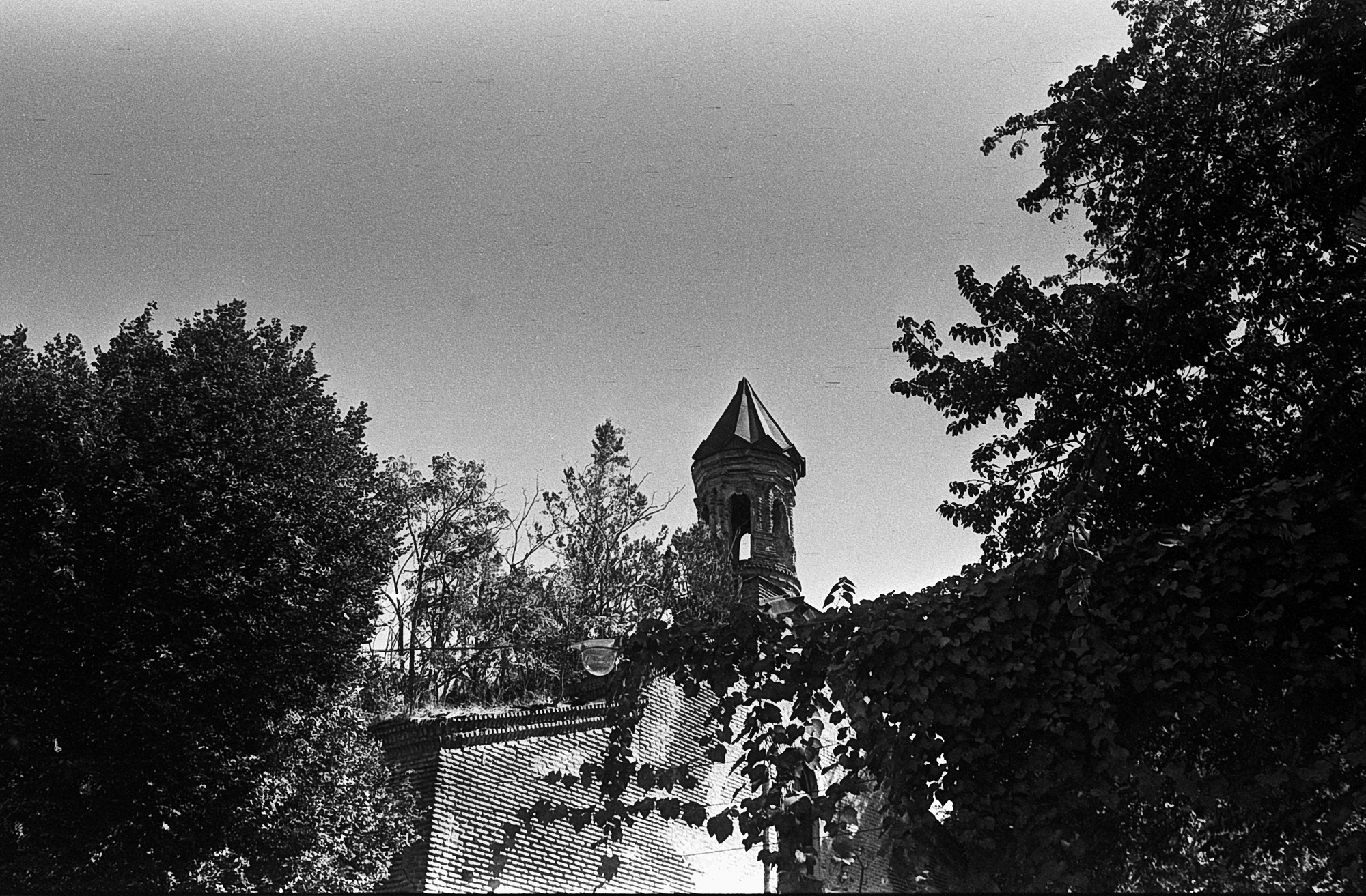

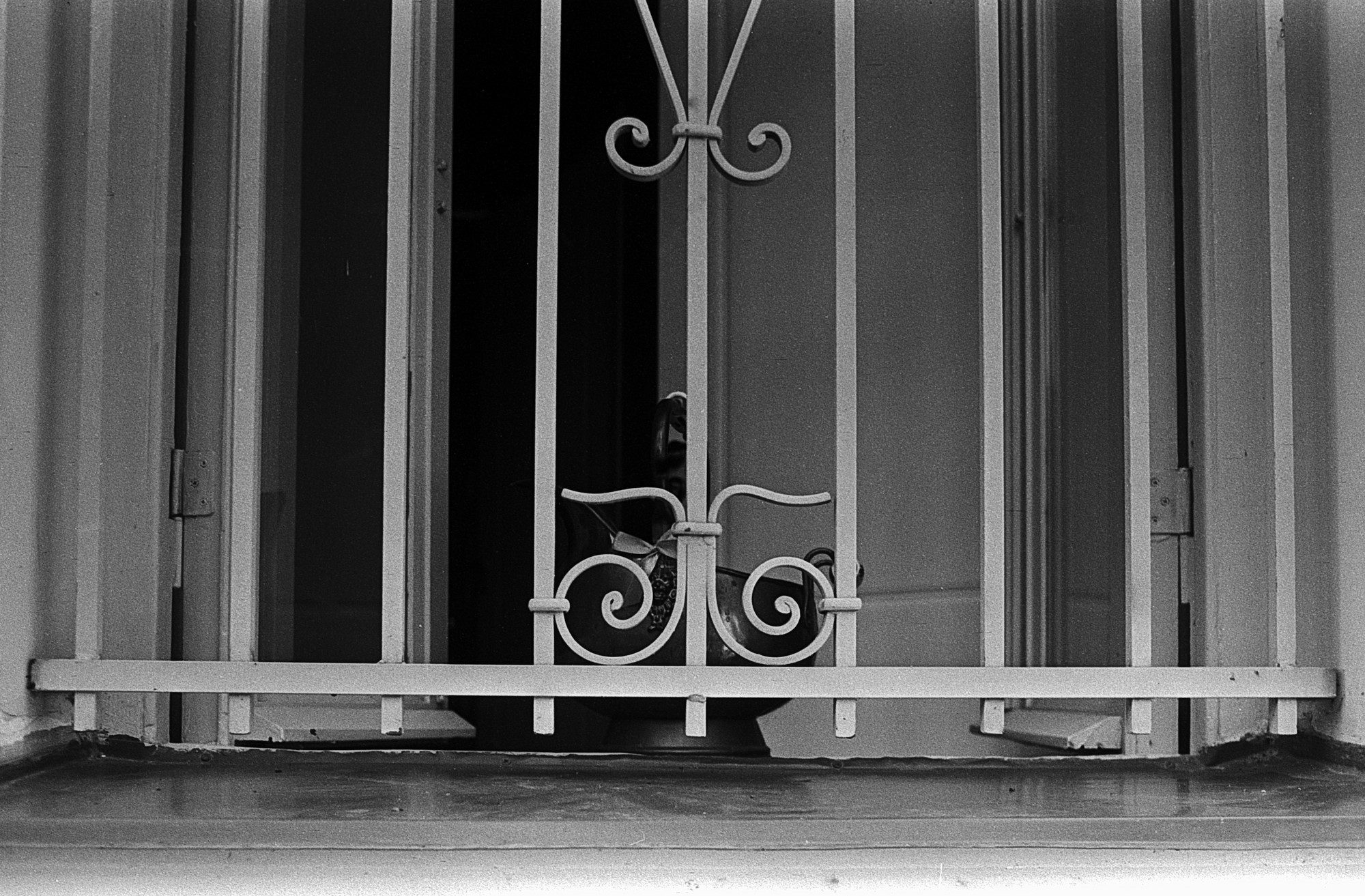

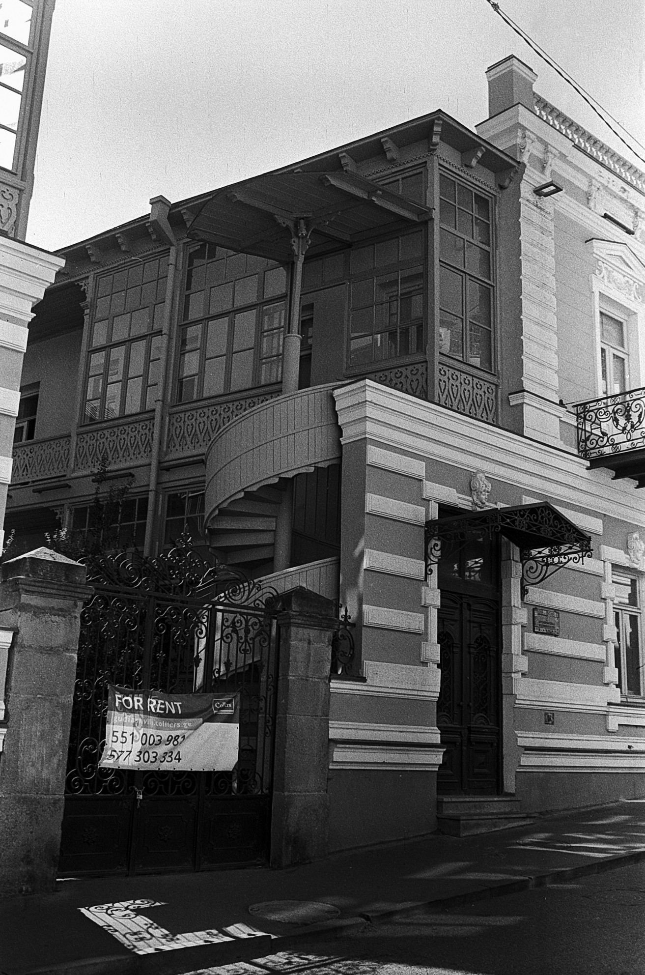

I shot the rest of the roll at EI100 and developed for 11 minutes in D-76 1+1, 20 degrees Celsius. Here are some scans:
Some of the images turned out okay.

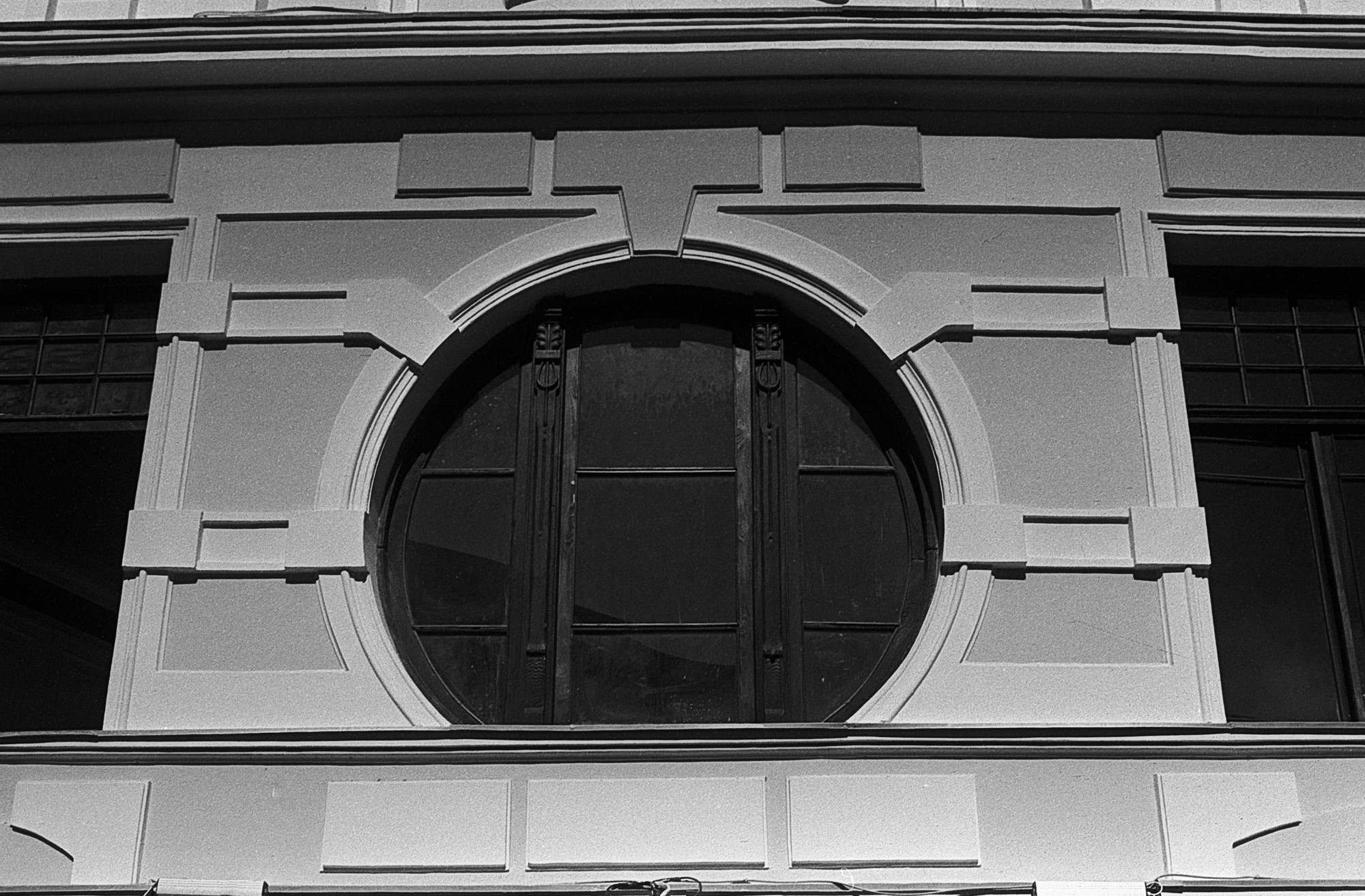

I deliberately metered for the highlights to see how much shadow detail would be recoverable. Some of it details was retained even in high contrast scenes. I shot at EI100 and it seems like a reasonable speed for your average camera meter, when using this film. If it were EI200, I think the shadows would be much worse.

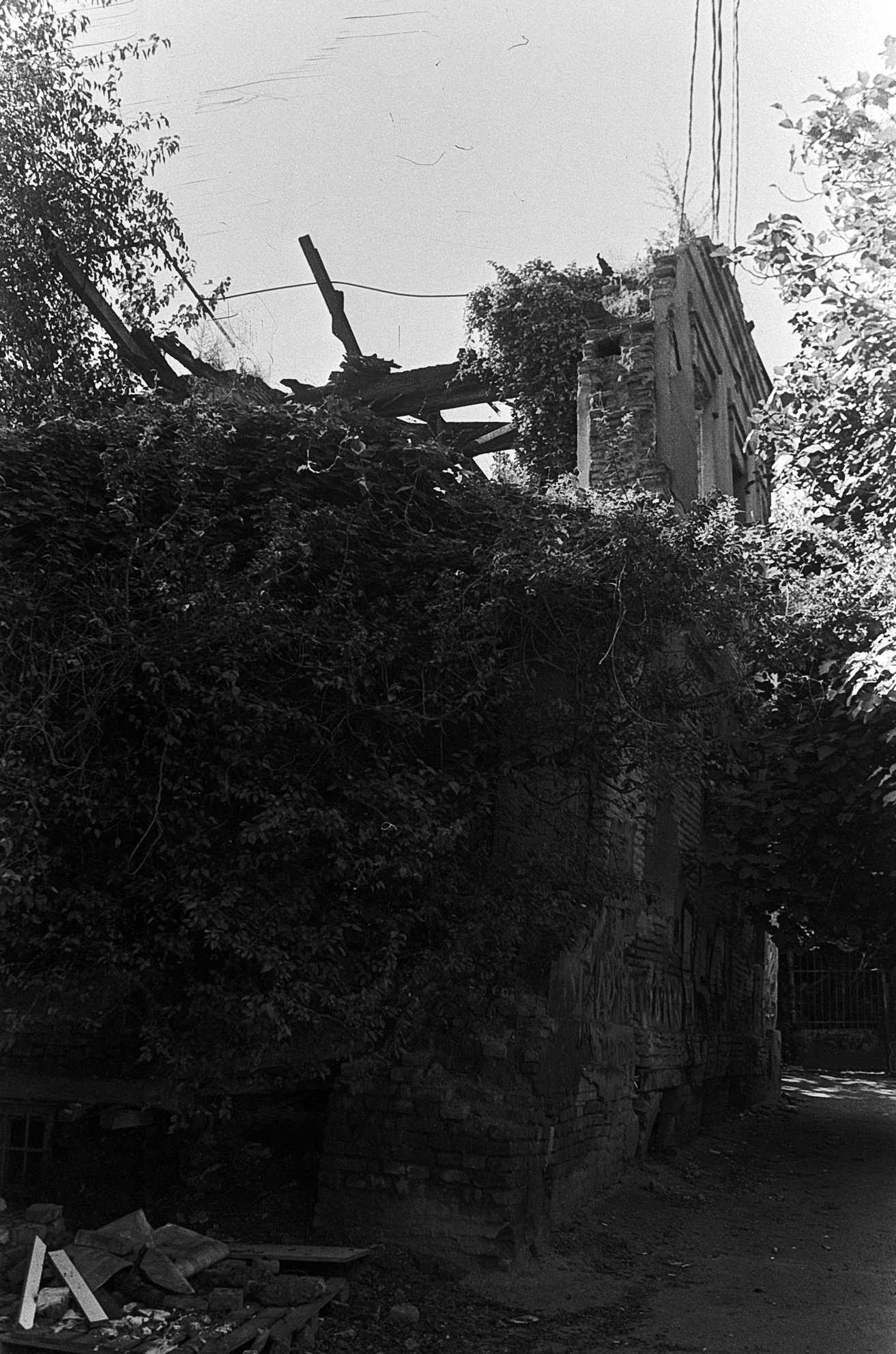

This photo was taken in contre-jour and I reckon the halation is well controlled. But look at those scratches all over the image!
Here's some more samples with scratches. Not only longitudal, but lateral too. Or rather - chaotic. This is disappointing.
First two snippets of the same roll, with six frames on each, had no scratches, so I don't know whether I got sloppy somehow, or if this is a quality control issue. In all three cases I used the same camera body so it's not the fault of the tool. What's even worse is that these scratched images aren't sequential, so the scratches are all over the roll. It would be nice to order another roll and load it onto the reel very carefully, in order to omit human error. Maybe I'll do that some time in the future.

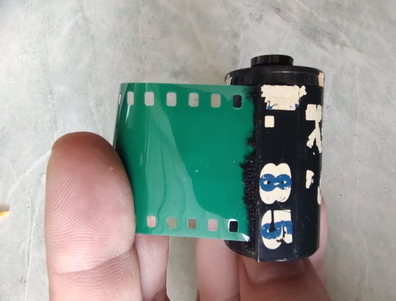

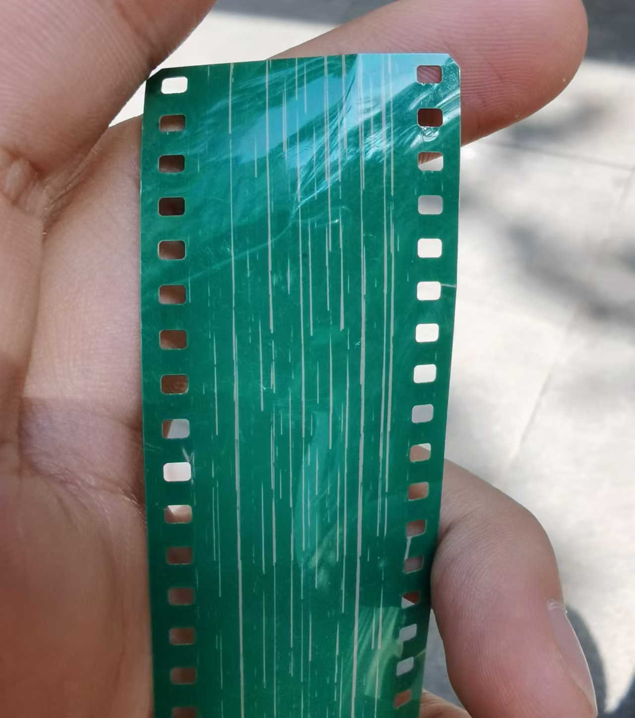

1021 is coated on acetate base with a bright green Anti-halation layer. Attached is a scrap section of 1021 expired in 2018. "New" Shd100, however, is coated on PET base with a more grey-ish Anti-halation layer and the emulsion seems to be thinner. There is rumor that this thing is T-grained as the base could be pink after fixing but as there is no official datasheet no one could actually confirm anything.
This sample of old 1021 reminds me of Soviet Mikrat 300 film, which was a technical film with sensitivity around ASA 3-6. This is what it looks like, but I know nothing about its base, or any other properties, I only have a leftover from a very old roll:

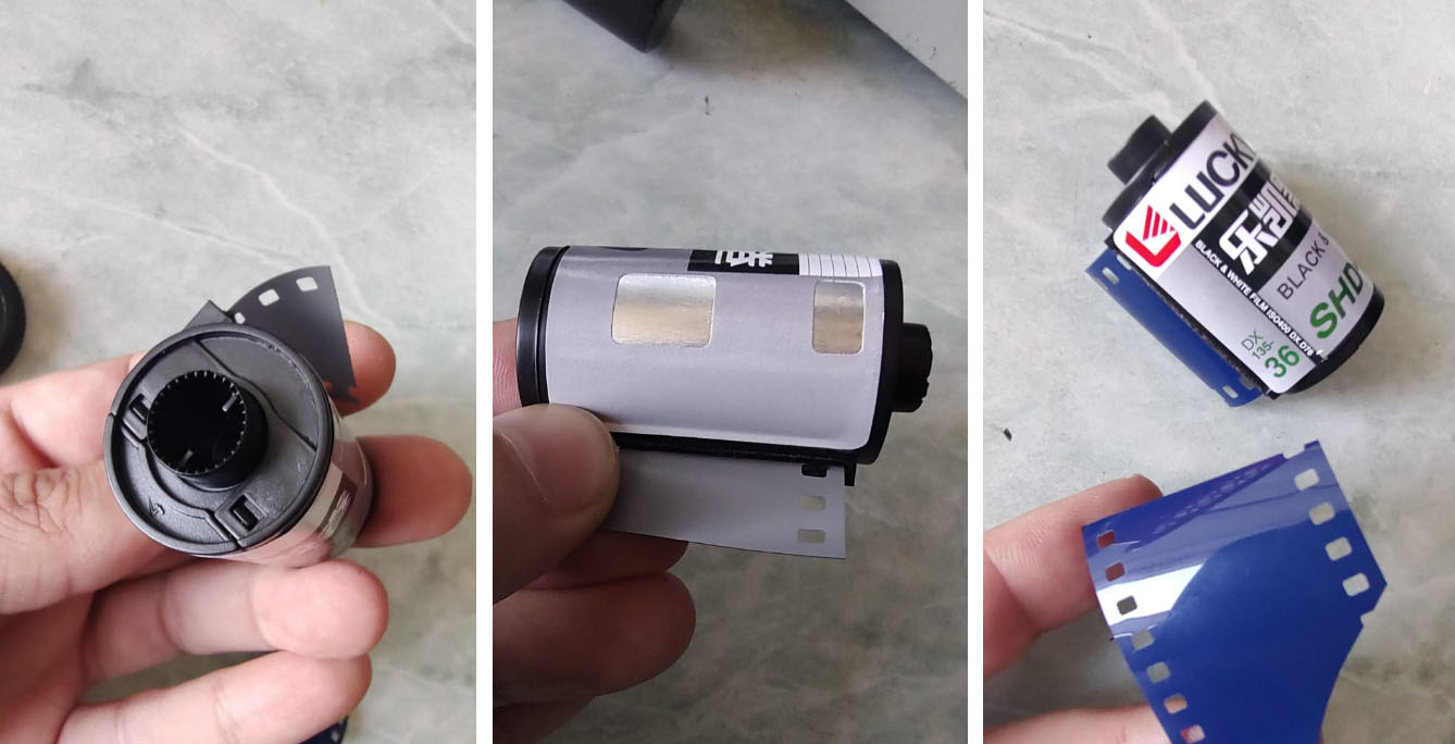

SHD400 in 35 mm is violet/purple. The cassette is a plastic, tear-apart kind, with DX code embedded into the label paper:

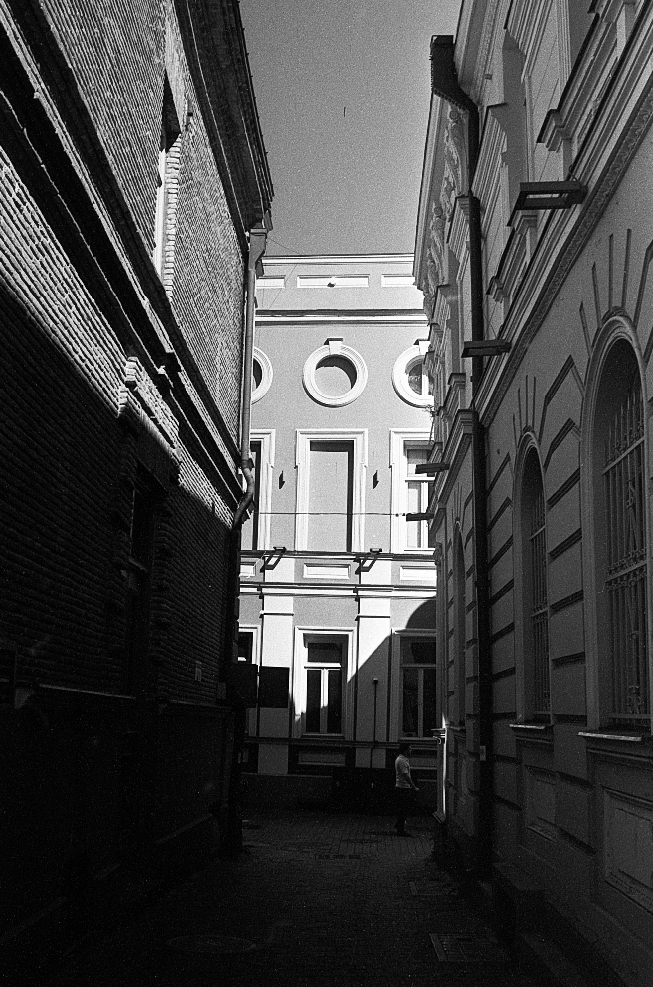

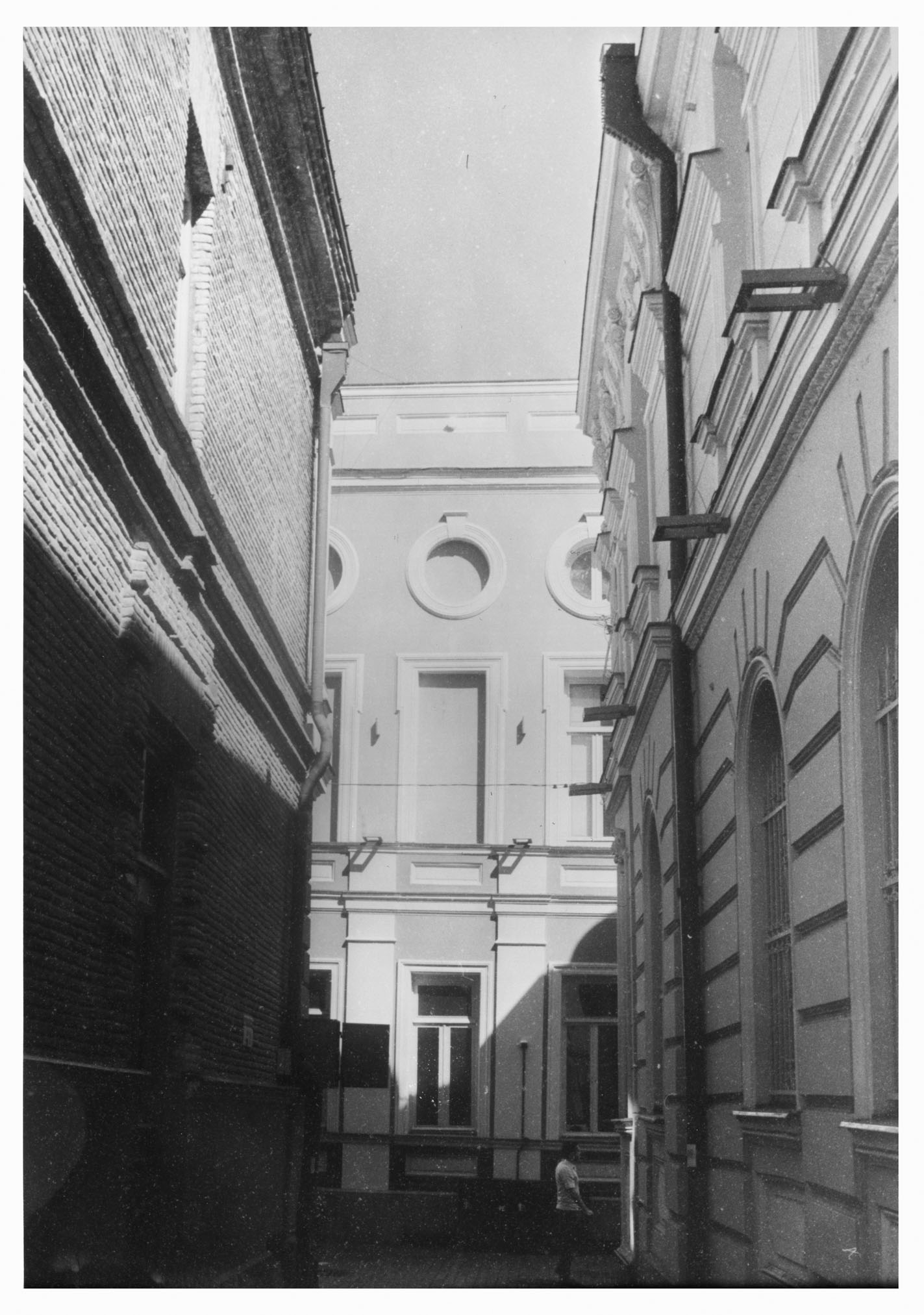

I tried to print few frames in the darkroom. The results came out not what I expected. Since the film has a clear base, I got too much light on the paper and it was difficult to control the exposure even with the aperture stopped down to f/16. ND filters would be nice, but I don't have those, so I'll need to find a weaker bulb. These two images below show straight print (on the left) and print with grade 3 filter (on the right):
This one is a grade 4 print:
Grade 2 and shadow details are quite retrievable. I don't know how to do split-grade prints, otherwise the image could have looked even better:
Also a straight print:
All in all, this film needs some getting used to, in the darkroom. Not so much with scanning. And yes, it gets scratched very easily - I tried to scratch it and the emulsion is brittle. So it requires extra care.

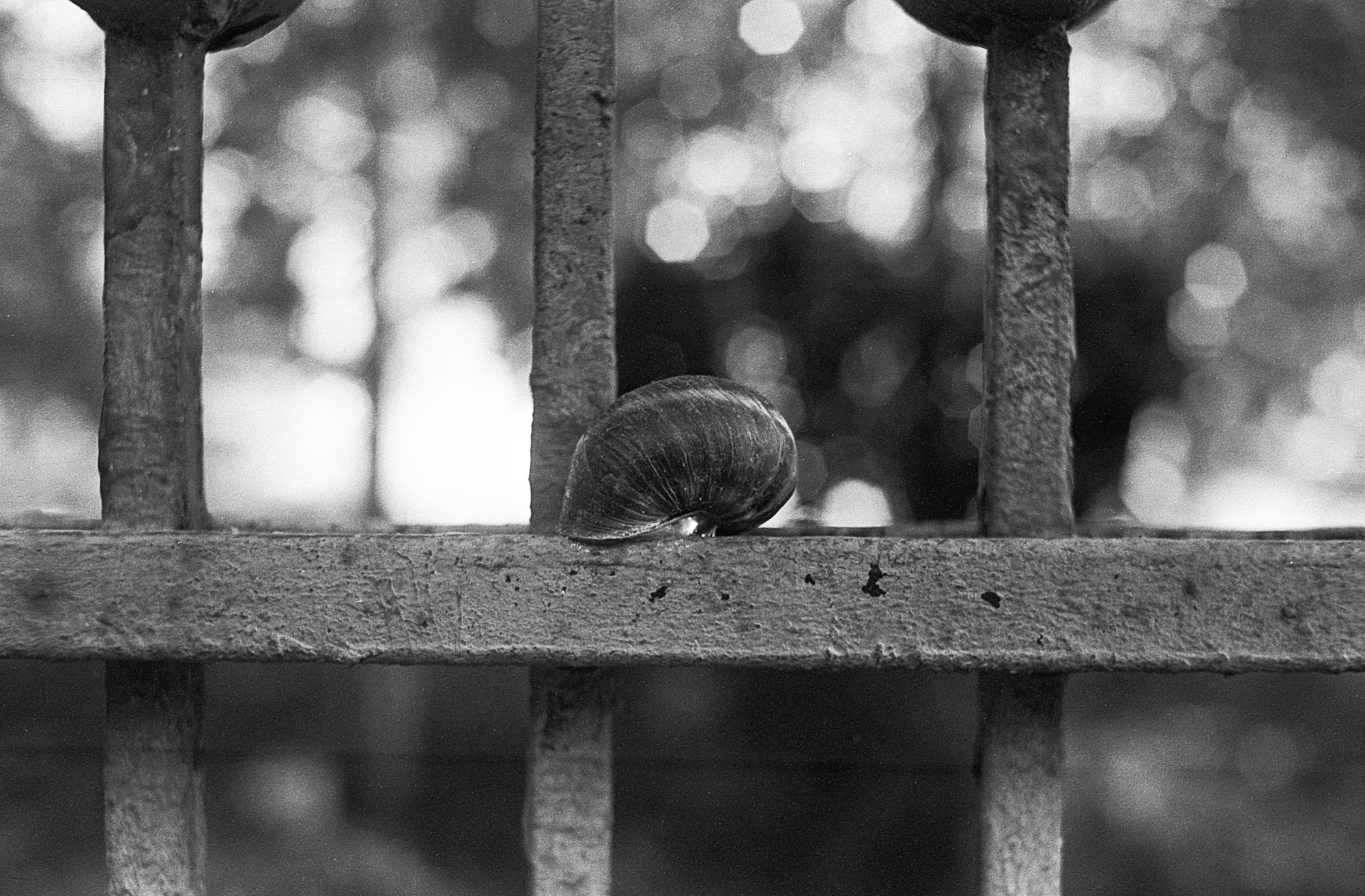

I shot this 120 roll of SHD100 at 100. The sensitivity is quite solid I believe.
