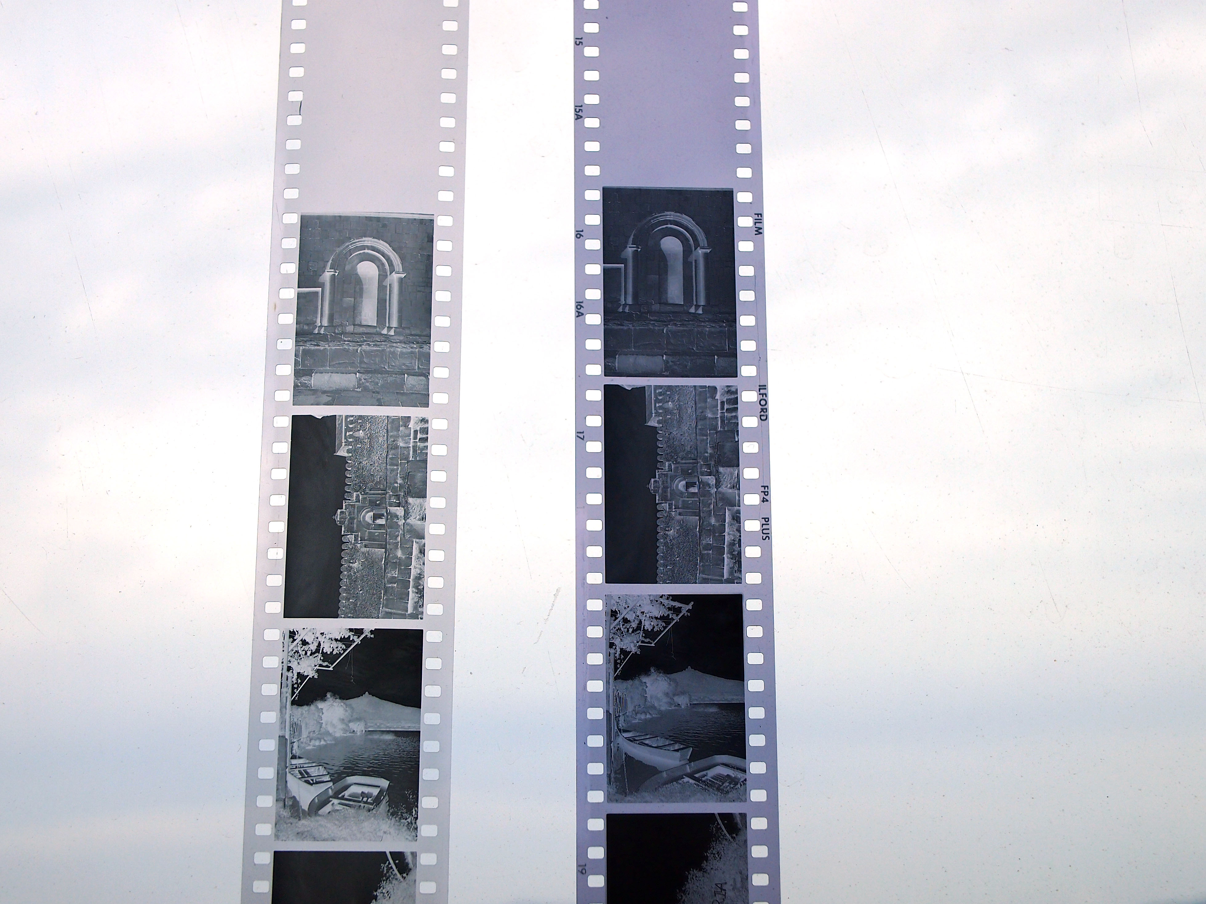

I shot a small snippet of this film, along with FP4+ which was the only other film I had at the moment. I shot both at EI125, for FP4+ it's a box speed, for Lucky it's "somewhere near" its actual sensitivity, apparently. I developed the film in D-76 1+1, for 10.5 minutes. Don't have a light table, so this shot is the best I could get:
Its base is clear, which might be handy for those who do reversal process. While unexposed and undeveloped, it has a distinctive smell which reminds me of the smell of unexposed/undeveloped C-41 negatives. There are no edge markings whatsoever, but there are no scratches or other unpleasant surprises either. Would you say this snippet is developed correctly? Or should I try different processing time? The scans look ok, but they always look ok on my below average scanner.
@M-88 there's less shadow detail in the Lucky example. You might have to give it an extra stop of exposure to get similar shadow density as the FP4+.
