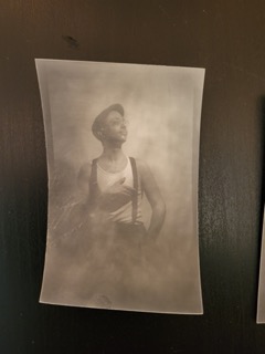

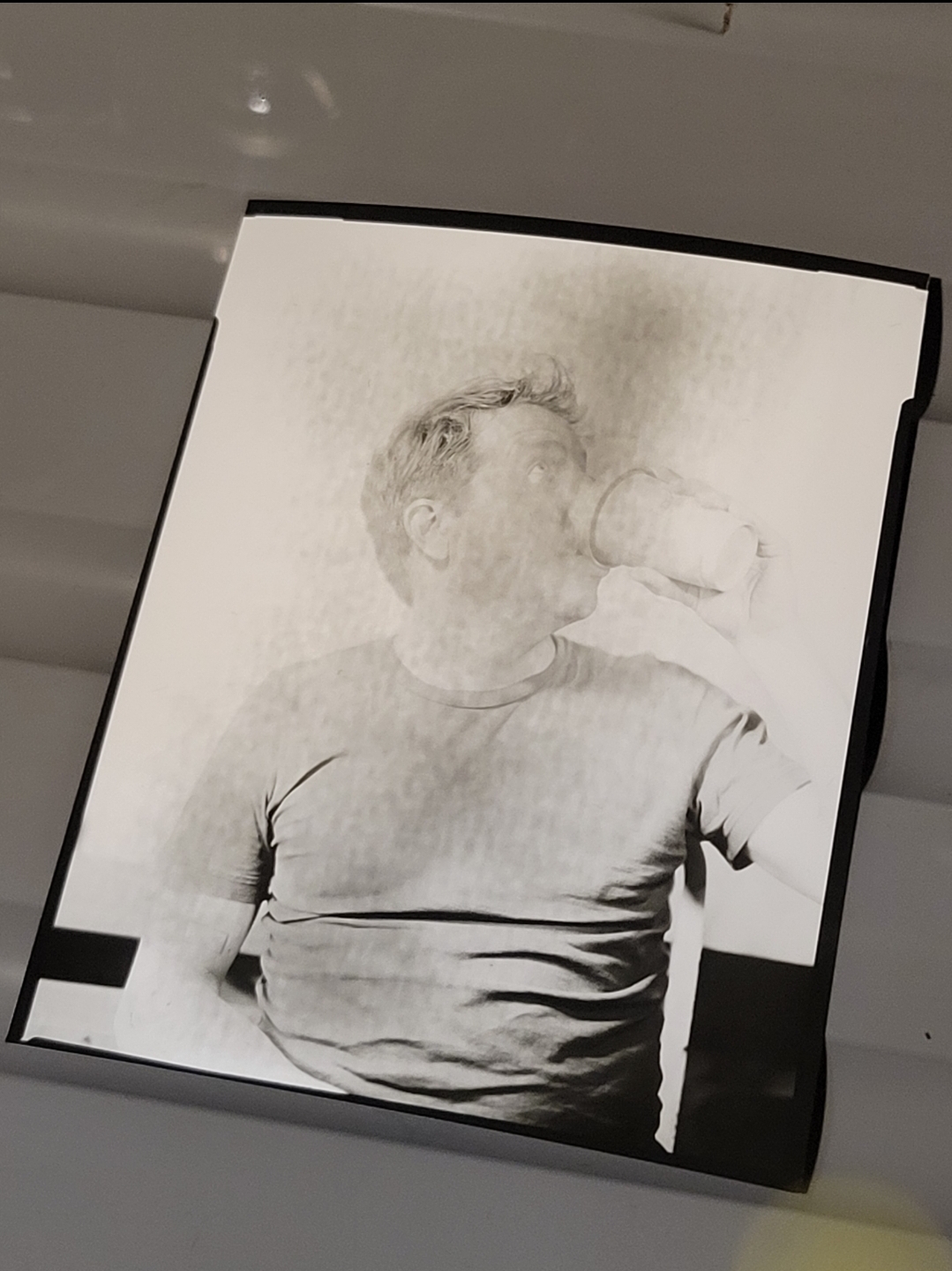

First picture:

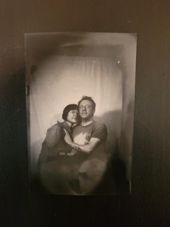

Second picture (blacks already weakening, in waist area where they should be)

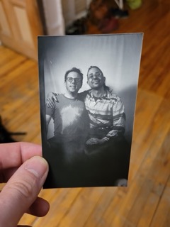

Third picture: (no blacks except in the corners, the darkest area of absolute black, the edges of the flash range)

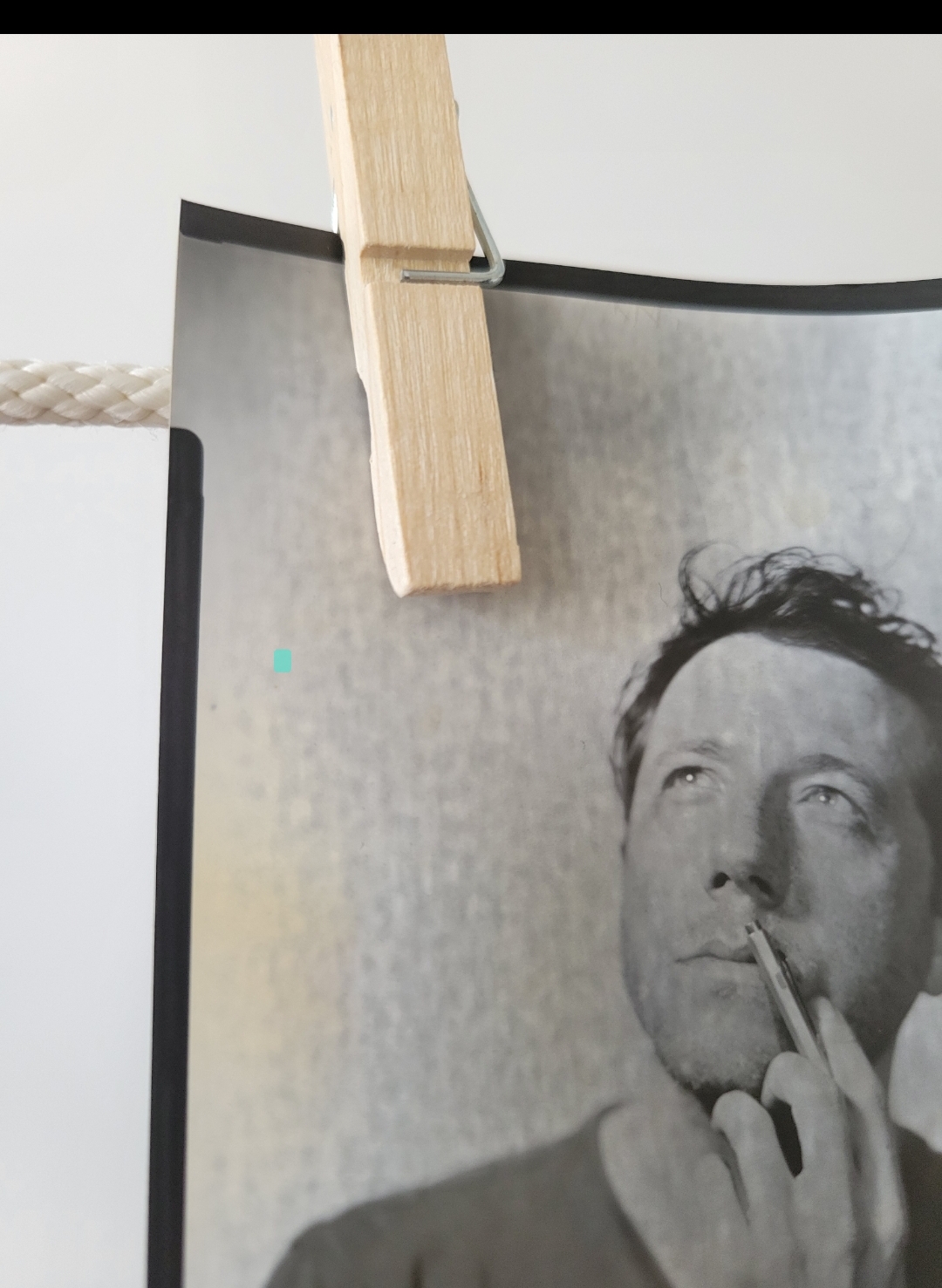

Fourth picture (already unable to get any blacks at all anymore).
After this fourth picture, the fifth stil develops with rich blacks for the 'negative' initial image, but the second, re-development is inutile.
The confusion:
If the developer is contaminated enough to prevent blacks from forming during second development, why does it still produce full blacks during the first development of the next print, using the same developer?
I'm thinking it has to do with the potency needed for the second, re-development, after bleaching. The Initial Development is handling fresh, unbleached Ilford Multigrade paper. Only the areas hit by light (exposed silver halide) need to be reduced to metallic silver. The emulsion is clean, no weird chemistry in the paper, so even a partially oxidized developer still has enough reducing power to turn this silver halide into deep blacks?
But when the second development (post-bleach + re-exposure), the print has just been through bleach (KMnO₄ + Sodium Bisulfate), a quick unfresh wash, and a fogging exposure to light. The emulsion now contains: residual oxidizers (even if microscopic), possible manganese dioxide stain (from KMnO₄), and fully fogged halides (needs complete reduction across large areas).
So the first dev still works while second dev fails because the developer is partially weakened, but not dead. It can still handle the lighter job of initial development on fresh paper but it can no longer handle the heavier demand of reducing fogged halide after the bleach/fog steps. Does that sound right? We imagined it's like cooking on a camp stove with a dying propane tank. The first development is like frying an egg, and the second is like cooking a steak. We have enough heat left to cook the eggs, but not to fry steaks.

As to your problem with the brown spots, I wonder whether the reversal exposure plays a role here. How are you doing that exposure? Maybe it needs to be controlled, and more even across the sheet.
AFAIK there's no solution for the mottling in the highlights; not sure if you experience that as a problem, but in case you start wondering about that - it's inherent to the paper base.

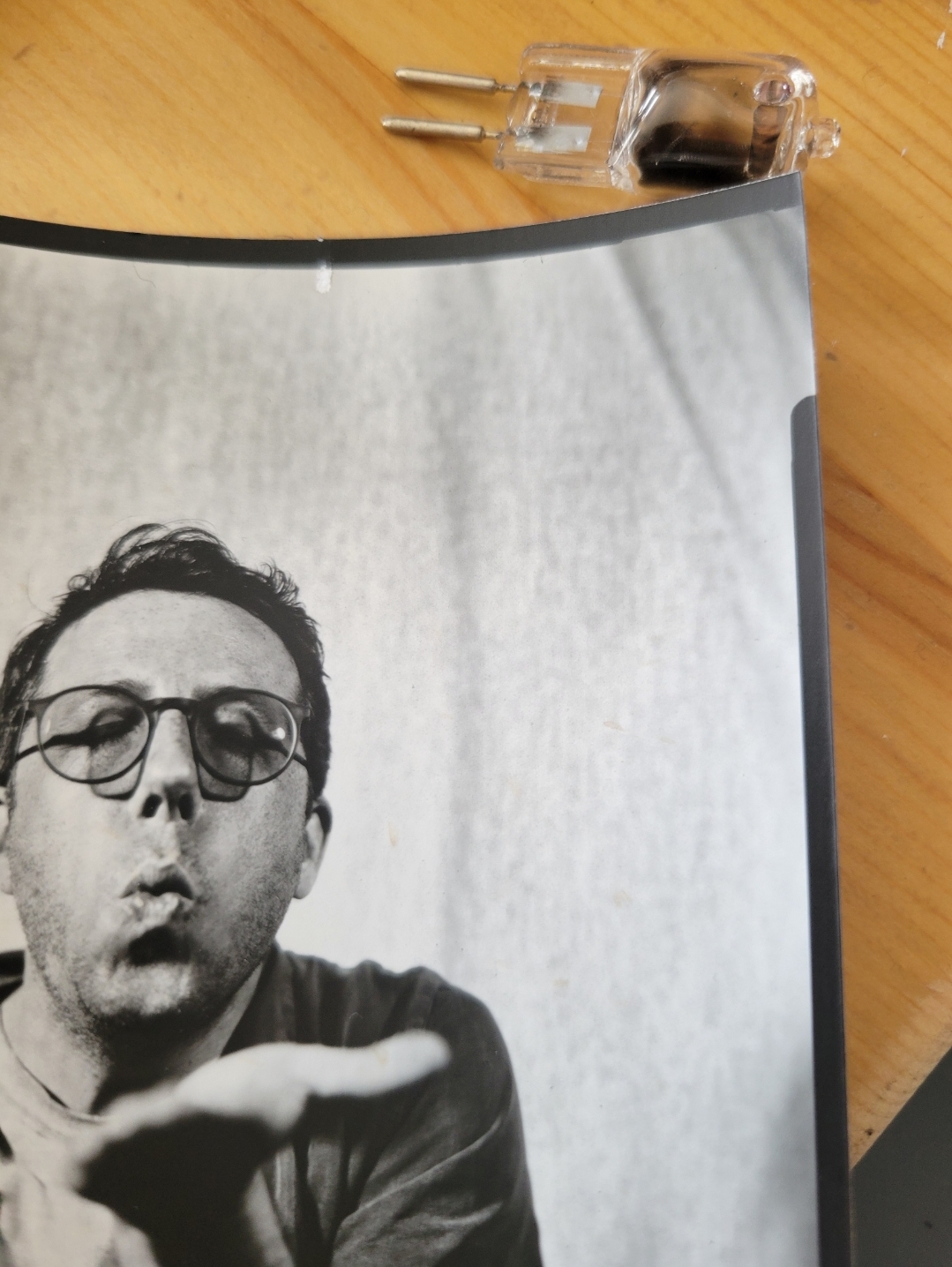

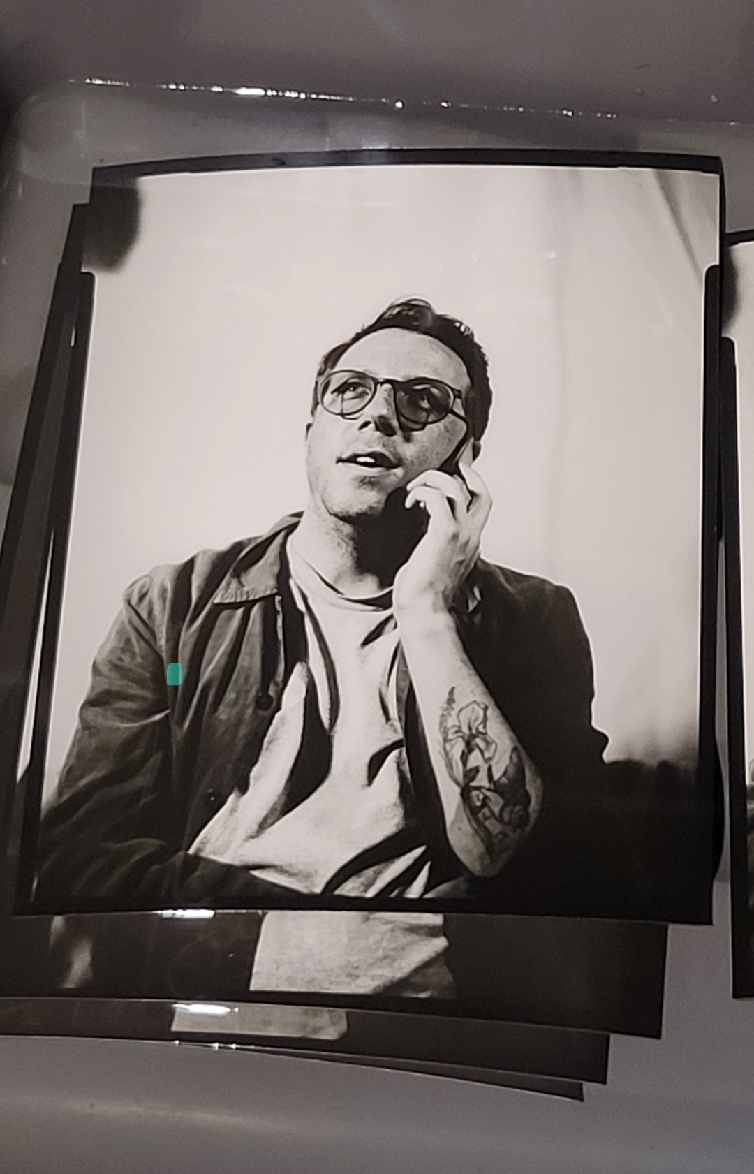

We fixed the contrast issues with a Crown Yellow 2 filter. Unfortunately the 0 filter from the enlarger didn't do much.
The development issues we narrowed down to being old/depleted/exhausted developer. After mixing a fresh batch, it pretty much disappeared completely.
We also realized we only really need to bleach for 30 secs until the bleach starts to get tired and we add a few more seconds.
The sodium metabisulfite bath to clear the bleach only needs 1% and 30 secs as well. We're still using the same mix from our early tests and its working like a charm.

Well, I tried the process and was successful thanks to a lot of the info above. However, the material is very slow (low ISO), coming in to be ISO 1.5 or 2 for Ilford Multigrade RC paper and ISO 1 for Ilford graded RC. This is close to the sensitivity of wet plate collodion I believe. I work with strobes mainly doing portraits and don't want to have to use more than 2400 WS of power for many reasons - not wanting to blind the subject and not wanting to blow fuses working in place I'm unfamiliar with or don't have full control over. So, I'll go back to my corner which is dry plate silver gelatin which is around ISO 2.5 or so. My next nut to crack will be making my own emulsion, hoping to get to a ISO 8 and higher.
The develop recipes for this technique is a bit scattered around, so I want to write it all out neatly for any new viewers and give some procedure tips and opinions as a user of the material. There is talk above of developer exhausting, so I used a fresh 30ml shot of developer for each photo. Using the same bath for first and second developer worked well. I rinsed the photo in water for one minute between each chemical bath, as its good insurance for chemical baths lasting longer for their intended purpose.
I used Ilford multigrade RC and Ilford graded, #2 RC, (although the box doesn't have a number on it, I'm guessing it is a 2 since that is what they seem to sell now, my box is 5 years old.). Shot in my 4x5 camera with a wide open lens at f5.6. Strobe metered at 5.6 +7 produced a photo that one could say needed more light.
1. Development: Seems any standard paper developer is good. I used Sprint paper developer at the recommended 1:9. I did the 'standard' one minute development for RC paper.
2. Stop/rinse. I didn't use a stop bath but simply rinsed in water for a minute.
3. Bleach: Equal parts of A and B combined right before use. It seemed to last/be effective all day. I bleached until the image disappeared and the paper turned a light grey. Took 15 seconds when bath was fresh, 45 seconds after 8 prints and hours later.
Part A: 2% sulfuric acid. I bought a bottle of drain clog remover as my source, as the SDS that said it was mainly sulfuric acid.
Part B: .04% potassium permanganate.
I used a bath of about 300ml.
4. Rinse with water for 1 minute. May be able to skip this but I'm a fan of not contaminating subsequent chemical baths.
5. Clearing: 1.5% sodium metabisulfate bath. One minute. At this point you no longer need to be working in safelight conditions. I used a bath of 300 ml, and it still seemed strong at the end of the day.
6. Rinse again 1 minute.
7. Expose to light. I had a household LED lightbulb that I had about 12" away and turned that on for 10 seconds.

Since the last time I posted, I've gone with "post-flashing" the paper just before the first development and not using .4% hypo to control the highlights and reduce contrast. Photographic paper has 2 qualities that are good to know about when doing reversals:
1. It contains excess silver halide in the emulsion to make a solid black
2. The emulsion itself is made to reproduce an image from a negative, which "compresses" the dynamic range between it's base "fog" (the tint of the acetate) and the darkest shadow it can produce.
When using paper to produce a photo from a negative, it all works quite nicely because the paper "expands" the dynamic range of the negative to a photo that can contain zones 0-10 (through features of silver halide which is sensitive to different colours that can be recruited with filtration to control contrast), and you can expose the paper "just enough" to get nice blacks. Any extra silver halide beyond what is needed to produce a solid black gets removed with the fixer.
But when you do a reversal, if the "negative" looks normal after development, you'll notice that after bleaching and fogging, the resulting reversal is too dark because of the excess silver halide in the emulsion which gets developed after fogging. Instinct tells you to expose more, to make the "negative" darker so the reversal can develop lighter. This results in higher contrast in the reversal.
Trying to determine the viability of a paper negative developed for a reversal isn't really feasible because you can't tell how much silver didn't get developed with the first development step. So a black part of the negative (which should produce white when reversed) can look nice and black, but after it's bleached, fogged, and redeveloped, it could still be from darker gray to a mottled white. In my experience, a well exposed paper negative and post-flashing will produce an almost uniform black negative before bleaching.
In theory, post-flashing exposes the paper with just enough light to get rid of that excess silver and to also produce a solid black in the reversal. The method is similar to pre-flashing for paper negatives, except in reverse. When examining the test strip (after reversal processing), you're looking for the darkest grey next to solid black, then using the exposure settings of the solid black next to it. For my setup, it's quite a bit of light: 5 sec at f/22 with the enlarger at 32cm. I've found post flashing allows me to shoot outdoors at a solid ISO 4 or so (depending on UV light) and the contrast is very much under control. Indoor lighting will be slower, depending on its colour temperature and the amount of UV. I've shot as low as ISO 1 using just incandescent lights, or ISO 2 with flash.
Here's some tests I did with old fogged paper. Fogged paper itself would do better with reversals than non-fogged paper because the base fog (some of the excess silver halide) will get removed with the bleach. Using fogged paper and post-flashing lowers the contrast a lot:
