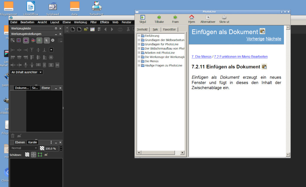

I have now installed the trial versions of PhotoLine and ColorPerfect on my Linux machine. Installation was rather simple, and the two cooperate just fine (OK, PhotoLine's help does not work).
I don't use the PL inline help, but i have just checked on my system, and it works, ie. clicking on top menu bar "?" > "Hilfthemen" , but shortkey call F1 doesn't (could be configurable in Wine settings).
