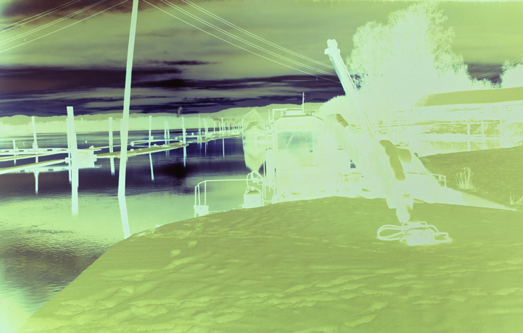

You will never get good inversions on frames like that. I am Grain2Pixel creator and I can tell you that there isn't a single frame algorithm capable to invert an image like you posted with amazing results. Simply put, because there isn't enough color information to make a good color balance. All color balance algorithms are relying on colors in order to set the gamma values on each channel and also the input and output levels/curves values on each channel. Without enough color, the color balance will be fooled and the results will start to be only an approximation.
yes, but inside the limits of what can be done, I found ColorPerfect more adequate in order to get to a plausible positive of the original scene.
One way of fixing that is to use a carefully crafted profile which will cover that combination of film + sensor + light. That implies you will shoot a frame of that stock with a color chart in 5600K, develop it in fresh C41, then scan, then manually create a set of adjustments on a calibrated screen to match the color chart with the reality. Then, your snowy cottage will invert just perfect. This procedure is a little difficult and it works only with films developed in identical conditions and you will have to craft profiles for most of the films you are using.
I know, I wanted since long to do at a calibration but was lazy. In fact I ordered a target earlier this week.
This brings the way how ColorPerfect works. As I have mentioned it to Old Gregg in the above comment, the key initial step with CP is to pick an emulsion. A long list is build-in inside the plugin. BUT, some are extinct and newer ones are missing. I did overlook this when I tried CP last year and I left after the trial because there were some weird colour casts with Lomography films that I couldn't get rid of. I had negatives that were un-fixable. Only recently by reading through more doc, I found that the characteristics of an undocumented film has to be approximated as much as possible. CP interface makes it possible to get relatively close by modifications of the colorometric parameters from the less worse emulsion choosed in the list. When I got this, all of a sudden CP became excellent and very powerful. And that's also why I have ordered a target, to try some basic calibration. Btw, my scanner is calibrated against an it8 target.
That said I don't expect miracles, and development in small hand tanks induces more variations, but it will be good to have references. Film emulsions change over time so this must be redone sometime too.
relatively to this aspect of film, I believe the flaw of NLP is that it makes a general assumption a priori, of what is supposed to be a "nice" picture, and applies some sets of more or less averaged/ more or less ponderated calculations on the data of the negative. It then provides a menu of tweaks supposed to please different tastes. So unless the negative is really really wonky, you get anyway a "nice picture". But it may not be what you saw when you took the shot.
Another way is to use external color information within the same roll. Assuming that your roll contains various shots with enough color diversity, you can use other frames information to color balance the snowy scene. This is a new feature I implemented in Grain2Pixel and it's in beta stage. It's called Roll Analysis. It takes a little longer because it has to parse first the entire roll and grab color information from each frame but the results are much more richer and stable compared with single frame inversions. Once roll analysis done, it's reused for any frame from the roll. This method works only of the selected frames to be analyzed are having enough color information. If the roll consists in just 36 exposures of the same scene (and that can be a possible scenario) then I would recommend manual conversion.

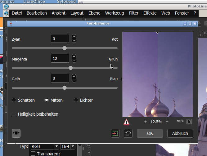

you do a standalone, or a plugin which can run on Photoline, and I give you 150€ :smile: (If it performs better than CP which I use now)

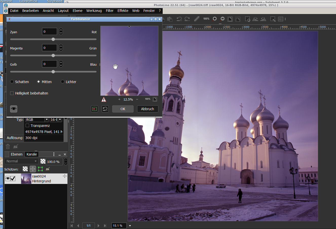

anyway, since you mention the other renderings of NLP, for that former negative posted earlier, here are, left to right NLP LABsoft, Linear and Flat. They still are not there in some of the snow and with the red bin to the right. "Flat" in this case would be indeed a good base for few tweaks. But CP (ColorPerfect) provides a better one when I have the image in higher resolution on the display.
I spend four/five months surrounded by snow, and november-february are short days like 11:00-14:30/ 10:00-16:00 and shorter the more north I spend a week-end. Also the sun then is low on the horizon, with very long twilight, it's not illuminating from the top over your head but from a "side", which means in case of blue clear sky, that it gets on your way easily. This can be a PITA or be taken advantage of.

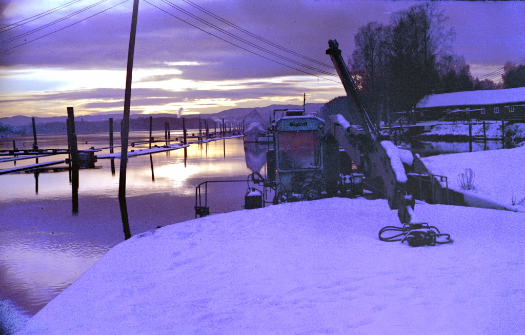

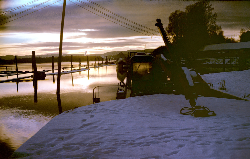

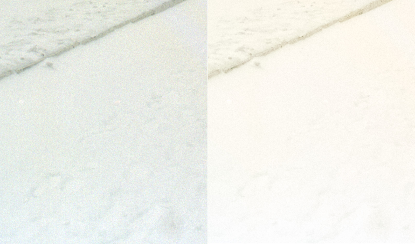

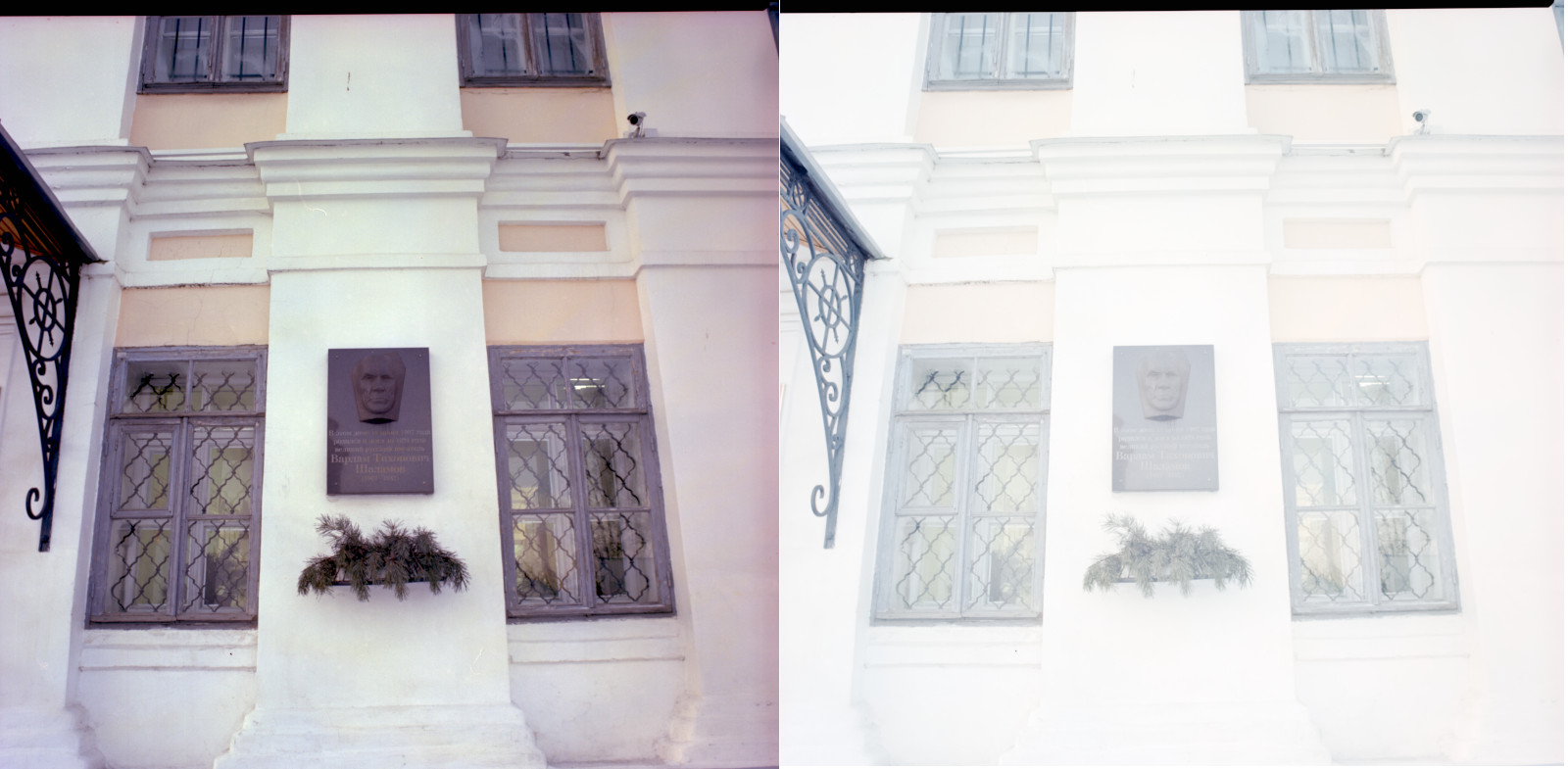

I bought NLP end March, I ditch it now, not only after recent pictures, but also I did process bunch of pictures taken before I bought it, that I processed "by hand" in Gimp.
Here 3 scans in DNG format as per NLP requirements, Epson V700 @2600dpi 48bits, ~140mb each, film is Ektar-100:
https://yadi.sk/i/uBvUIQnfupdYnw
https://yadi.sk/i/cz4O4IQEklWi4g
https://yadi.sk/i/gTaL7ZLQLuLwNw

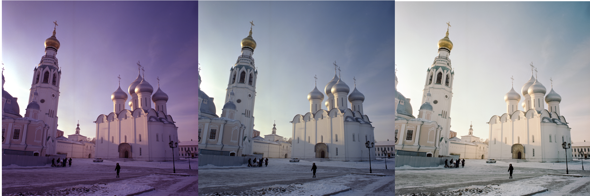

now the positives obtained with ColorPerfect set to Kodak Ektar-100 on the left, with NLP default (LAB standard) with "WB setting" to "Kodak", on the right.
1st negative:
the best match is on the left (CP), blue must be corrected, blue must be added to restaure the deep blue sky, but otherwise the illumination of the square, the dark golden reflection of the dome on the left, the light/shadow and darkned tone of the paint on the lower building are ok, BECAUSE I took the shot late evening (well it was ~14:00 but sun was getting down). It's all missing on the NLP positive on the right
2nd negative:
see the evening light cast by the sun setting? It needs some correction, but that's what I was seeing when I took the shot. Again, to the right it's just wrong season, wrong exposure, wrong luminosity:
3rd negative:
again a yellow/blue cyan/red balances must be corrected, the sky like in the previous shots is messed but the fix is trivial. You can see what it is: the sun is on the horizon back the kreml, casting illumination on the towers, it's getting dark. It's golden hour.
With NLP golden hour is gone
I don't see a golden hour in your pics. I see a purple hour. Basically purple in all the images you favour All the NLP images look much better, and you can adjust the exposure and you can adjust the luminosity to bring it down if you want to show more of that golden light. For some reason you are fine with having to adjust your purple pics, but have a problem having to adjust NLP pics.

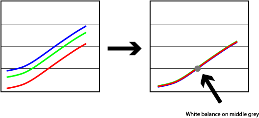

You are right that the log exposure curves are not absolutely parallel, but the reason the orange mask can be cancelled out with a gain adjustment is that the curves are mostly parallel for most of their exposure range. Color negatives can often display a magenta or cyan tinge if extremely under or over-exposed, because you get into the areas of the the exposure curve where they're not even close to parallel. But for the sake of making the math simpler, we can use a imaginary brand of film that has very parallel exposure curves, so that they look like the ones in my article. In which case, to get them to line up, all you need to do is adjust the gain of two of the channels.
Here's the trick, in order to convert colors in one space to another, you need to do matrix multiplication. So you take the XYZ coordinates in the original space and multiple by the transform matrix to get the coordinates in the destination space. What ends up happening is that the graph of the log exposure curves of the colors in the destination space, once you've converted everything back, because you've taken points in a 2D space, mapped them into a 3D space, then performed a geometric transform of that 3D space, and THEN mapped them back into a 3D space. When that happens, the graph of the log exposure curves are no longer parallel. In order to make them parallel, you need to alter the curves to match, which in adjustment terms means applying a gamma curve to each. I actually went through at one point, converted a simplified exposure curve to XYZ coordinates in an imaginary color space, performed the matrix math to sRGB, and then back to a log exposure curve and the curves were no longer even remotely parallel. Which means that to get them to overlap properly, I would need to measure a grey at every point along the exposure curve and bring the curve back into alignment. This is exactly what it looks like NLP does when it inverts and correct images.
This is what happens when you render a RAW file in Lightroom or Photoshop. You're performing matrix math to get them into a known color space, and as a result you've changed the relationship that would have let you correct for the color mask by performing a gain adjustment. I believe this is also what happens when you capture the light passing through the negative on an RGB sensor, compounded by the fact that the sensor's light response curve is probably not the same as RA4 paper, meaning that again the relationship between the colors is altered in a way that can't be corrected by a simple white balance adjustment.

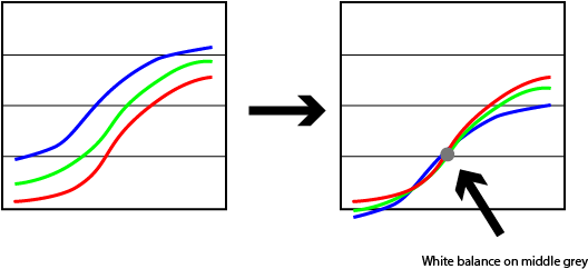

Lets start with log: what you mean is gamma. Log is a way to measure contrast, to say something is 'log' what that inherently means is the gamma roughly follows a specific gamma value. What that gamma is, is something else. It could be 'log gamma' (which does have a definition), but it can also be pretty much any other gamma value. At any rate, film emulsion contrast does not have log gamma.
In color negative film, each color channel is not the same gamma, and they most certainly are not 'linear gamma' (otherwise known as gamma 1.0). If you want to do color transforms, you need to get it linear gamma first, otherwise things go haywire and your colors get all weird. How you get to linear gamma can be done by characterizing the gamma curve of each color channel as @pwadoc describes, or, you could just simply measure the contrast along the straight-line portion of each curve and use that to make a curve that straightens it back out to gamma 1.0 from whatever it was before. Once you've done that, you can then white balance it and it will by and large behave just like it would if it were actual raw samples from a digital camera.

  1. I just can't see how two parallel lines can possibly stop being parallel after a matrix multiplication. Linear algebra is called linear for a reason. I will go and check how that transform is done, perhaps it's more convoluted than a simple matrix math. This seems to be the key statement in the blog post: that in the process of creating a linear RGB image from color negative film we're introducing color shifts in highlights/shadows. WTF.
  2. I reject placing any significance on film color dyes forming a special "color space" that needs to be treated differently. I do not see film dyes as being different than dyes on my cat's collar when I photograph it, and therefore emulsion contrast is irrelevant for capture and irrelevant for inversion: any minor differences in contrast between CYM layers will be captured and preserved post-inversion, i.e. they should have no effect on the end result.
Looking at the DNG spec may shed some light on #1, but #2 remains a mystery to me.
Well, WRT #1, @pwadoc is missing a couple of things. What he's seeing is probably due to the fact that the curves aren't parallel, and won't be until they've been linearized. Like I said before, there's a couple of steps in there that are missing.
For number two... how do I explain this is simple terms.... There is nothing that says your color primaries have to be red, green, or blue. In the case of both printed paper and color negative film, the color primaries are cyan, magenta, and yellow. In the negative emulsion, a specific combination of cyan, magenta, and yellow densities equals a really specific XYZ coordinate in CIE XYZ color space. So when you take a picture on film, you are making an analog representation of XYZ coordinates using Cyan, Magenta, and Yellow dyes as your primaries. The actual color of those dyes is closely matched to the Red, Green, and Blue color response of RA-4 paper, which in turn, creates Cyan, Magenta, and Yellow dies on the paper when developed, thus giving us a positive reflected image.
Now lets say you digitized that image on the film negative with a DSLR and pulled the image into your favorite raw processor. The raw processing software will proceed to apply it's RGB to XYZ transform to the raw samples, then apply an XYZ to RGB transform to sRGB and display it so that you can look at it. What you see is what you would see if you held the negative up to light. You now have a color managed digital RGB image of an image that is using cyan, magenta, and yellow as its primaries. That same combination of Cyan, Magenta, and Yellow densities still means exactly the same XYZ coordinates as before, but now it's being represented as Red, Green, and Blue samples that has been placed in the XYZ color space by the raw processor using the XYZ transform it would use for that camera. Follow me so far? So how do we get to an RGB positive image? Most people just invert it because that's the intuitive thing to do. We have a very accurate representation of what the actual dye colors are and what the densities are because our digital camera is very accurate, but simply inverting it won't get us there. The cyan in the negative will give us a red when we invert, but unless it happens to be exactly represented as the exact opposite hue, brightness, and saturation as the red color it was exposed to when the picture was taken on the film (it's not, it's tuned to the RA-4 paper response), it won't give us an accurate representation of what was actually captured. The only way to get there is to now do a color space transform that maps the resulting RGB values to the actual XYZ coordinates that they represent. This is why color space transforms have everything to do with scanning film. Does that make sense?

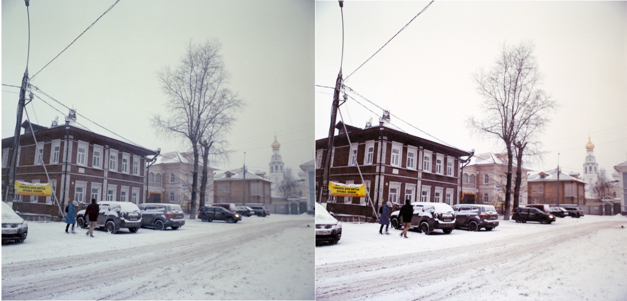

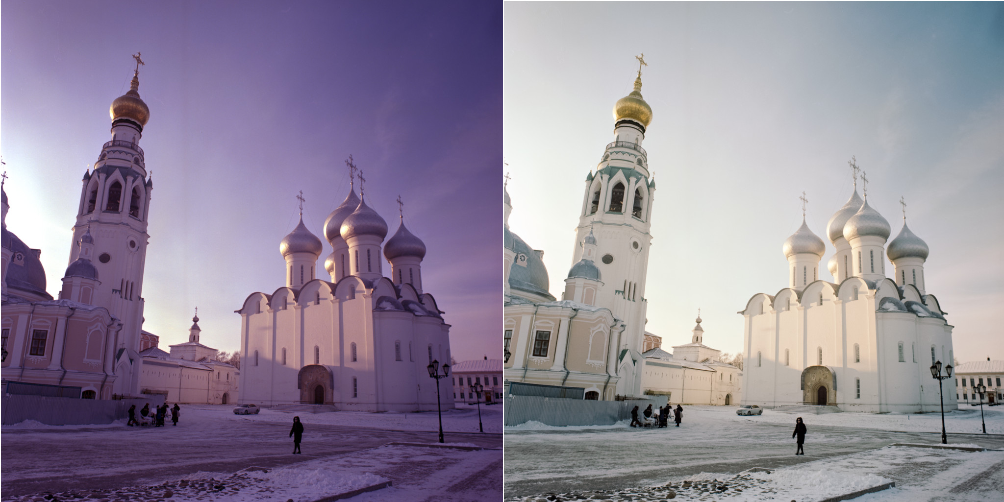

these "purple" images ARE NOT the final images. I didn't write that. These are a first output of CP. They are wrong, but close to true, contrary to the overexposed and washed NLP first output. I'll show what these purple pictures are almost there.

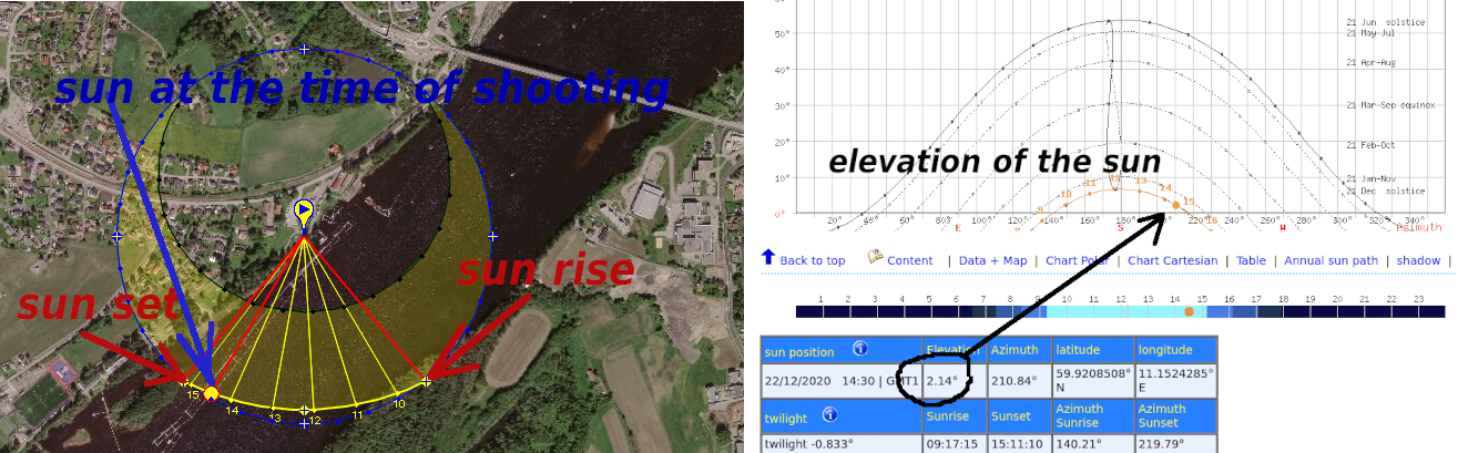

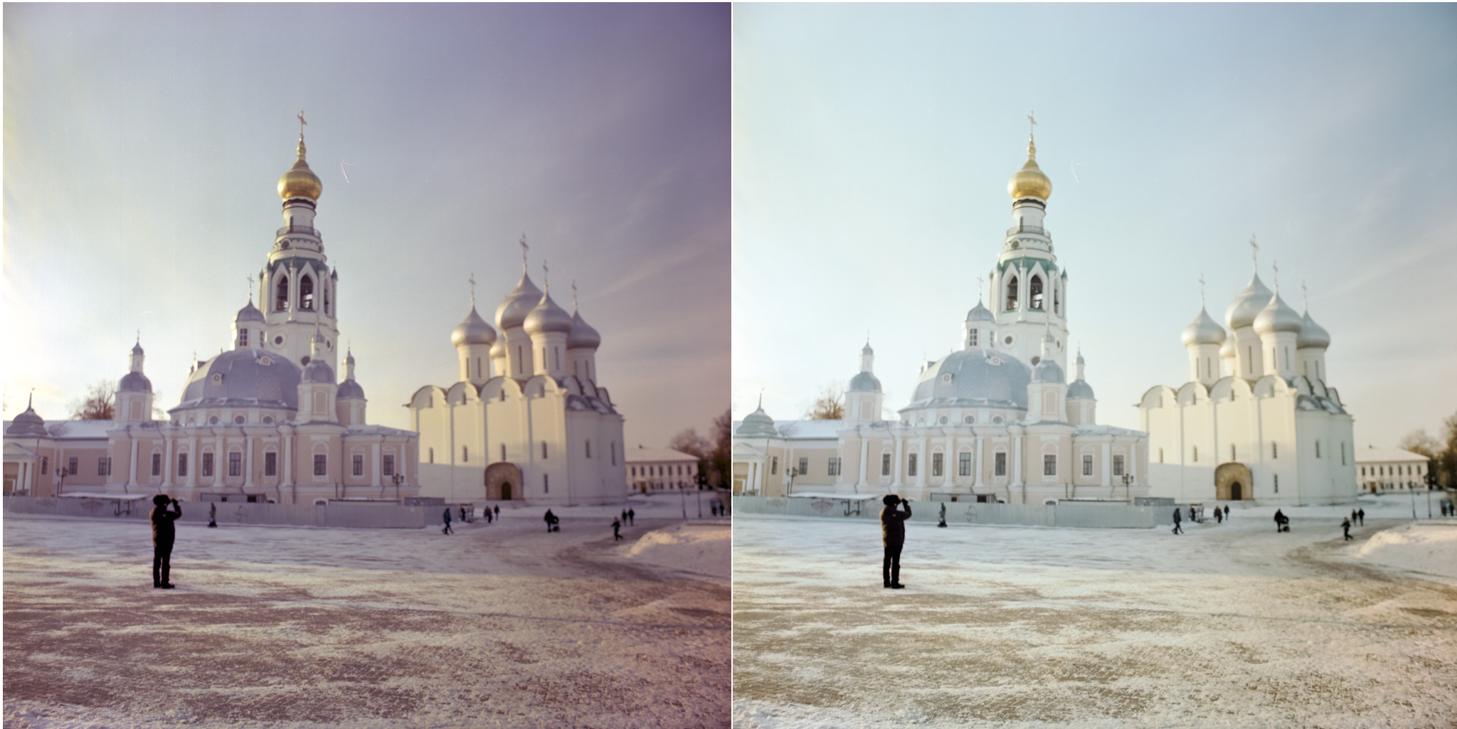

golden hour:
my english is bad, but whatever it is in english, it's about the moment of the day when the sun is getting down, still up over the azimuth but low enough that, when the sky is clear, it produces a more or less golden shining.
for instance, in pictures:
before Christmans I took an old camera I wanted to test to a place nearby. It was I think the 23 dec. and around 14:00/14:30.
The astronomical map of the sun movements this day, time and place, projected over a satelite view (oriented North) shows the point where the sun rises, it's path from East to West (yellow arc) and the point where it sets. The rays show the direction of main illumination, the small arrow in the centre of the circle is pointed at the area where I was taking pictures from. Beside the sun path, its elevation matters, and this time of the year, around winter solstice it is very low:

The negative is burnt by the sun:
there are different interpretation in positive inversion. For instance this:
or this:
so, by "golden hour" i meant this position of the sun.
now the very purple picture of the cathedrals and towers were taken at a similar moment. It was the 28 dec. 2019 (last Christmas) around 14:00 to 15:00. Vologda is at the same latitude than my place, ~60N.
The map of the sun position and path, on the city's map and the position where I was shooting from:
here i draw the position of the building in the purple photo, relatively to that satellite view:
of course the sun isn't hitting directly like in the case of the picture taken by the river, because there are buildings in the city and the kreml itself that do partially block the most lower rays. But in this purple picture we can see on the white Sofia cathedral the line light/shadow. The square is partially shadowed.

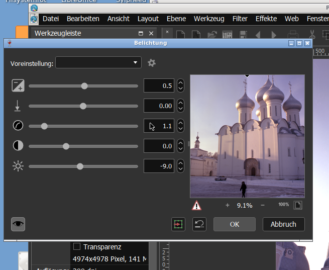

The purple picture is wrong but not far because the real sky was deep blue darkening, there's a gradation from purple to blue.
i can do it in ColorPerfect panel but I'll show in a generic colour balancing tool, here in Photoline (I run CP inside Photoline). The tool has a preview windows, vertically split, showin the before/after:
I will just push to the Green, away from the Magenta:
that's almost it ... see purple > blue.
I can call the exposure tool also:
in order to get most possible close to what was the real life, I can compare with the photos I took just before and after, but basically something like one of these two, there in the middle, where purple is the CP first try and white the NLP one:
in short: purple was no problem there, it was just about moving away a veil, and the general mood and structure of the picture was there.

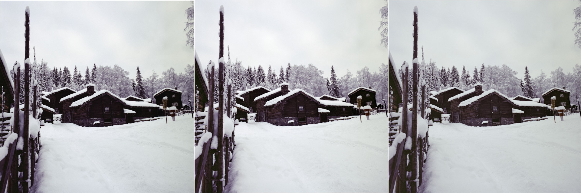

so follow up about comparison NLP (Negative Lab Pro) and CP (Colorperfect). Four negatives, default unmodified output of CP on the left, of NLP on the right. On all this roll there is some color aberrations here and there mostly by some edge, I guess because I wasn't careful with agitation, or chemicals were getting exhausted, but it doesn't affect much the whole image nor the comparison.
this https://yadi.sk/i/eMpXFnS_u_T1Mg
CP needs some correction, but NLP has blown exposure/luminosity, alight bomb
now, less spectacular:
https://yadi.sk/i/rjXBZQ1u-a1VmQ
the NLP is too harsh on the whites and on the colors. First thing that hits: you can't have this level of luminosity in the snow on the ground with this kind of sky. This is a snowy day, a bit foggy, light is dim, that kind of reflection in the snow isn't possible.
Then details, it's clearly truer on the left side, even if not perfect, needs a bit adjustment.
another detail, with CP the footsteps are visible, but very faint in NLP.

This, to me, is an indicator of something not done properly inside of ColorPerfect. It does not need to know the emulsion. Its purpose is to be a "digital paper". Just like RA4 paper does not care about emulsions, neither should a color inversion algorithm.
color inversion algorithms from digital camera scans DO use the "emulsion" characteristics ... this is what they boast in their advertisements "we have now in the new version a gazillion of further fine-tuned camera/sensors (and lenses!) profiles" .... The "emulsion" is the combo sensor+graphic processing embedded in the camera. If it's a scanners scan, then you have to set the Vuescan/Silverfast profile
print to RA4 is a photo-chemical process, inversion in software is a digital process. These are processes of different nature.
Even without getting into this, different films/emulsions do have different rendering, ie. their photosensitivity is different, .ie they use different RGB matrix. Ektar-100, Portra-160, Agfa, fuji, Lucky, etc.
the idea with the way CP works is to try to be hi-fi relatively to the film characteristics, which do indeed produce different renderings, exactly like when you make a RA4 print of Ektar-100 vs Lomography-100 for instance.
But then if you process some negative in CP which doesn't produce the expected result and you keep facing a cast you can't get rid of, then you just create an ad hoc film/emulsion profile, ie. you just use the gamma tools, store it and load it next time you process same emulsion. So in fact film emulsion profile isn't mandatory, but requires just more tedious manipulation on lower level parameters, which can be avoided by already making this step in beforehand film profiles.
these algorithms, NLP, Grain2Pixel, Filmlabapp, CP Negmaster, they all make assumptions before or after.
