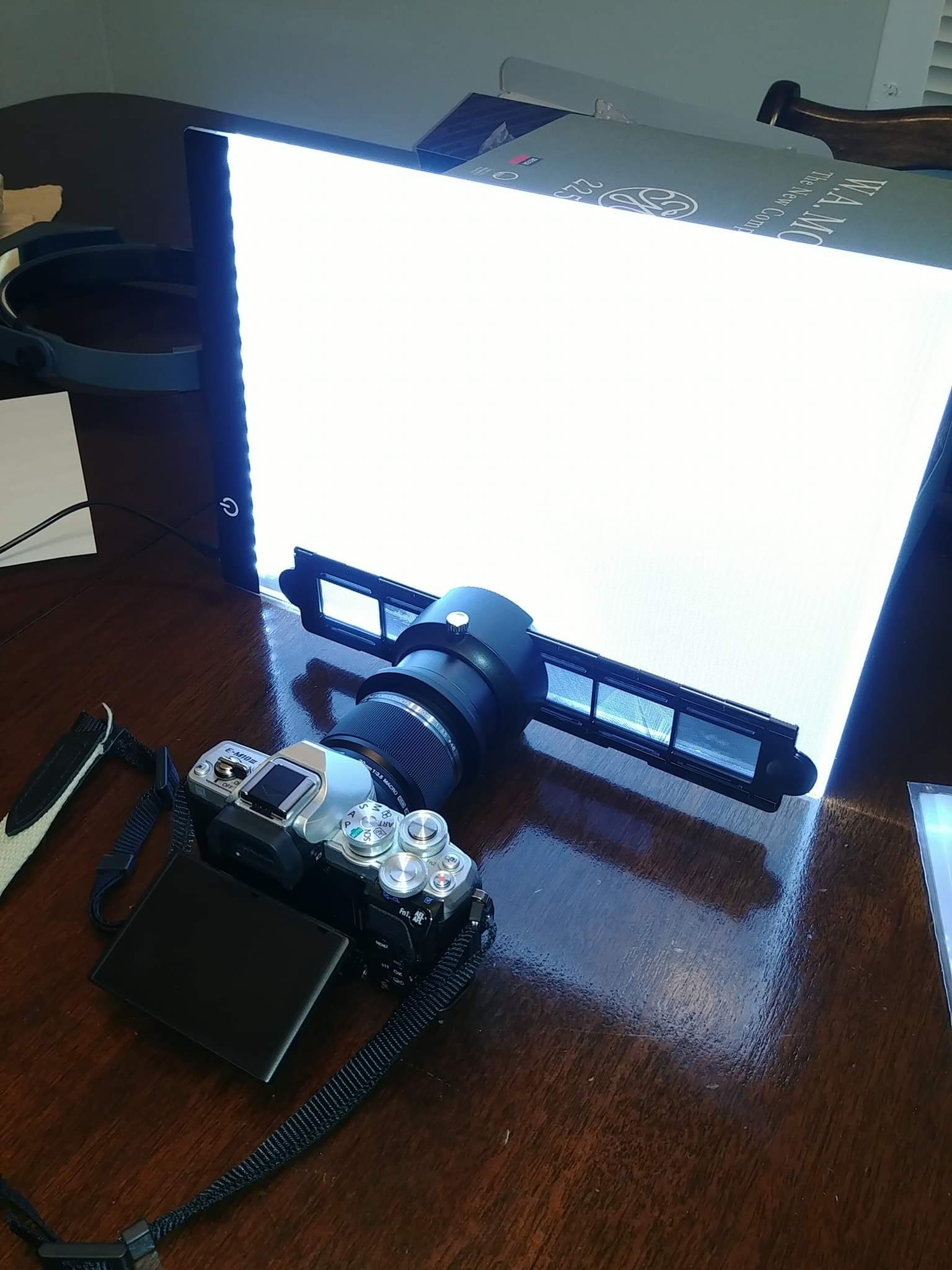

Separately, I attached a pic of my scanning rig. It consists of my camera with the Nikon ES-2 digitizer set ($125) a step-up ring to match my macro lens to the digitizer and a cheap ebay light box / tracing light.

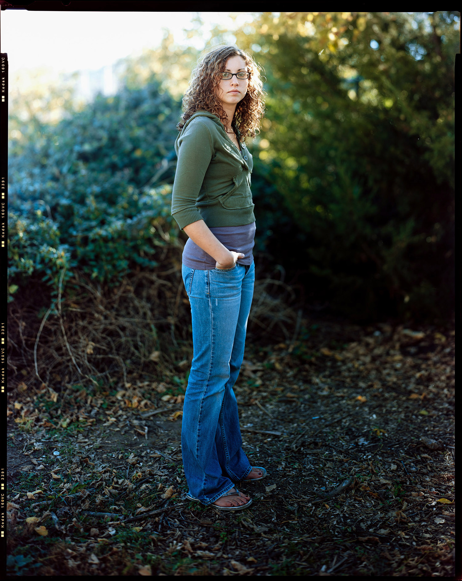

8x10 Portra 160VC - 300mm 5.6 Caltar - Scanned with an S1R in pixel shift mode and converted with NLP plus minor tweaks.
