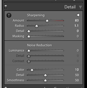

The Negative Lab Pro plugin has some basic sharpening settings which the developer describes in the <NLP Users Guide> as:
Sharpen: Leave as Set
new in v2.1) This will leave sharpening at whatever the user or lightroom as set sharpening at. Essentially, NLP just lets you manage it. This is the new default sharpening.
Sharpen: off
All sharpness settings are zeroed out. This is useful sometimes if you are working with scans that had sharpening already applied in their original software.
Sharpen: Lab
This produces beautiful, soft sharpening that is brilliant for skin tones and gives subjects an almost 3D appearance, while minimizing noise and grain. Great for portraits, or fine-grain films, like Portra. It is based on the default output of Fuji Frontier lab scanners. The sharpening scheme focuses on edges, with a mask to prevent sharpening unwanted grain or noise.
Sharpen: Scanner
This produces gritty, textured sharpening, that accentuates grain and noise, and is popular in lomographic photography circles. Great for street photography, black and white, or anything were you want a gritty vibe.
NOTE: Both of these sharpening schemes are based on RAW dslr scans, and the effect may vary if using a non-RAW or flat-bed scanned negative.
Leave as set (for me, the Lightroom Default settings)
Lab - he mentions a "mask" for this setting, but unless there is something going on outside of the Lightroom Detail tab, it uses a combination of Color Noise reduction and reducing the Sharpening Detail rather than using Lightroom's Masking slider. I sometimes use this one as a starting point, but my camera copies often benefit from increasing the Radius to 1.4-1.6.
Scanner
