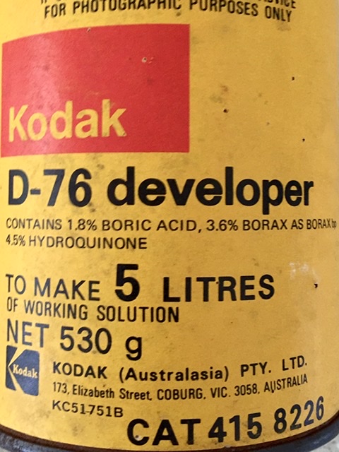

I noticed on Ian's web site a Kodak formula for D-76 based on the Australian MSDS. Maybe not now, but in times past, the Australian MSDS docs had more detail than those in other countries, presumably because of local regulations. I told this to Bill Troop years ago and he found it very useful. I wonder if the "Australian" D-76 formula is actually closer to the "real" Kodak D-76.
(yes, I know that MSDS is not the formula but still sometimes useful)
I noticed on Ian's web site a Kodak formula for D-76 based on the Australian MSDS. Maybe not now, but in times past, the Australian MSDS docs had more detail than those in other countries, presumably because of local regulations. I told this to Bill Troop years ago and he found it very useful. I wonder if the "Australian" D-76 formula is actually closer to the "real" Kodak D-76. (yes, I know that MSDS is not the formula but still sometimes useful)
John, I have no idea how old this can of D76 might be... it’s been a long while since Kodak left the Australian market!
