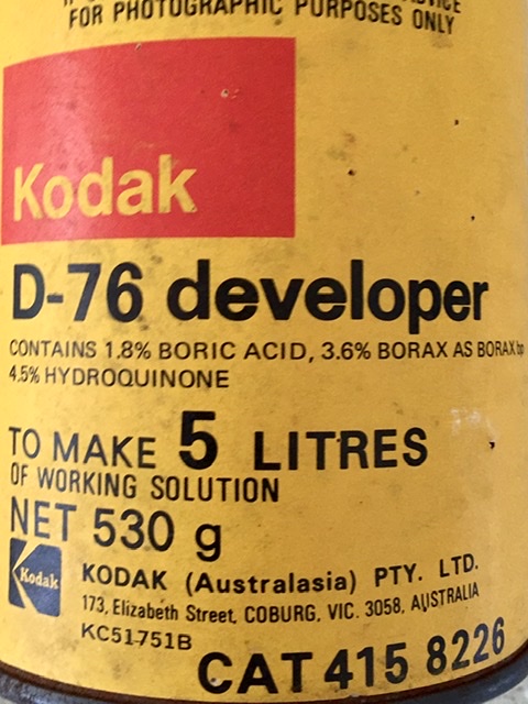

I noticed on Ian's web site a Kodak formula for D-76 based on the Australian MSDS. Maybe not now, but in times past, the Australian MSDS docs had more detail than those in other countries, presumably because of local regulations. I told this to Bill Troop years ago and he found it very useful. I wonder if the "Australian" D-76 formula is actually closer to the "real" Kodak D-76.
(yes, I know that MSDS is not the formula but still sometimes useful)
It's quite possible the Kodak Australia MSDS & Bottle formula is close to or even the current version wch is know to be somewhere between the original D76 formula and D76D. Some countries not just Australia required far more accurated MSDS listings than others but that seems to have been relaxed.

Fred, what is the character after the words BORAX AS BORAX?

Also, I noticed that the contents on the Aust can are percentages, and fortunately the total mass of contents is shown (530g), so the amounts for 1L of stock, the amounts can be calculated, as Ian has done on his web site.

agreed; our Photography beginnings do back a long way... a simpler more coherent, respectful and somehow a happier time! Thank you for your walk back through your Kodak Melbourne memory lane experience. How the mighty has fallen and all by their own hand too...! I’ll pop out to my studio/darkroom in the morning to check the reference to Borax on the D76 label and get back to you then with more detail. Take care...

Strange but the empty 5 l can of D-76 I have on my desk as a penholder has a different Cat number: CAT 501 0699, and is made in France by KODAK-PATHÉ.
On the bottom there is a number stamped: 801 60 88, and no mention of Borax or Boric Acid, just a warning for Hydroquinone...
John, didn’t need to go out to check. I had a look at a different image taken at the same time... the Borax reference Is “Borax as Borax bp”. The term “bp” indicates boiling point and thus Is probably another method for qualifying the Borax as anhydrous.

Philippe, the labelling difference is most probably the result of national label regulation as pointed out by @john_s but then again, D76 formulae published from time to time have revealed slight differences from each other. Grin, at least my can, sadly, still has D76 in it but good on you for keeping the film craft faith every time you reach for your pens! Take care...
In theory, yes, but if you do the math, you'll notice that this deviates quite a bit from the various formulae out there.
1,8% of 530g is 9.54g boric acid (more or less 2g/l)
3,6% of 530g is 19.08g of borax (almost 4g/l)
4,5% of 530g is 23.85g of Hydroquinone (almost 5g/l)
The total of boric acid + borax + HQ is 52.47g. This leaves 477.53g for the rest. Assuming 5*2=10g Metol, we are left with 467,53g for sodium sulfite plus whatever chelating agents included, meaning 93,5g/l. Could this mean that this is close to 90g/l sulfite and the rest something like sodium hexametaphosphate?

"bp" often used to mean Brithish pharmacopeia (spelling?) an indication of a certain degree of purity, I think. I don't know why it would be on this label because Kodak would select purities for all components.

Interesting. I think I read once that there was something that allowed all components to be in together so that the metol would dissolve without having to be dissolved separately first, I think ID-11 is sold in two parts to address this.
The developing agents were coated with I thinksulphite to allow the single bag packaging.
The Australian pottle says 530g Net Weight, but also indicates the higher level of Borax as well as the Boric acid. Even origibal D76 would be 545g for 5 litres and that's excluding Sodium tripolyphosphate. However in an early article where Kodak publishe D76d (at that point un-named) they mentioned it's increased activity, there's two ways to correct this, cut development times compared to plain D76 or slightly increased Dilution. It would appear this is done here by reducing the total amount of chemistry (by weight) during packaging, this would reduce production costs slightly, well a not insignificant 7% approx.
When Agfa and Gevaert merged we saw something similar with Rodinal where the old formula had no free hydroxide, to save costs the pH was increased and the level of p-Aminopheol dropped, making a saving of around 10%.
