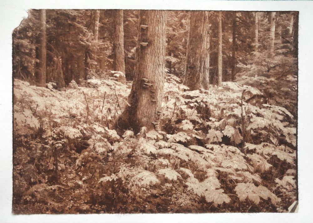

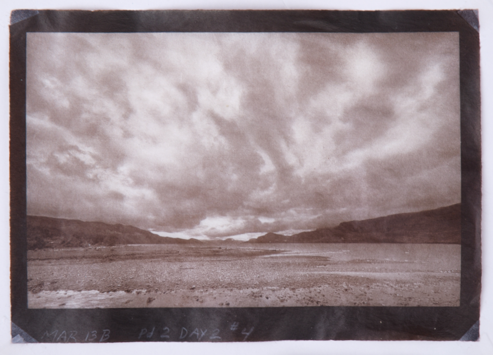

First successful Palladium toned Argyrotype of my go-to test image.
Mike Ware suggested using a lower strength toner for argyrotypes than you would with kallitypes. Yesterday I tried Sandy King's regular strength palladium toner at a 10 minute time, but things went weird with lower contrast and a neutral print tone.
This print was two drops of Sandy Kings Pd toner (2 grams sodium tetrachloropalladate II hydrate in 10ml distilled water) into 200ml of distilled water with 1g citric acid, and I gave it 5 minutes instead of yesterdays 10 minutes.
Another change was to use 20g sodium thiosulfate in one litre of water instead of 25g. Also reduced agitation in the fix by about a half. The toned print is *crisper* in fine detailed areas, so I figured the toner changed the shape & surface structure of the print grains and figured the fixer might have reduced print contrast somewhat?
Anyways...happy with these results and can now charge forward to make actual prints from some 40+ years of backlogged images.
This one isn't a straight print...the darker areas were lightened with a boost in contrast and the Foo Dog got a little burn on the top of his/her head.

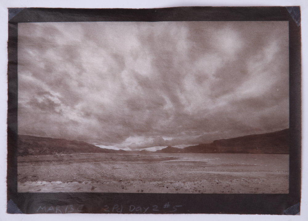

This one should do the trick...straight import:

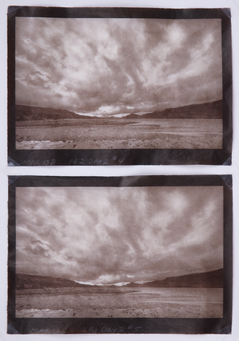

Steaming test.
Ware suggests a humidifying chamber at 100% humidity for 30 minutes at 20C, but also mentions holding the print over 40C water for 30 seconds. Ignoring that completely, and in the spirit of taking things too far to see what happens, I held the print over a just under boiling pot of water for 30 seconds. His warning of over steaming causing fog was spot on.
Must also confess that this was day two with the same two drops of Pd toner, and the last print was 5x7 number 5 to be toned (200ml total volume) just to see how many & how long it could last with a cover over the tray at night. Mighty happy about the results as it will reduce costs and allow toning of test prints. (Will use fresh toner on 'real' prints).
Steaming indeed removed, not just reduced, graininess in the subtle cloud tones. Suspect appropriate steaming will remove the graininess and leave the pure whites intact.
There was one aspect of this extra step I wasn't ready for. Back in my art school days I absolutely fell in love with making Raku pottery. Something about the primal, elemental, natural forces at play mystery of not knowing what the pot was going to look like after pulling it from the propane torch & stack of fire bricks kiln, then stuffing it into a pile of straw and dead leaves. Steaming had that same sort of feel. Will be interesting to see if otherwise identically exposed and processed prints all differ in subtle ways.
First print is both, second is not steamed, the last is (over)steamed. The small centre cloud (just above the distant island) was left pure white as part of the test.

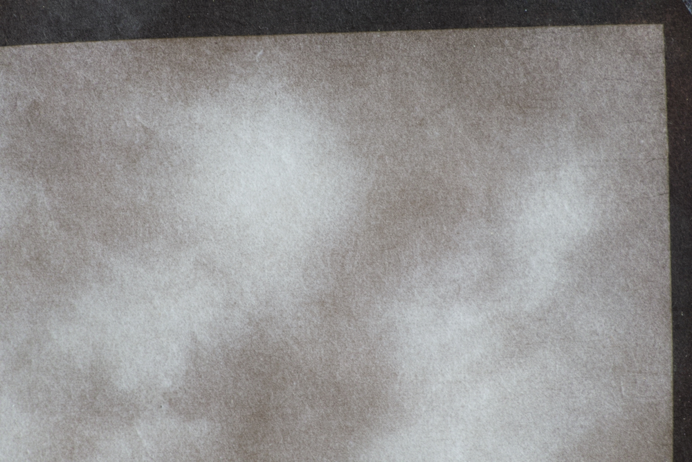

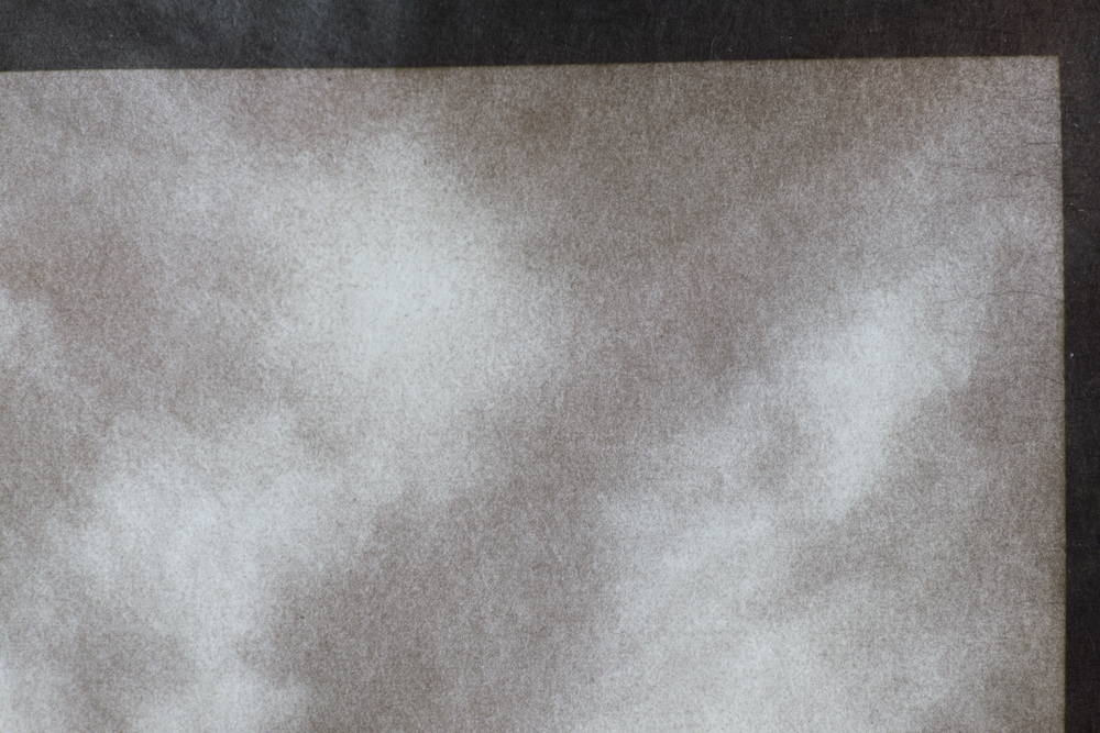

Here's the top right corner of the Pd toned argyrotype (first one) and the same corner of the over-steamed print in post #35.
When held in the hands at a comfortable viewing distance, the steamed one is smooooooth.

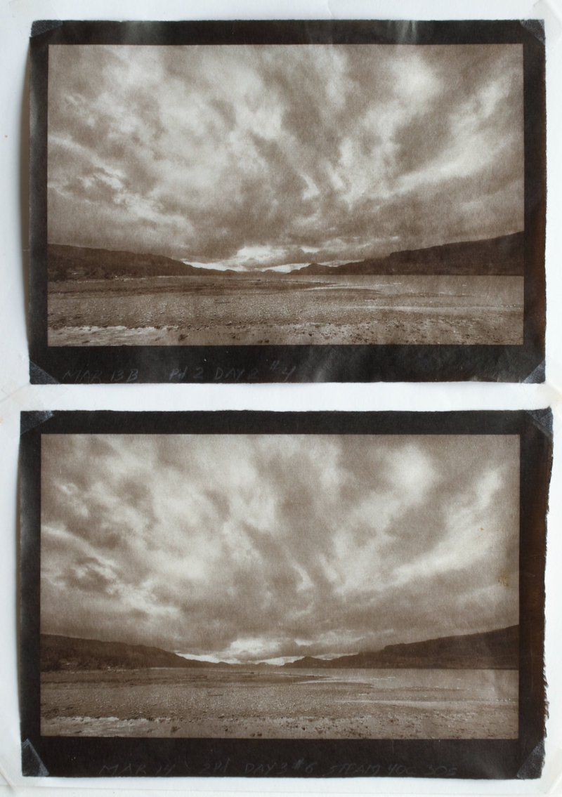

Steam and Pd toner longevity tests.
The top one is from yesterday with todays print toned in three day old (two drops Pd in 200ml distilled water) and steamed following Ware's 40C for 30 seconds...it was toned for the same 5 minutes as the previous ones and is 5x7 number 6 through just 200ml of toner. Crazy that it's still working, or at least trying to work!
Held in the hand, todays print isn't as smooth as the over steamed print from yesterday, but 'feels' smoother than the original.
Because the toner is starting to run out of gas (lower tones not as deep) I won't be making a judgement on steamings effect on anything lower than around print value VIII. It does seem to leave pure white alone and slightly add density to print values up to IX & 3/4 while raising value VII or so? Then again, weirdly, it seems the same tone in two different spots in the original sky went different directions in the steamed print, where one went a bit darker and the other went a bit lighter. Definitely worth exploring in more detail later.
I know it's bad form to be testing two things at the same time, but it's early in the game, the race is long, and I'm having fun 👍
Top print is the original, bottom print is todays Ware suggested (but maybe not executed well) steamed one:

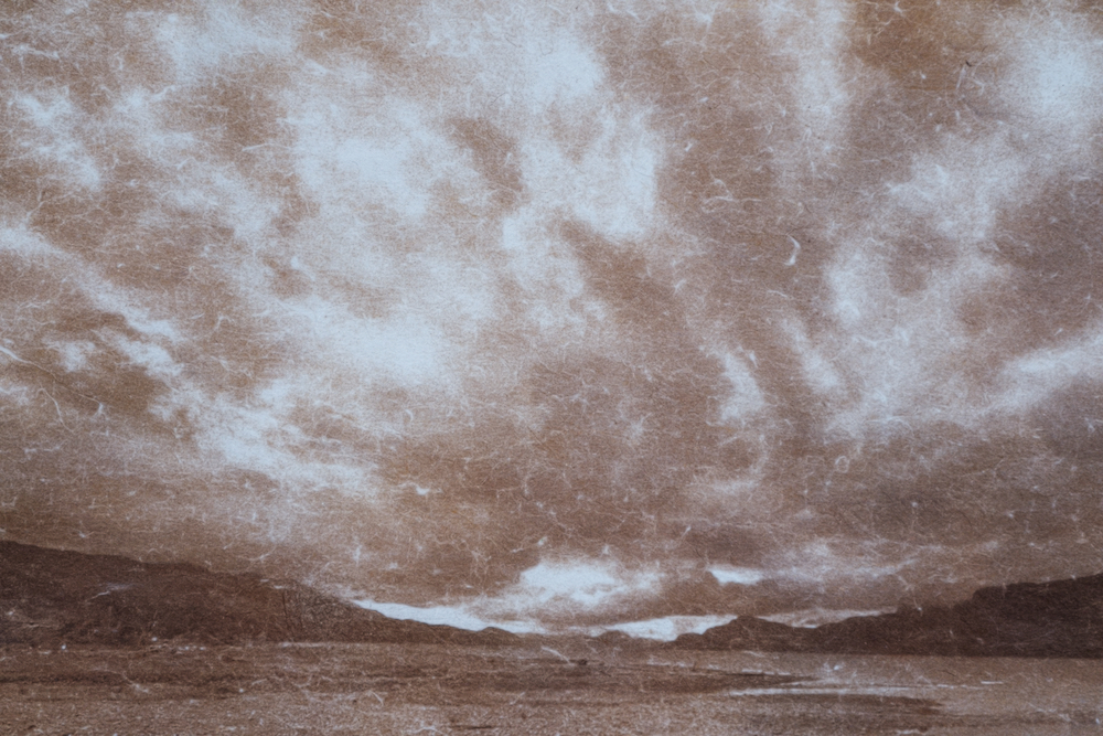

Tip for the day...order one or two sample sheets of new papers, instead of larger amounts.
I ordered five sheets of this 43gsm handmade Kozo. Yuck! It won't go to waste as it can be used as a backer sheet or for hinging, but I won't be laying any more sensitizer on it.
For those with TWEEN knowledge...would that have caused the 'fibrils' to absorb sensitizer? Haven't bought any TWEEN yet because the papers I'm using are so thin, I didn't think absorption would be a problem.

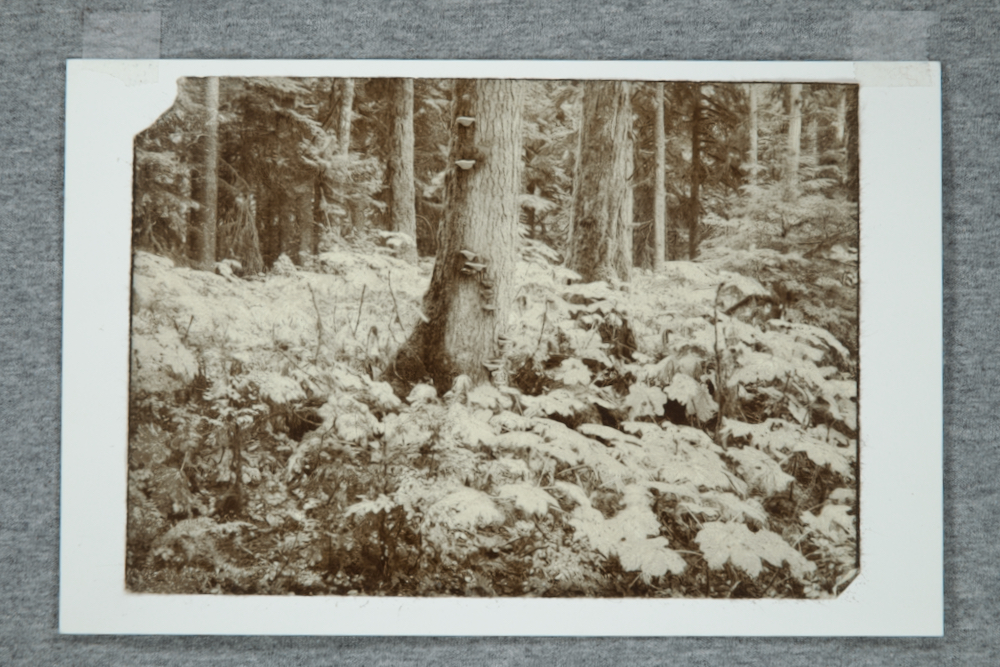

This is an untoned 'work print' (no digital negative heroics beyond applying a correction curve and initial editing of the colour image) on 21gsm Gampi. Was a bit rambunctious in processing, ripping off the top left corner and folding over the bottom right corner. Have lost my touch with this ultra thin paper!
Think I've wandered down Argyrotype Road far enough. Much to like, but not enough for me to keep expending the effort needed to wrangle them into submission.
Heading back to the Salt Print Path...
Can't...seem to...let them...go.........

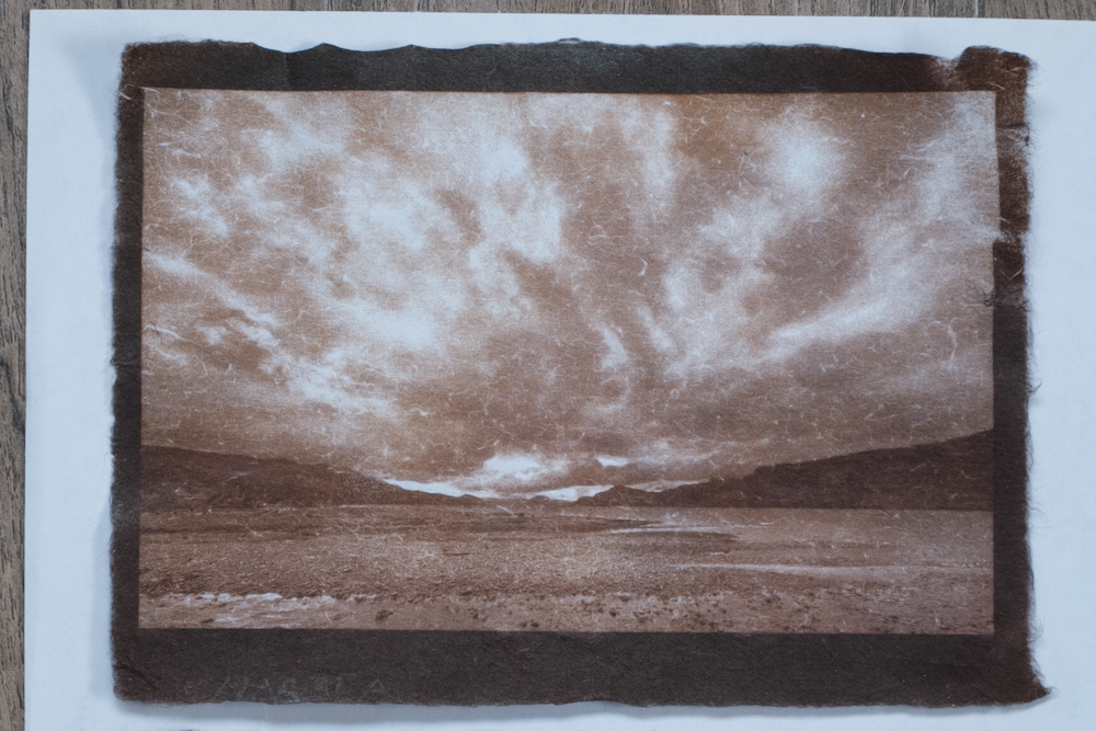

Wanted to see if toning in palladium would change my mind. This was toned days after making it by soaking in water, then in the toner, then washed. Not the recommended sequence, but good enough for a quick test.

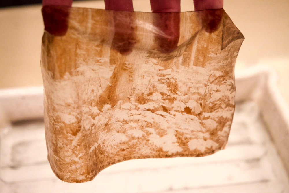

Thought somebody might be interested in seeing what 21gsm Gampi looks when wet. Shockingly thin, near transparent in the high tones, yet incredibly strong if handled properly.
Hard to get correct colours in uploaded photos. The palladium print isn't green-ish; more like a slightly purple leaning selenium tone. The Gampi itself is a bit warm, so the high tones get warmed by light bouncing off the cotton paper and coming back through the Gampi.

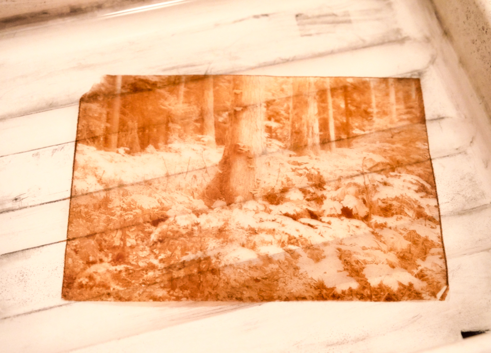

I'm finding Argyrotypes impossible to judge until they are fully processed, fully dried, and pressed onto white cotton paper using a temporary tacky glue.
Absolutely; I think the ephemeral nature of the object in that state is gorgeous!
What surprised me was how the darks and blacks behave; they appear weak and washed out when the print is dry, even if you hold it against a piece of white paper. It's only when the print is affixed to a white support paper (during testing I've been using a repositionable craft adhesive) is when the dark and black areas 'pop'.
If any light is able to get under or come back through the Gampi, the blacks are weak, but the instant the photo is firmly attached to the white support paper, they drop. This is also when fine details appear.
