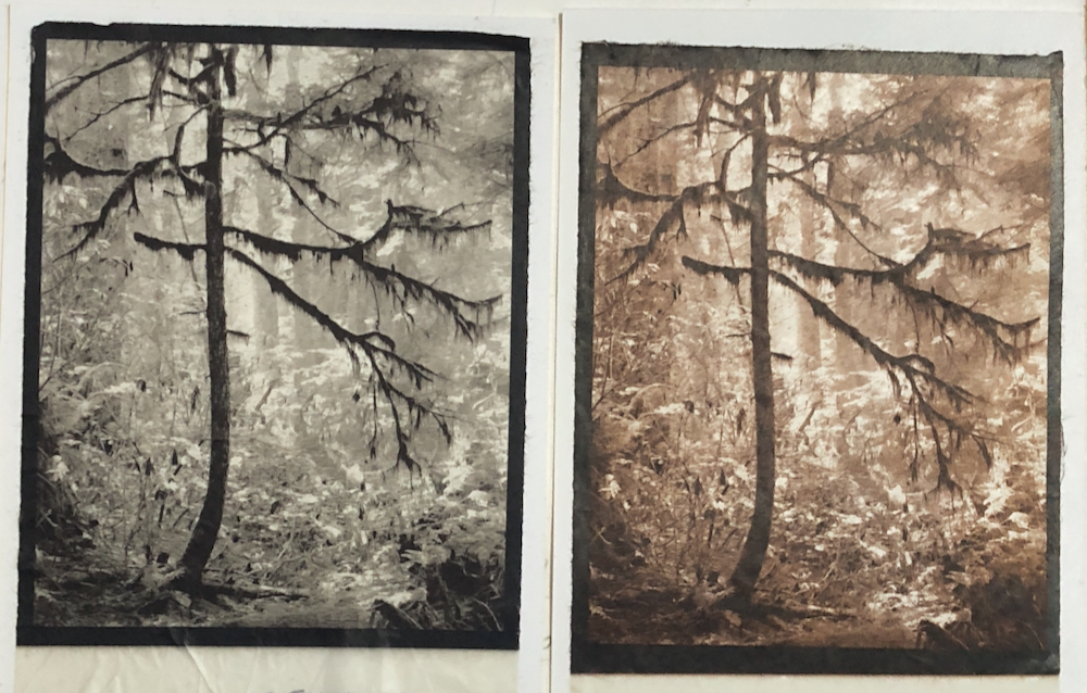

Recently got some platinum to test against palladium.
Used 3 drops of palladium (20% solution) in 200ml water with 1 gram of citric acid and toned for 8 minutes. The platinum toned print was also 3 drops for the same time.
Looking at the unexposed bottom edge of the prints, the palladium toned one is darker...maybe taking up a slight stain from the palladium toner itself? The platinum toned one doesn't have a stain and matches the untoned control print.
There wasn't as much of a difference as I was expecting. The platinum print is cooler for sure, having brighter high tones as well as better mid-tone local contrast. The palladium print appears to have a deeper black. May need to increase drops if using platinum alone, to get blacks deeper.
Have tried one with 2 drops platinum and 1 drop palladium which is drying right now. Attempting to find a combination with the best of both worlds...
iPhone snap. Please disregard uneven lighting and wrinkles.

Looks nice!
Sounds like my experience with Pt - great tonality and separation in shadows and highlights, but maybe less Dmax and contrast than with gold. And the color can be very neutral if there is enough humidity during exposure.

Thanks.
Back in my enlarging days Ansco 130 had too much snap & sizzle for my tastes, so have preferred longer scale, less punchy images for a long time.
The 2/3 Pt 1/3 Pd print was nice. Will do a 50/50 one tomorrow, just to be sure. The Pt sure did reveal some extra subtitles which aren't there in the fully Pd toned print.

Also, as can be seen by the untoned print below with the same exposure and processing as the Pt toned print beside it, it looks a tad dark in the mid-tones. Toning seems to intensify the blacks, lift the mid-tones and shadow detail, improve local contrast overall, and bring subtle details in the high tones.
Another bad copy photo:
