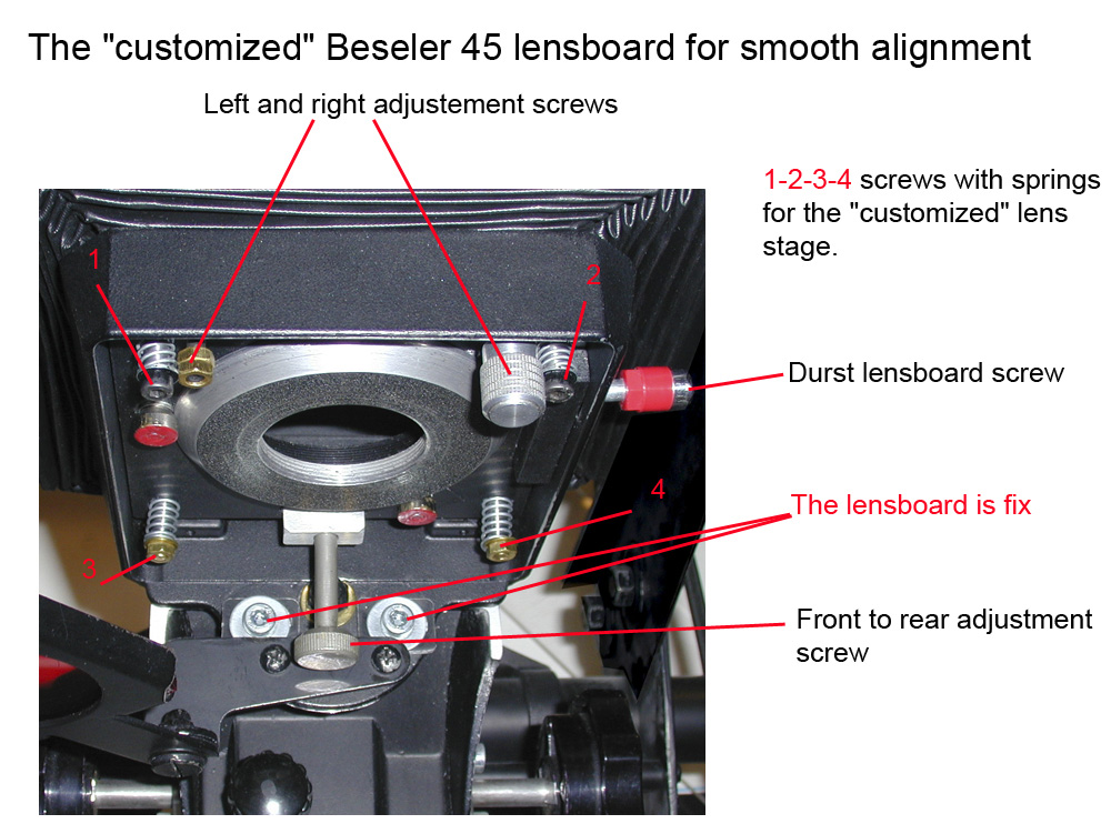

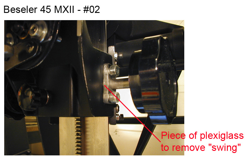

I have two Beseler (45 MXII & 67 C). The alignment is not easy because their original crafts are worse than Omegas or Durst. I make many modifications to remove mechanical problems, particularly the movement of the optical carrier, which no runs regulary. The positionment of the negative carrier is also important (replace the original carrier with 2 pieces of glass and compare !). After, and only after you can use an alignment tool like Versalab or Zig Align.

computar
Sep 14, 2006
Some "customs" to my Beseler 45
two pics to explain my mechanical modifications for lens stage alignment.
