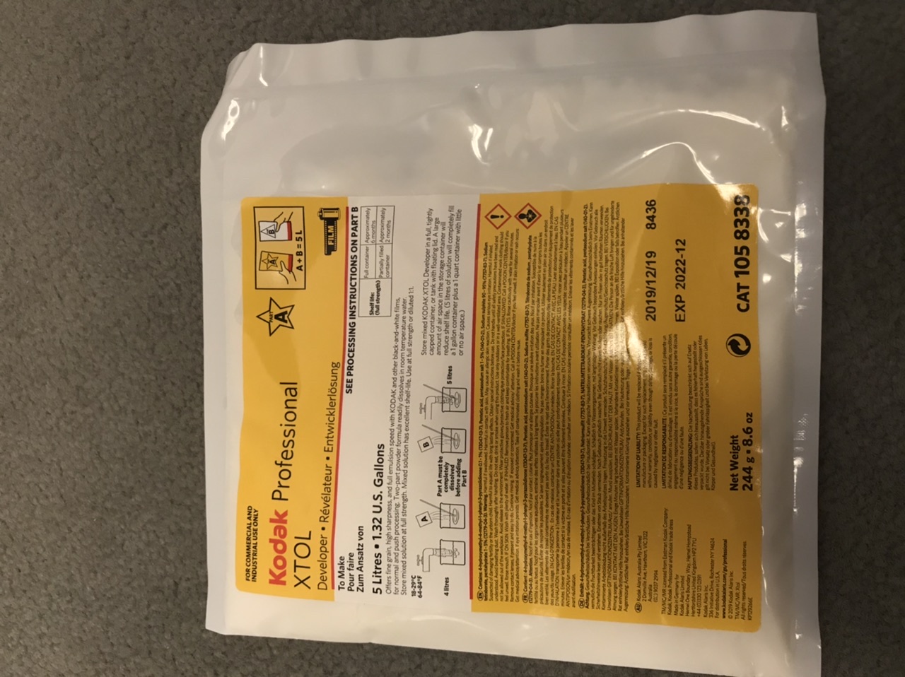

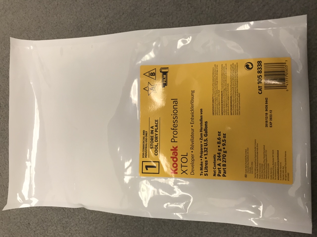

I just received some replacement packets of XTOL for some bad batch packets that made it into my queue of XTOL to use And there are some differences.
the bad batch has the A and B backers taped together and the two packets are the newer white plastic bags.
the new replacement XTOL has the same two white plastic A and B bags, but instead of them being taped together, they’re both put insider of another larger white plastic bag that is also sealed (see crappy cellphone pictures above), interesting. Makes me wonder if the single bags taped together were stressing the welded seems enough that they weren’t as airtight as initially thought.

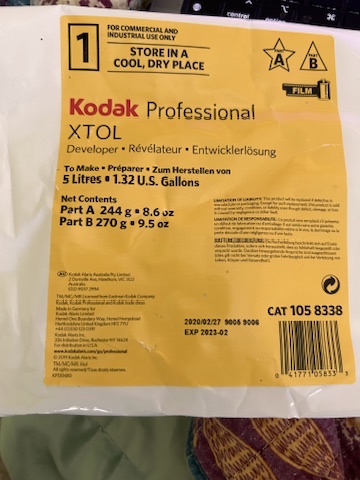

I just mixed a new batch of Xtol and I did a roll yesterday, came out thin, undeveloped and full of crapola! I chalked it up to I messed the time (which I did). Today I did 2 rolls of P3200 ( I did not mess up the time this time). Same thing. Granted it's a tad expired, 2/23 but I never had this issue before. So bad batches are still out there. Also part A never fully dissolved. I am wondering if the "old style" bag cat 516 0361 will be ok even if it too is expired 10/2020? Ugh. 3 rolls gone, poof! Has there been problems with newer batches? Thanks!

There's no reason to abandon Xtol - just don't use expired chemistry. It's 15 months past its expiration date, so....
Yes to not using expired chems, but it was one of the batches posted by Kodak as being bad, 2/27/2020. "If you have XTOL Catalog #1058338 with the following Date Codes: 2019/10/07, 2019/12/19, 2020/02/25, 2020/02/26, 2020/02/27".
