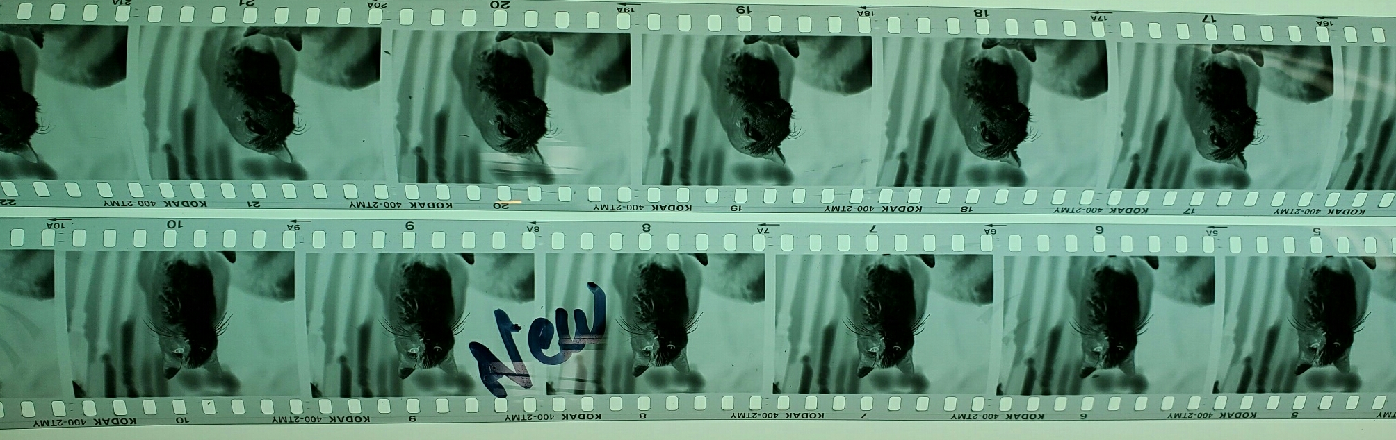

I mixed up my New XTOL the A side has the 2019/08/09 8317, B side is 2019/08/09 8318 exactly what Kodak Alaris posted. I shot a roll of TMY 2, Nikon F5, 5 frames / second of my nitwit cat Gus, sitting in a shaft of sunlight. In the darkroom I took scissors and cut the film in half. I processed 1 half in new 1 half in old XTOL. 20°C Jobo CPP3 6.5 minutes. I see absolutely no difference. I will attempt to attach a photo. This is on a fluorescent light table. The modified A side with zero dust is a joy to work with. B side, still dusty. Both packages were within a gram of the weight on the package using a German made Sartorius electronic balance. This is nice stuff. Package was sealed etc. I'm not doubting other reports only showing what I have. Picture of negatives shot with Samsung cell phone.
