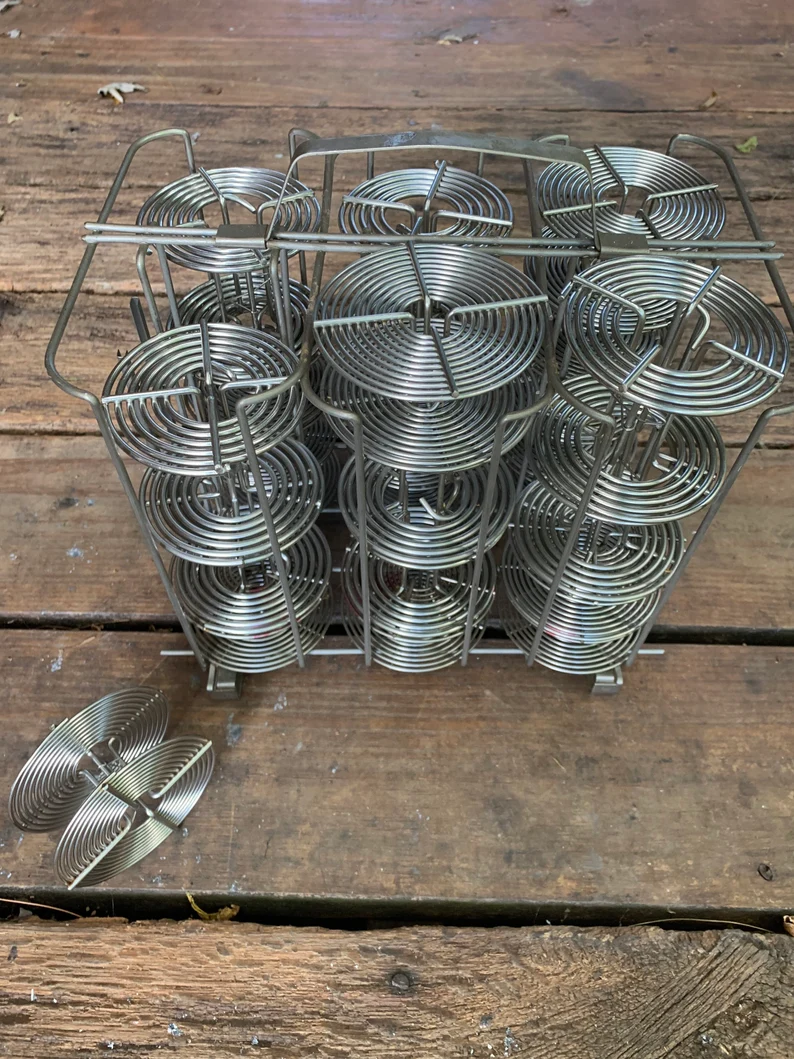

Historically, they were probably used most in big, multi-reel racks, dipped in and out of really big tanks in absolute darkness.
Something like this:

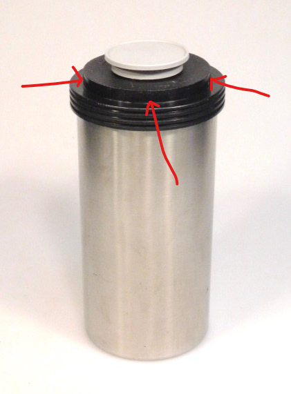

The problem with the Kindermann tanks that I use is the plastic lids. They are made of two parts and start to leak significantly at the junction point. Plus, they are no longer in production.

I hadn’t heard of those leaking before. For 35mm I’m still using the same Kindermann tank/plastic lid my father bought circa 1970 and it has never leaked a drop.
There are at least two types of Kindermann plastic caps; mine is pictured below. The arrows indicate the leakage points:
