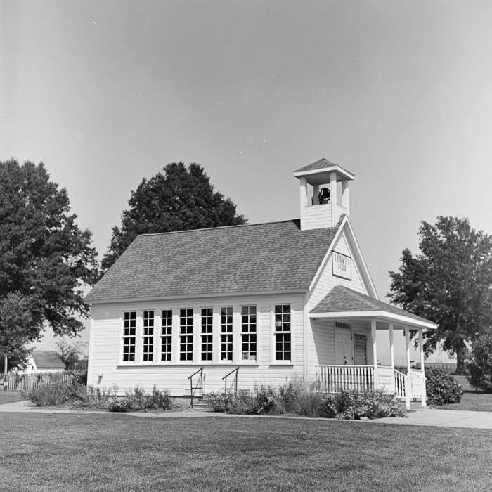

I am enrolled in a medium format photography class at my local state university. All analog, black and white, only. The photography professor says she has seen 120 negatives like mine before, and she thinks the uneven development of the negatives is due to over agitation.

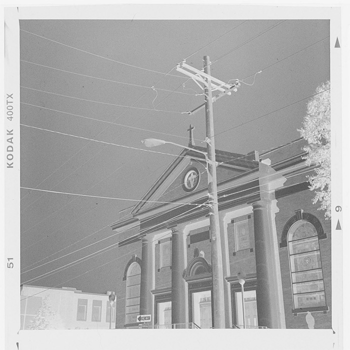

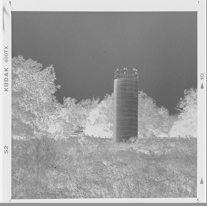

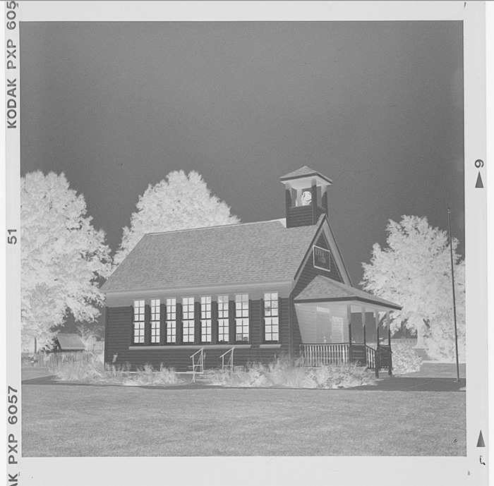

I will make one last attempt to illustrate the problem. The positive images shown below are inverted versions of digital photos taken of the negatives on a light table. No enlarger or scanner was involved.
View attachment 381479View attachment 381480
Yes again for what it’s worth I’m still seeing the same effects/artifacts as in your original negative images.
The effect is more visible in your more recent posts.
Which in turn makes me now think that the flow of developer is uneven - more at the channel edges of the reels, and less in the middle.
I'm thinking that your agitation is not sufficiently randomized - it seems to be imparting extra to the parts of the film nearest the spirals, and leaving the centre of the film less replenished with fresh developer.
Try increasing the randomness of the twisting and inverting part of your inversion technique.
Also try leaving a bit more air in the tank - the developer needs to cavitate more as it moves through during each inversion.

Thank you. I do twist the tank 1/4 turn before each inversion, but usually always in the same direction. Maybe I'll try twisting in the opposite direction every other time(?)
Up until yesterday, I have been leaving about 1/2-inch of air at the top of my 32 oz. tank. Yesterday, I filled the tank more completely, but I have not yet printed those negatives or tried to digitize them, so Il don't know if that had any effect.
It's definitely uneven development due to agitation problems.
120 film is finicky about agitation. You're seeing more development at the edges than the middle of the film. It might be overagitation, but again, might be underagitation. You'll have to put in the time experimenting with agitation techniques and find what works for you.
What you do know is that the edges are getting more agitation than the middle. Go from there and test.

Twist while you invert - just grab the tank with both hands, one on the bottom and the other on the top, and rotate your arms and wrists so that the top hand becomes the bottom, and vice-versa.
When you do that, your wrists will naturally impose a twisting motion on the tank.
And I wouldn't have tried increasing the volume - I expect that will tend to reduce the randomness of the flow.

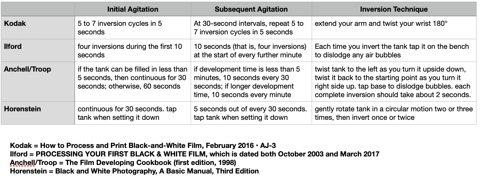

One of the more arcane recommendations I was given concerning agitation was each time after inverting the tank to rotate it in the direction that causes the leading edge of the film in the reel to be pushed into the liquid. In my experience the leading edge of the film almost always curls longitudinally to almost contact the next row it didn't seem it would have much effect but I've been doing it anyway.
A month ago, I thought I knew how to develop film. Since 2019, I have processed more than 40 rolls of 135 film without noticing any uneven development in my negatives. Over the years I have used a couple of different variations in the number and frequency of inversions, but my basic technique, per inversion, has not varied by much.
Considering that four different normally reliable sources offer different (and sometimes conflicting) advice about agitation, it's hard for me to believe that minor variations in technique should make all that much difference.
oops! posted before complete. edited to add:
I made the following chart to summarize what four normally reliable sources recommend for agitation ...
Anchell and Troop say any agitation must be for at least 10 seconds, and 5 seconds will not produce enough movement.
Trying to sort-of juggle these recommendations into some kind of aggregate, my feeling is, I have not been agitating enough. I have been starting with a 30-second initial agitation, but after that (based on a class handout), I have been inverting only two times per minute, which takes me only about 5 seconds.
The advice actually doesn't really conflict, in its essence.
The primary advice is to make sure that there is enough even but randomized movement of the liquid in the tank.
The way to get to that goal is much more difficult to explain in words or pictures than it is to show in real (or perhaps reel) life.
what developer/dilution are you using?
Exactly. You're being too gentle/cautious.
And quite likely, in a manner that doesn't add enough randomized movement.
The developer is sitting almost stationary near the centre of the film, while the agitated developer is flowing only in and near the steel reel channels, adjacent only to the film rebate.
