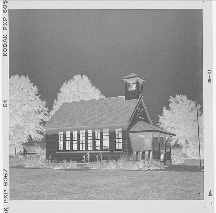

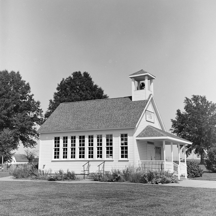

I am using a Mamiya C220 TLR which moves the film from bottom to top. The lighter areas of the prints are on the right and left edges of the scene, but not the top and bottom of my prints.
To my eye, the density gradient is less obvious on the negatives than it is on the prints, but here are examples. From the the edges of the fimstrip, the density decreases and gets lighter in the direction of the arrows.
On the prints, the lighter area is more noticeable close to the left and right edges (which would be the top and bottom of the photo of the negative, below).

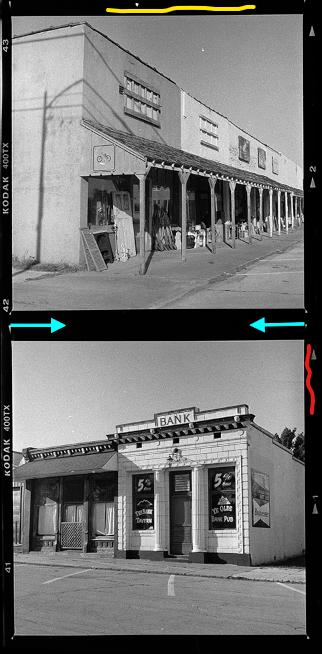

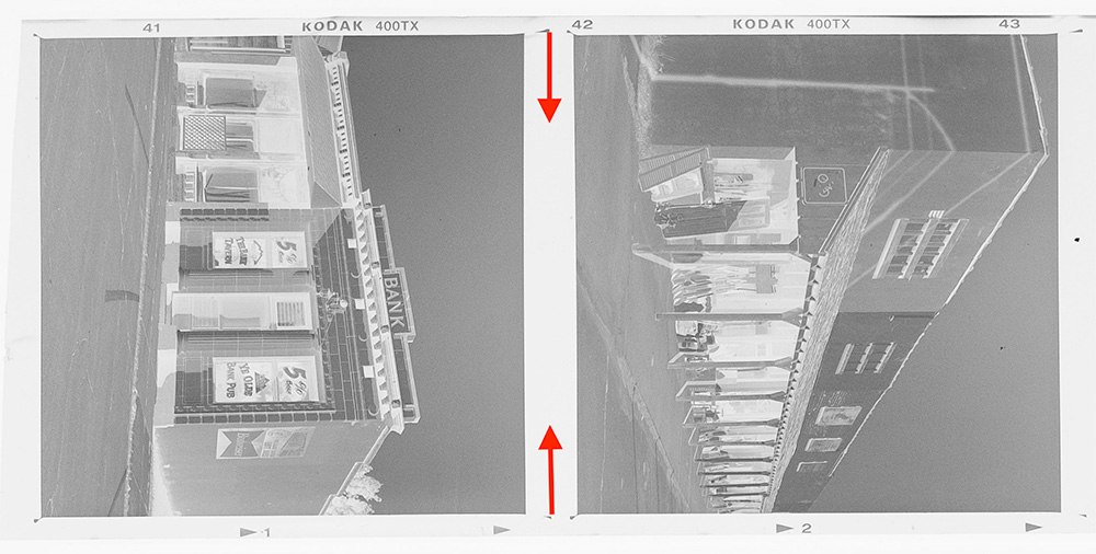

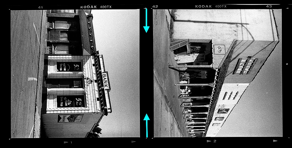

No, not me. The inversion I posted last night I made on my phone with snapseed. I just made another one with Gimp and had a closer look at it.
I drew in two wiggles.
The yellow one refers to the gradient in the sky, particularly the darker spot in the center. This looks like a perfectly normal gradient to me that was there in real life.
The red wiggle refers to a vertical (in this version), fuzzy dark band along the edge of the frame. A likely cause is a stuck air bubble in the reel that reduced the rate of development along this edge, creating a low density zone. Tap the tank firmly on the counter after pouring in the developer and after each inversion cycle to dislodge such bubbles.
Apart from the sky, there are minute density variations across objects of the same material in the same light, and there's no reason for me to assume these minute density variations are anything but real-world variations in reflectance.
Apart from the single suspected air bubble, these negatives look perfectly fine to me!
I'm not seeing enough evidence to decide if it's a problem with the negative or the print so I'll add two instances of the uneven edge in the sky one for the print and one for the negative. For the print could you be getting a reflection off your printing easel? I know the complaint is about pale edges, but if a reflection from the easel lands a little inside of the printed area and not along the outer edge the outer edge will appear to be lighter. And something to check with the camera, unlike many TLR's that generally only have light/dust seals at the catch and hinge ends of the door Mamiya's have foam seals that run the length of the door, so are they in good condition?

I will make one last attempt to illustrate the problem. The positive images shown below are inverted versions of digital photos taken of the negatives on a light table. No enlarger or scanner was involved.
Edited to add: The darkroom prints look very much like the positive versions which I have posted here.
