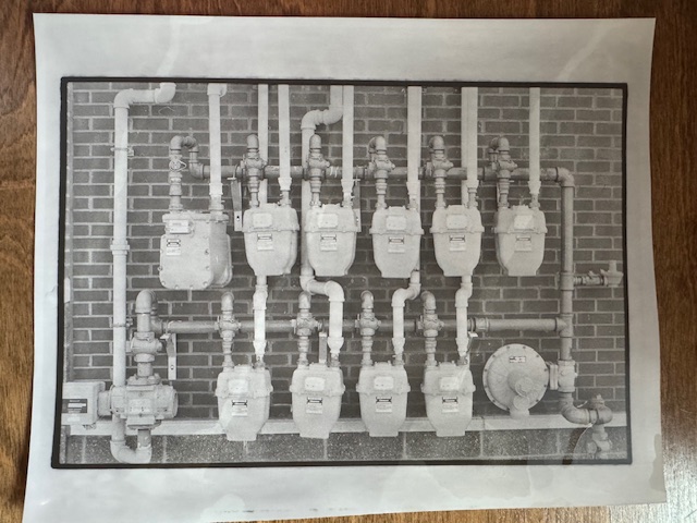

So, I did a test. The paper is Polycontrast II that I have marked as "Bad Fog" - which means unusable with any amount of restrainer added.
I chose a higher contrast negative. Seems that's probably a necessity. A subsequent test I tried with a lower-contrast negative resulted in a very low-contrast print. Not sure how it would work with contrast filters added. That can be tested later.
The first print was close to normal exposure for the paper (probably twice as long) and a long time in the developer
The streaks are water but the mottling is normal for this paper. I've fairly certain it has developer-incorporated and that usually means cow-pattern mottling.

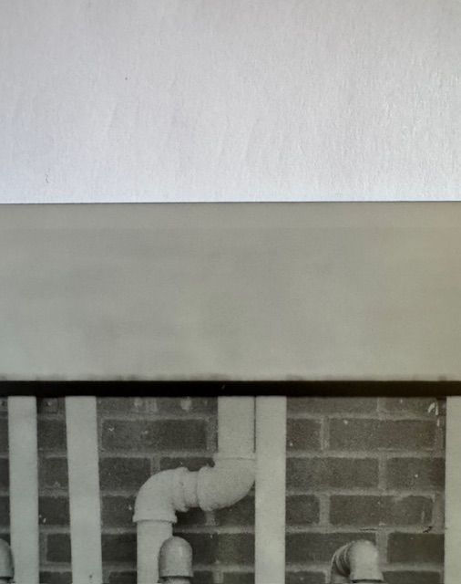

Top show the fog level:
White paper at the top. You can see where the easel blade covered the edge of the print (slightly less fog where the paper was covered during exposure). That fog is probably about half as dark as it would be in normal paper developer with added restrainer.

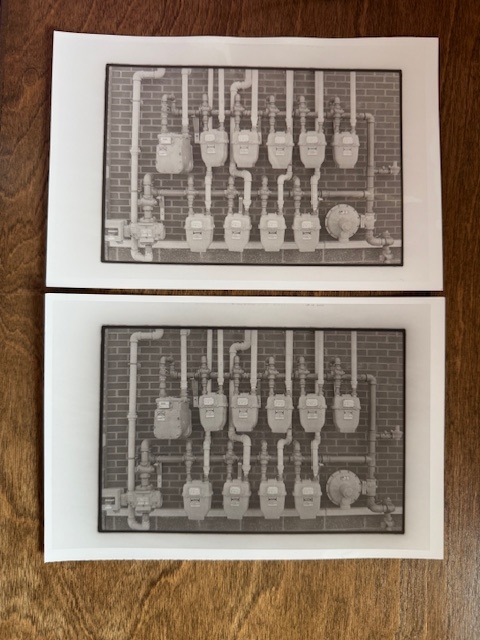

The next tests were with greatly increased exposure and reduced development time.
The top print received half the exposure the bottom print did. Both were developed for about the same time. I was attempting to pull the prints before too much fog appeared. The top print looks underdeveloped in person. The bottom print looks more normal.

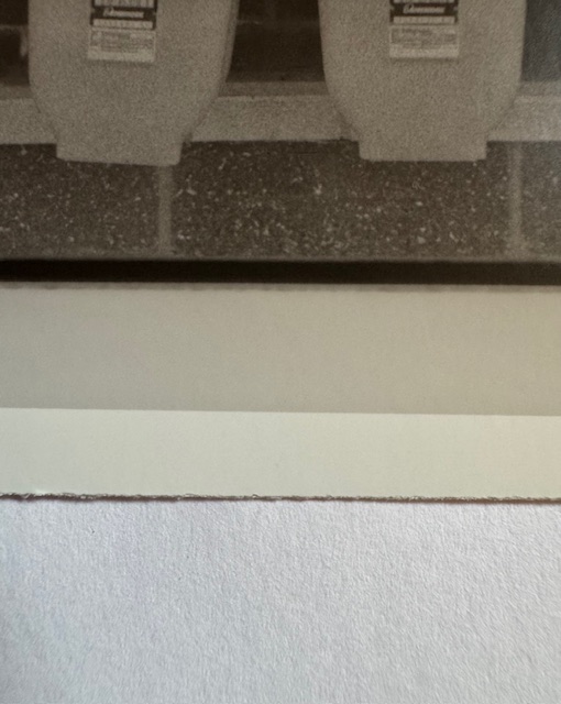

Detail of the bottom print against white paper. The line where the paper was covered by the easel blade is very obvious. Very little fog. The image also has better contrast. A bit longer development and then using farmer's reducer would possibly result in a normal-looking print.
The reason for the grey outside the image area of the print is, even though the enlarger masks that, you can still see the paper around the image while the enlarger is on. It's not a lot of light, but it really does something over the course of 4 minutes.
