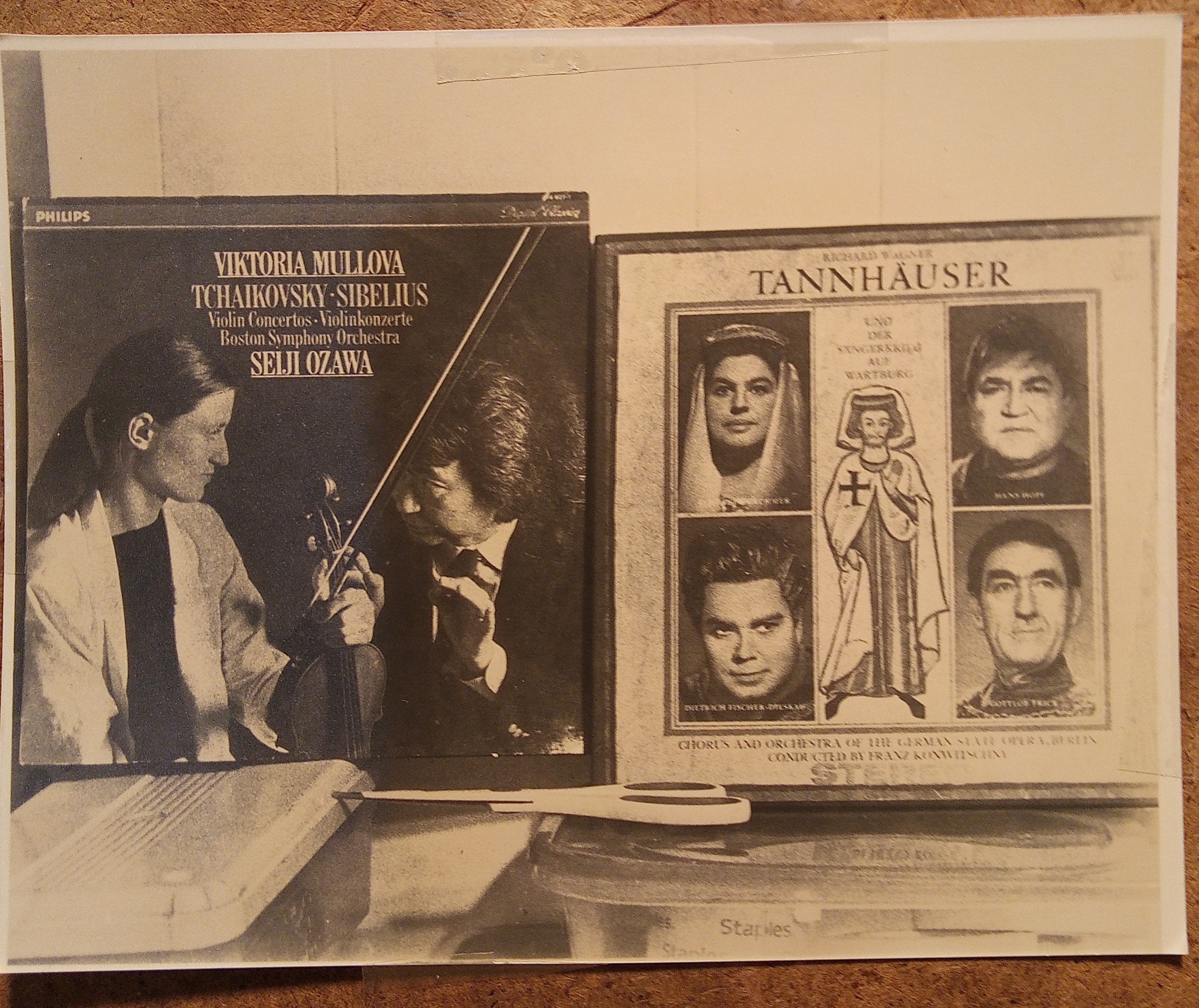

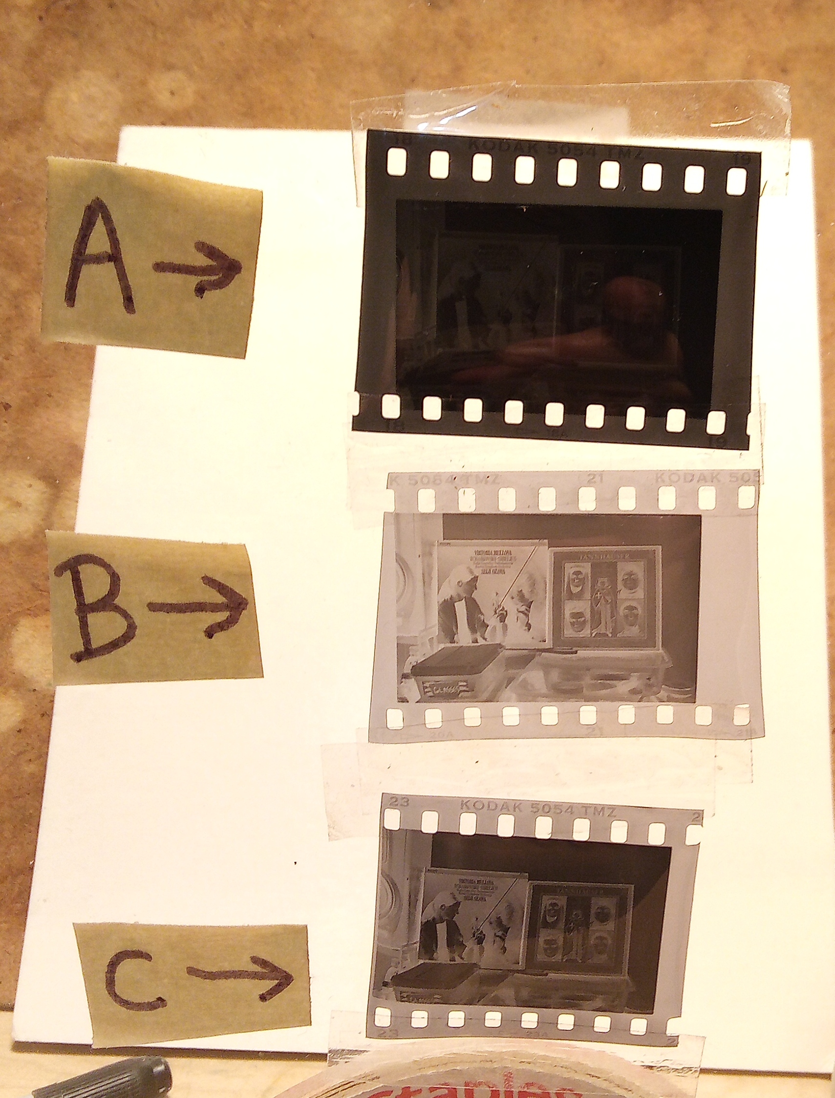

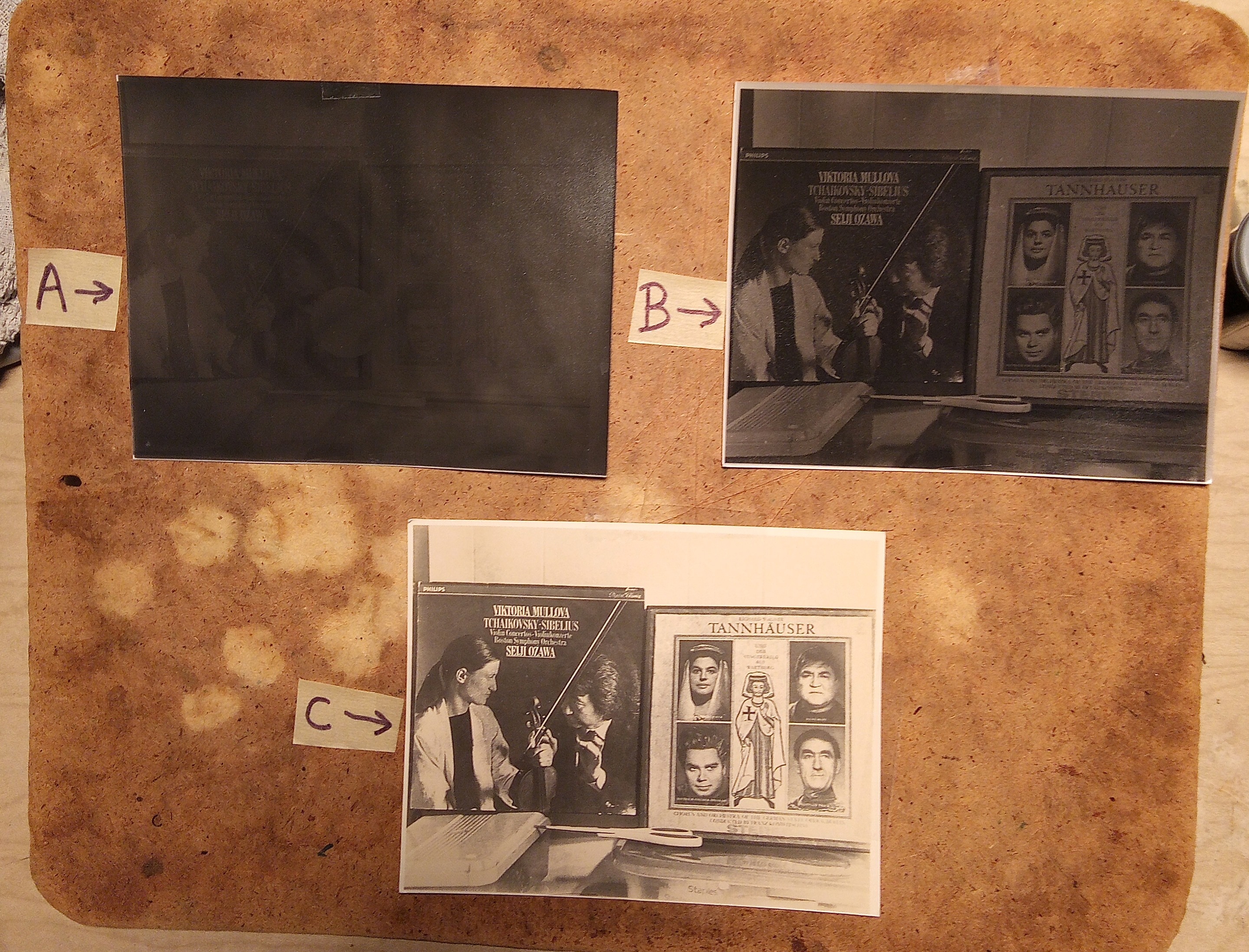

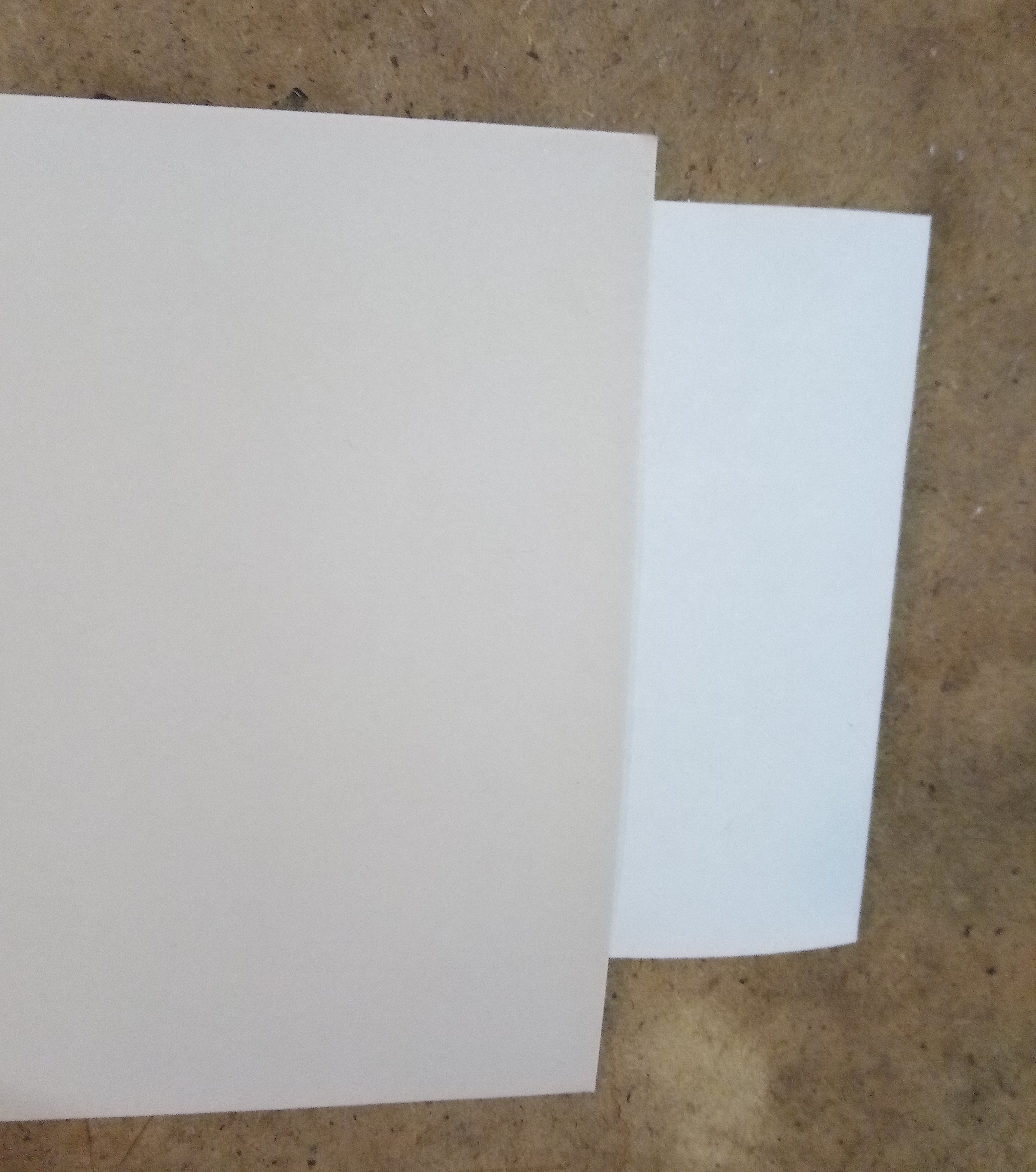

Here are the processed prints and negatives. I have categorized negatives and prints with letters in order to follow the text better and to understand better.
First, the negative film is Kodak TMZ 3200 kept at room temperature for 20 to 30 years. Normal box speed is EI 800 but I had to expose at EI 8. Enlarger is Meopta Axomat 5 with El Nikkor 50mm f2.8. Bulb in enlarger was a household LED bulb (my now normal light for enlarging). Paper used was Ilford MultiGrade that is so badly fogged, old, and abused that the rear of the paper is yellowed just like old newspaper. (See alternate image comparing back with copy paper white.) NOTHING taught me about these developers like this precious box of paper did. It is sensationally ugly. All prints were enlarged to 4 by 5 inches (about 10 X 12 cm).
Negative A: A facsimile of an image does actually emerge (very very dimly) when processed in a “D-76 type” of developer. Processed normally.
Negative B: My age-fog developer was diluted 1 + 4 and processed for only 4 minutes in order to show a ‘no fog’ image which, nevertheless, is lacking adequate contrast. Right now I do wonder if even more exposure would have made this a better negative than Negative C, by the extra exposure somewhat enhancing the contrast. That is something to think about for the future.
Negative C: IMPORTANT: This is my ‘best negative’ and was used to print ALL prints shown (A, B, C). It has adequate contrast. It was processed for 8 minutes with the same 1 + 4 dilution of my age-fog developer. After fixation, I used Farmer’s at 1 bleach + 1 paper fix + 12 water for a few minutes to get the fog to tame down. You do not want to let the Farmer’s act too quickly because it will be more difficult to stop.
Print A: processed in the normal Dektol 1 + 2 for only 30 seconds because I knew that, otherwise, the print would be jet black. The 30 second development time led to ugly mottle but still held a very faint emerging image. I placed a penny near the center of the photo but you can hardly see the round outline. THIS is what the paper is like, folks. NO ONE READING THIS WOULD EVER KEEP THIS PAPER. There is an alternate photo of the back of this paper compared to a copy paper white. Exposure time was 20 seconds at f8.
Print B: This paper demanded even a stronger developer than the max age-fog dilution (2 + 8) I had recommended. For this and for Print C I used 3 + 7 dilution. It is hard with such a paper to gain contrast. REALLY hard. Exposure was a whopping 4 minutes at f4!!!! (THAT, more than anything else is the price you pay for working with age-fogged materials; effectively, the films become “tripod films”.) You can see that this print is over-exposed, but on purpose. I gain a little contrast by doing that, then, after fixation, I bring the tones back with my Farmer’s. And putting a print like this through Farmer’s is what results with Print C.
Print C: Same as Print B, but with Farmer’s (1 bleach + 1 paper fix + 8 water), the print does come to life. Here you finally have a print that is at least somewhat acceptable. But …. That tortured film does exact a penalty. Take a look at an enlarged face of Ms Mullova: It looks like she is growing a beard!!! That is out of control grain from TMZ 3200 after being tortured into submission. But, the print is night and day better than the one processed with Dektol. Remember, this print evolved from a severely age-fogged negative printed upon even MORE severely age-fogged paper.

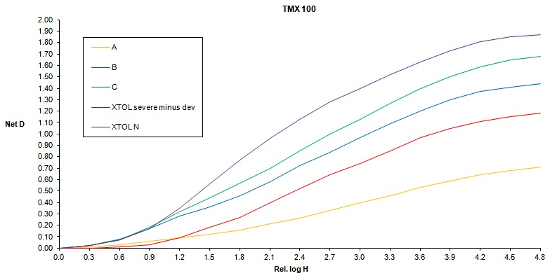

Development progresses from the grains that received the most exposure down to those who received less (and ultimately none at all). Based on this, I find it hard at this point to determine whether your 'suppressed threshold' really is any different from just very weak development. As I said before, it would be interesting to test this by taking a regular developer and develop very briefly, and compare the results to your developer. Mind you, in both instances very liberal exposure would be necessary.
With a developer like this, grains do not typically go "plopp developed", it takes time. What David's developer seems to do is slow down the weakly exposed grains but give full development to strongly developed grains. A regular developer applied for short time doesn't do this: it develops weakly exposed regions a bit slower, but it also doesn't develop strongly exposed regions all that much. Look at this posting here to see the effect of severe underdevelopment.
Looking at David's developer I see a blend of "speed losing high contrast HQ only dev" with "regular Metol based developer". HQ only may be too inactive in the weakly exposed but still image relevant areas, so a small addition of "regular dev" seems to reach the sweat spot.
That seems to match very well with what I said:
The red line would be representative to what I propose.
Of course, the plot above does not contain a curve that represents David's approach.
Forgive me for being somewhat pedantic, but at this point, that's a tautological statement unless we either have a decent theoretical explanation of why this would happen, or we have experimental data to support it.
