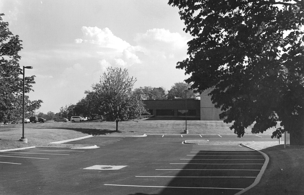

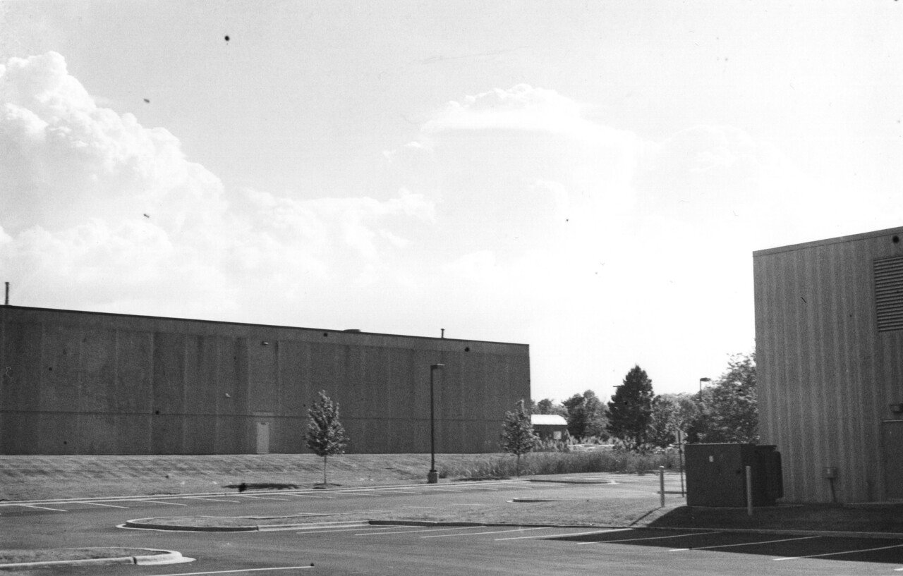

This is most interesting to me.
I have had gotten good results from very old film with developers that have no hydroquinone in them at all.
The images below are scans of prints made from Super XX film that expired in 1961. The box was sealed and I opened it in 2021 to try this. The imperfections in the images you see are due to the physical deterioration (chipping/sticking) of the negative emulsion, not from the development process.
The negatives were exposed at the box speed of 200, and semistand developed for 60min (2 min initial agitation, one 15 sec agitation at 31 min).
This first image was developed in D-23 1:1
The second was developed in Pyrocat-HD 1.5:1:200
The grain is particularly visible with D-23 since SuperXX was pretty grainy film.
Admittedly, Pyrocat-HD doesn't have hydroquinone but it has phenidone in it.

@chuckroast How's the fog in these samples? Any chance you can show us, what the negs look like?
