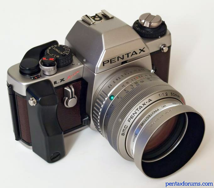

Will this do?
http://www.pentaxforums.com/forums/...-lx-2000-millennium-brand-new-collection.html
