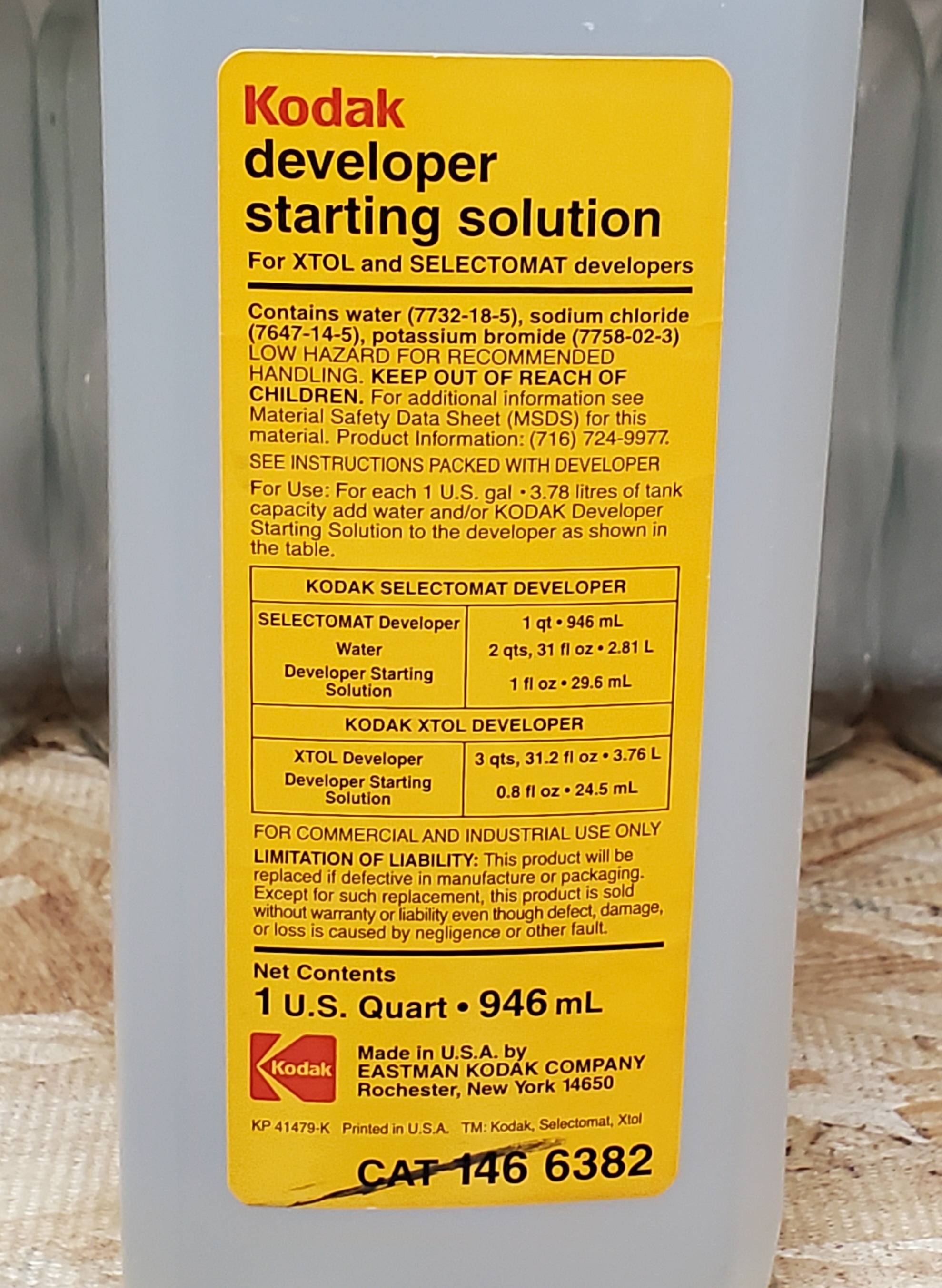

This is the elusive starter. 24mL per gallon of XTOL stock to season. It looks like it is just KBr and a little NaCl. I tasted it it tastes like KBr. I ran replenished XTOL for years, before that HC-110 dilution B. Not worth worrying too much about.
I use XTOL stock one shot today with the Jobo.
But would this season the Xtol? Or it is a non sense product like their bleach starter?
No this is loaded with KBr. Starters are really important with big machine processing, especially at elevated temperatures.

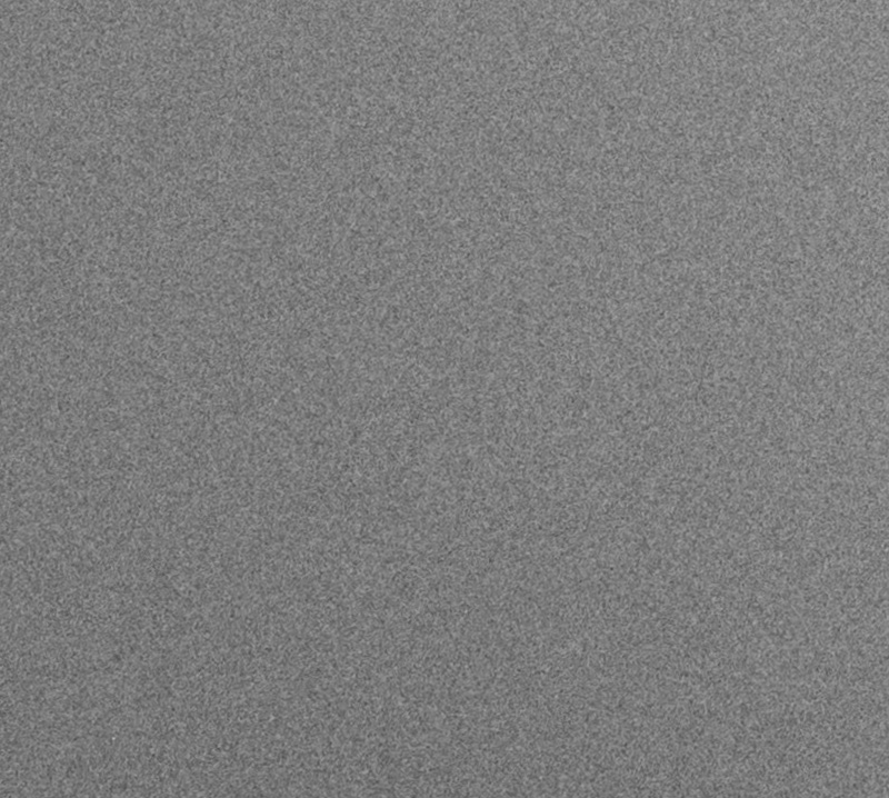

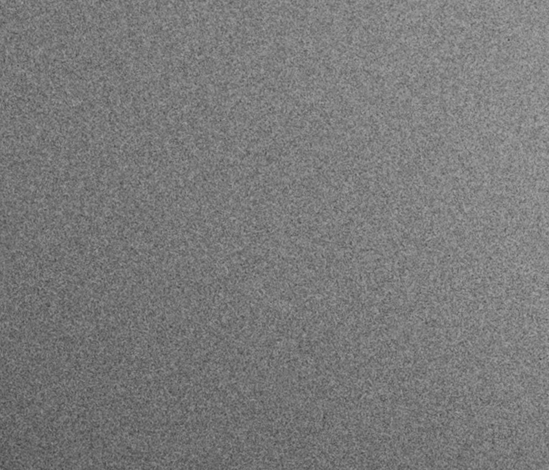

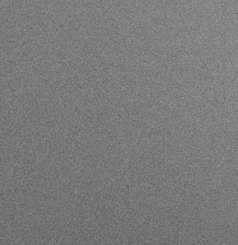

Attaching full-sized (100% crop) scans of a grey card made with a 60MP camera. Sharpening is set to 0 in Lightroom. HP5+ exposed according to an ambient light meter EI400. This is exactly the same image in my book.

No offence Steven, but if you are going to perceive any difference, it will be in acutance, and it is tough to get any sense of acutance from a photo of a grey card!
The differences are small. If they were the only differences between the three different approaches, I wouldn't be such a fan of replenishment, even though I have a small preference for how the films come out.
Steven Lee
Jul 10, 2022
1,441
USA
@MattKing good point. I have not tested for acutance. The grey card test was done for process monitoring.
