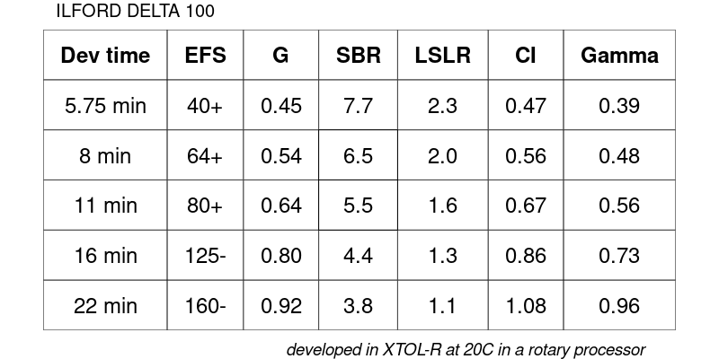

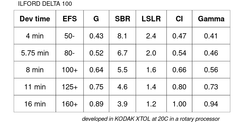

I hope this doesn't dissuade people from using XTOL-R, but I have found that stock XTOL gives more film speed, by about 1/4 to 1/3 stops, at least with the films I tested, most recently Delta 100. The difference is very small, probably not worth worrying about:
View attachment 328599View attachment 328598
I noticed the same thing. I've seen people here on Photrio say that Kodak TMAX 400 is a true ISO 400 film, but the best I was able to muster with replenished xtol and my unscientific but still pretty rigid setup was 320. I didn't run full strength to see if there was a difference, but still, replenished didn't seem to give quite the same film speeds as what has been claimed elsewhere with different developers for a given film.
