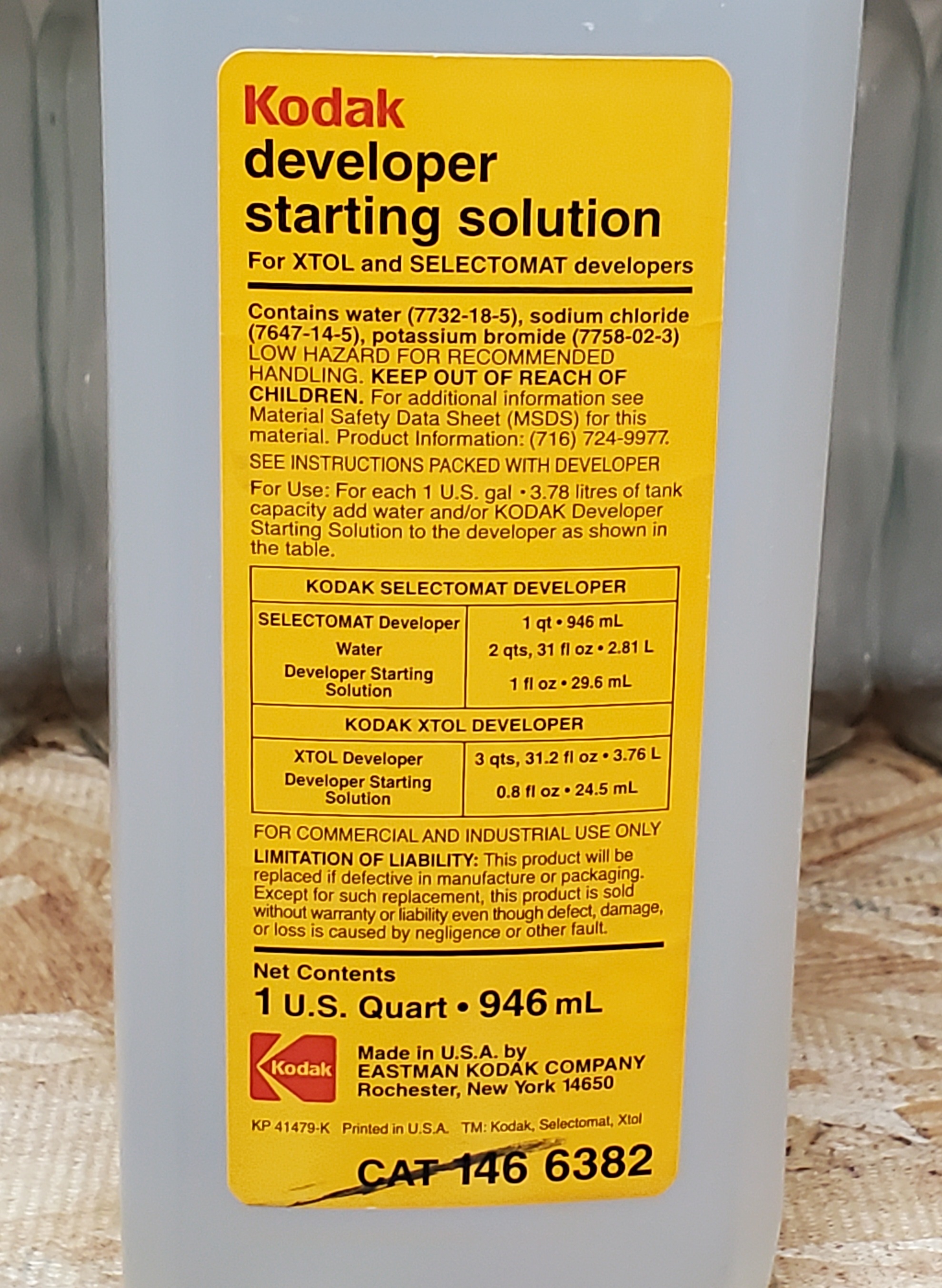

This is the elusive starter. 24mL per gallon of XTOL stock to season. It looks like it is just KBr and a little NaCl. I tasted it it tastes like KBr. I ran replenished XTOL for years, before that HC-110 dilution B. Not worth worrying too much about.

Too bad Kodak doesn't seem to make this any more. I wonder how hard/expensive it would be to get at least the NaCl and KBr levels tested? I'd rather use a starter when I have to mix a fresh tank solution than season two liters with a ten to twelve rolls.
