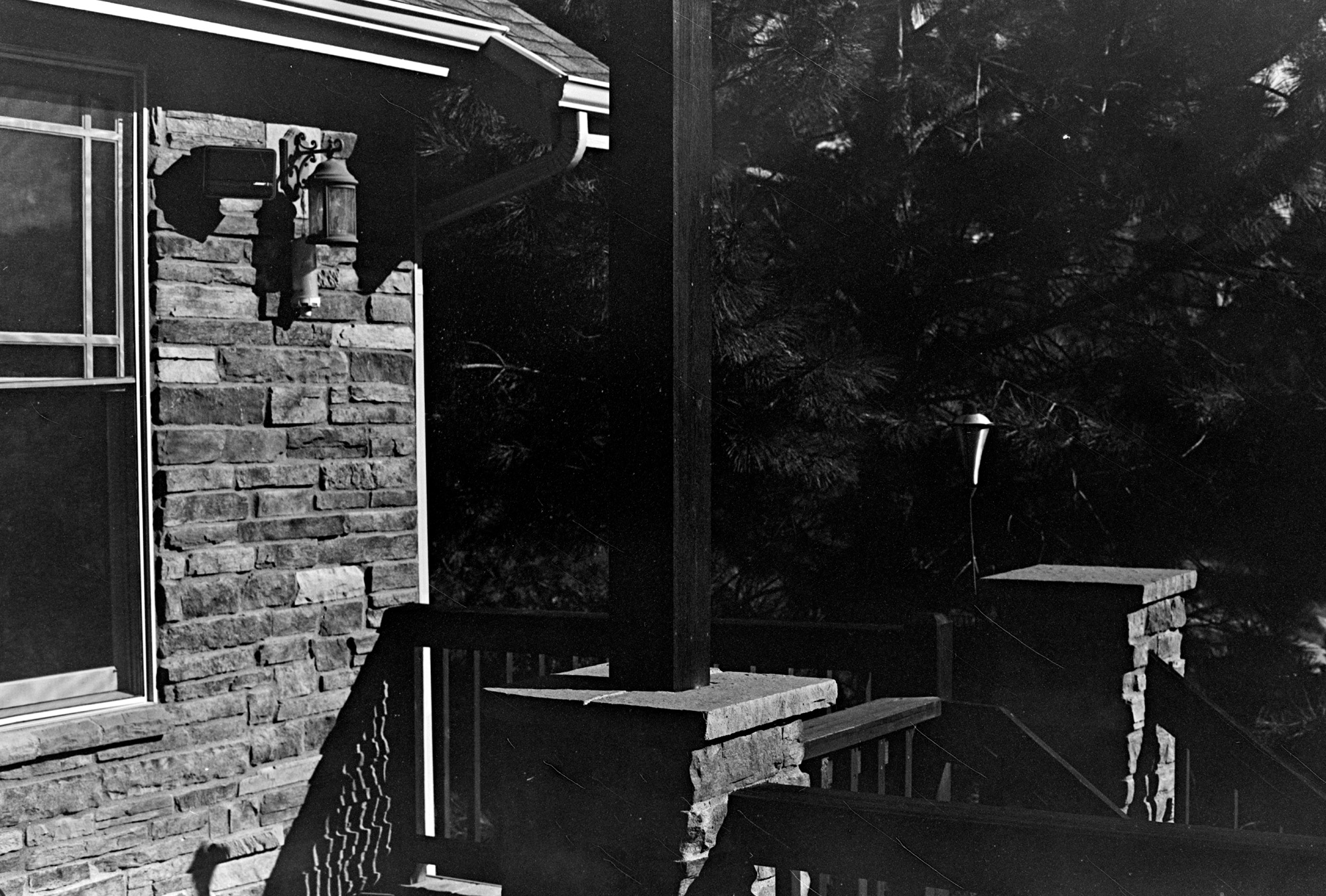

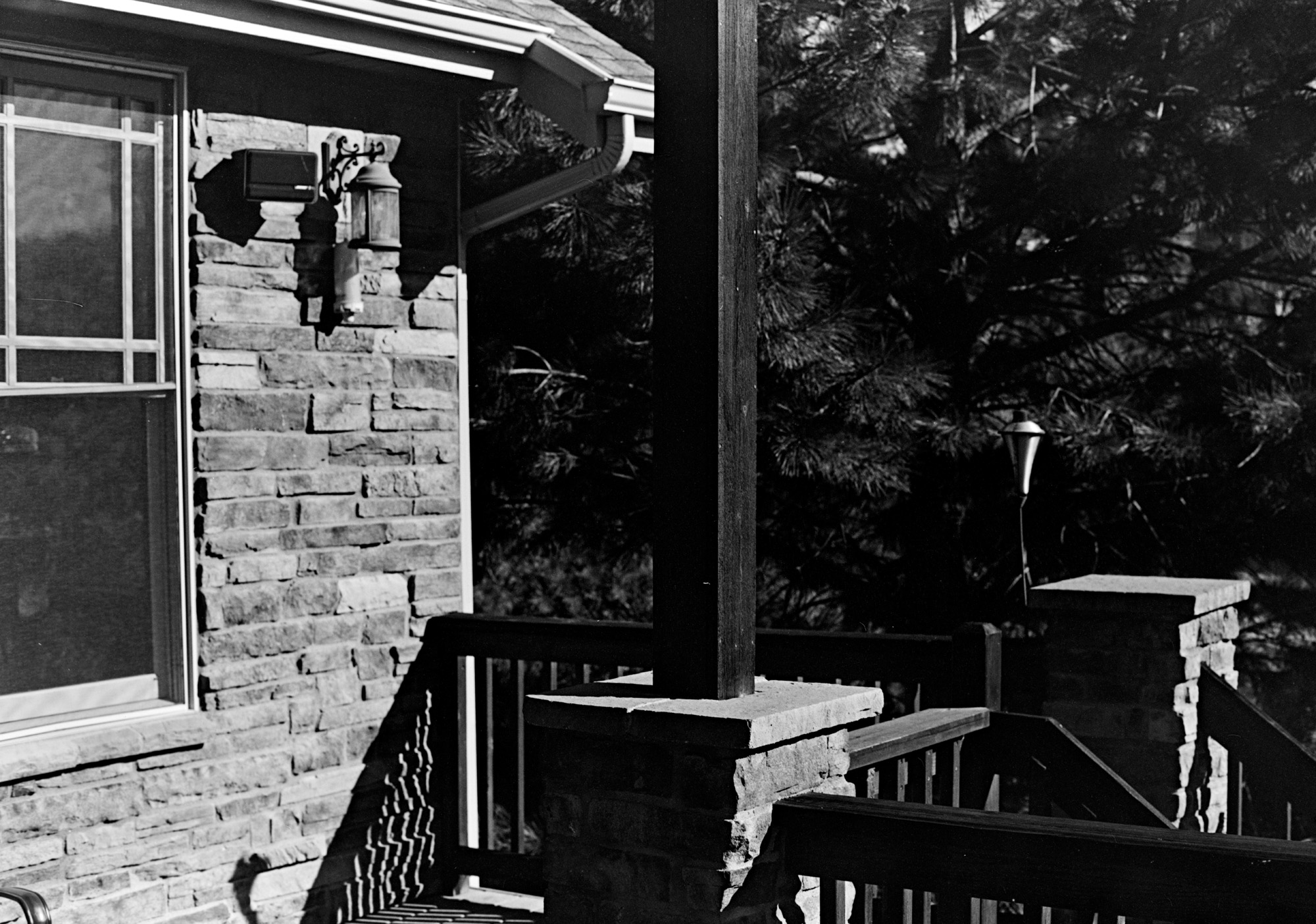

Did a run with conveniently cut and perforated 35mm Ultrafineonline's house brand of Ortho Litho, processed the same way as I do Arista's. PFS-4 1+30 for 3 minutes, D-76 1+3 for 7 minutes. Results look great and easily usable for pictorial results. Actually responds to this process in almost exactly the same way as Kodalith does.
25 ISO:
12 ISO:
50 ISO:
25 ISO with a lot of contrast and detail:
Detail at 25 ISO:
100% crop of detail to show grain:
Only concern with this film is that it is apparently extremely susceptible to scratching. I believe most of the scratches came from my camera, which has never shown scratches with any other film before
Nice results especially with EI:12. A bit contrasty for my taste, but quite impressive. I've been experimenting with Svema Micrat Orto ISO 3 film. I'm using a reduced pH catechol developer. Your PFS-4 bath step looks interesting in my context if it can boost my EI by a stop or two.
