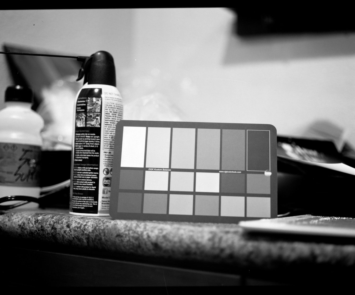

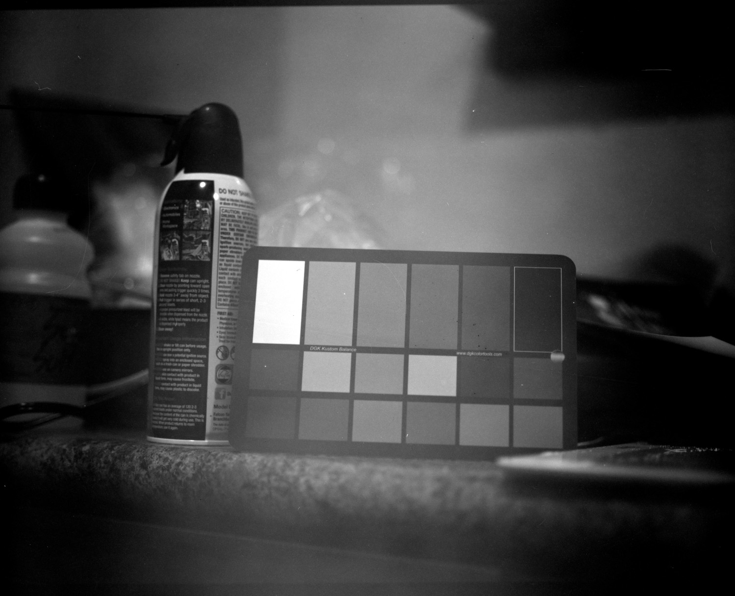

Did another set of test runs tonight. Finally found the source of the fog for the TEA+bromide prebath -- not enough agitation. All runs developed by inspection in DD-X 1+9 (3m-6m). Set of runs (all sized to 500ml):
1. TEA + bromide 10ml/10g, no agitation, 5m -- Thick and non-uniform fog across the entire test strip, with slightly less fog on the edges. Effective max speed though, 12 ISO, maybe faster with stronger development
2. TEA + bromide 10ml/10g, constant agitation, 5m -- No fog at all, improved shadow detail. Effective max speed 6-9 ISO
3. TEA 10ml, constant agitation, 5m -- No fog at all, slightly better shadow detail, highlight and midtone detail worse. Effective max speed 6 ISO
4. TEA 10ml, no agitation, 5m -- No fogging, no observable improvement from without prebath (ie, very steep drop off of shadow detail and very steep highlight detail). Effective max speed 3 ISO
Full roll test: TEA 10ml, bromide 10g, constant agitation 6m; DD-X 1+9 for 5m -- Despite being more aggressive for both development and time in the prebath compared to #2, the max speed looked worse, with some shadow detail missing at 12 and 6 ISO that was present in #2. Interesting to note, when pouring out the prebath it appeared rather foamy despite there being minimal air in the tank.
So bromide is a critical component of this bath, and whatever fog comes from it does effectively increase the speed of the film. TEA+bromide done in a way that produces no fog will increase shadow detail and the effective speed by around 1-2 stops from naive processing, but the strip that was heavily fogged had significantly more shadow detail at 12 ISO. The fog does not occur without bromide, nor does it occur with significant agitation.
I'm honestly pretty stumped by this. My only guess is that TEA+bromide reacts with the emulsion in some way which produces a very short lived fogging agent. Agitation causes the agent to be washed away from the emulsion into the overall bath and/or to decay. I can't really figure out another explanation that would match these results. Notably, that bromide, a restrainer, is required in order for the fog to happen. It's very unintuitive.
Anyone out there with more chemistry knowledge than me have an idea for how this would happen?

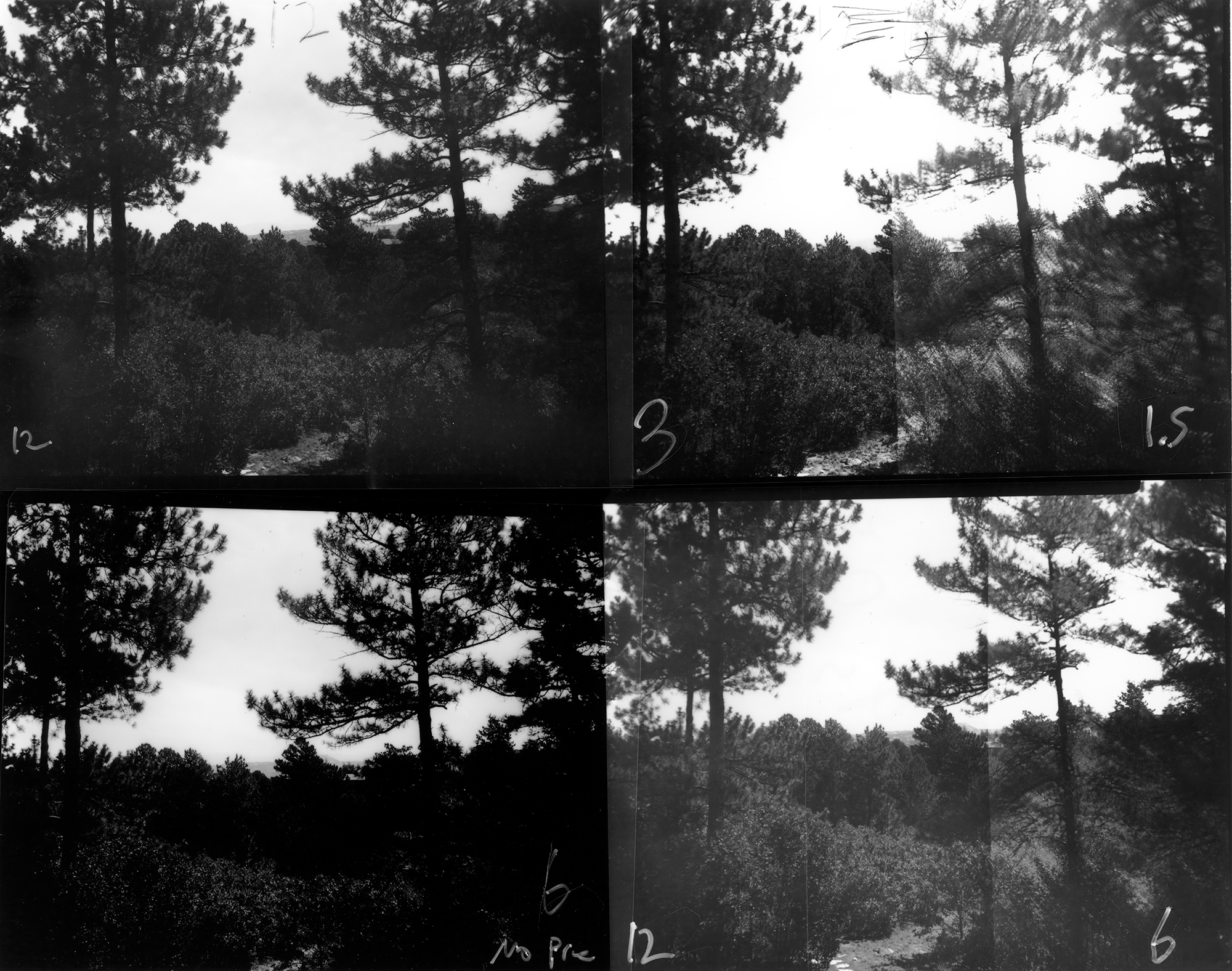

Did a test run today. This time doing:
* Pre-bath (500ml) of 15ml TEA + 10g bromide, 10m with constant aggressive agitation
* DD-X 1+9 5 minutes. 30s initial agitation, 2x agitation at 2.5m mark
Results are very promising. No visible fog, though after scanning it appears there was a small amount of uneven fogging. Achieved great detail at 12 ISO and reasonable detail at 25 ISO, while also keeping 3 ISO and 1.5 ISO looking great. High contrast scenes, such as sky with dark trees renders with both tree detail and cloud detail. The negatives came out fairly thin though, appearing under developed. Probably will use more agitation and a total time of 7m next time. This is what the negatives look like. A lot of orange, almost like a pyro negative:
2x 12 ISO shots:

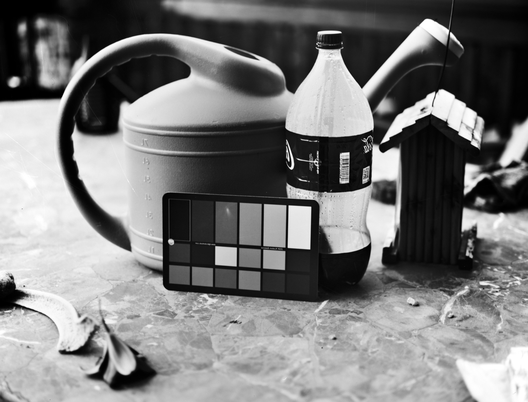

A 1.5 ISO shot:
And finally, even the 25 ISO shot seemed somewhat reasonable aside from the scratches and fog that tend to become obvious:

I've finally done it. Lets start with how awesome this looks:
This was taken at 12 ISO on a 120 camera and developed in standard reels. It also is definitely usable at 25 ISO, and starts to drop off (somewhat gracefully) at 50 ISO. I'd say you could effectively "push" the film in development to 25 or 50 and get great results as long as you disregard over exposure latitude.
So, after at least 150ft of custom cut 120 film, I have found the ultimate method by which to make Arista Ortho Litho a pleasant, extremely fine grain, normal/somewhat raised contrast, pictorial film.
The final process is shoot the film normally at 12 ISO, and then to use a prebath before development. The prebath I've dubbed PFS-4 (post-flash-solution version 4). Although I equate this with preflashing, the solution actually raises sensitivity quite a bit higher than is possible with normal preflashing. It has the same effect though, raises shadows, leaves highlights mostly untouched, and too much application will cause fog.

Here are some more brackets. At 6, 25, and 50 ISO respectively
As you can see, contrast unintuitively seems to go lower with under exposure and higher with over exposure. The film also becomes rather grainy with under exposure and any uneven fogging and other defects will begin to show up
This of course can apply to tray processing as well. Ensure constant agitation in the tray and that the emulsion is always UP. Do not process multiple sheets at a time. This accelerated process is actually ideal for doing darkroom enlargements though keep in mind prebath timing must be precise. The prebath has been seen to work with no activity difference for at least 10 4x5 sheets per 500ml in my testing.
This is a quick contact print test I did with 4 sheets at different ISOs, and with 6 ISO having no prebath applied as a control. It was printed at grade 0.5 and nothing was 100% black so that I could basically get all the detail possible onto paper. In practice, the prebath 12 ISO prints best at grade 2 or 3.

Did some tray tests today, including processing some actual 4x5 pictures of things other than test charts and test scenes around the house!
Concluded that D-76 is in every way but processing speed, a better developer for this film, and with an almost normal dilution.
Process (test exposure at ISO 12):
* Rinse
* PFS-4 1+30, 3m, constant agitation
* Rinse
* D-76 1+3, 30s initial agitation, 4x per minute after, 5-7m total ("pushed" to ~20 ISO is 7, 12 ISO is 6, "pulled" is 5)
* Stop/rinse
* TF-4 fixer 30s
The results are very impressive. With D-76 no fog ever develops, but you get the significant shadow speed boost! I went as long as 4m in PFS-4 and 8m in D-76 and the results were clearly overdeveloped, but no fog at all. Increasing PFS-4 dilution to 1+20 resulted in the same effective speed, but with fog after just 4m in D-76. Results seem consistent with PFS-4 times of 2m to 4m, but I figure 3m is the safest time. Speed is pretty much the same as with Dektol 1+20 for 2m, but since no fog appears, it's possible to get the shadow density to easily printable amounts. Shadow detail is mostly present by 4m, but it looks best to me with my 12 ISO test at 6m. Highlights still run away a bit, but with limited agitation they mostly just go lower and lower contrast with more exposure. Tests were done with a somewhat measured test under an enlarger to get a reproducible 12 ISO-like exposure.
The real pictures also developed well with mostly normal contrast and very good shadow detail and tonation. There is one picture involving reflections where the highlights ran away pretty badly, but I think it can mostly be blamed on a high contrast scene and imperfect metering. I also used the "pushed" time of 7m, on it since shadow details weren't coming up like I wanted. End result is pretty striking though.
Grain is definitely pretty high, being quite obvious under 5x magnification, but at least in negative form, the grain looks sharp and attractive. I will do a tank test soon to ensure this also works with 120 cut film in a development tank. Hoping it works since I ran out of 120 cut film and only have a "test" roll of actual important pictures
