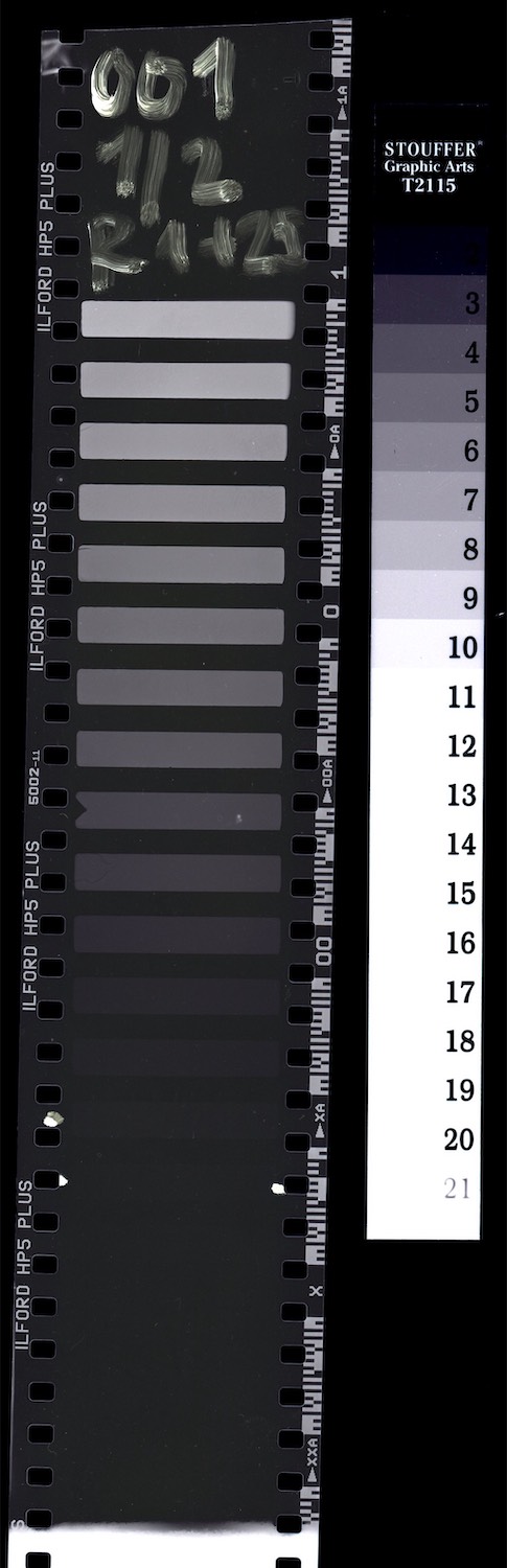

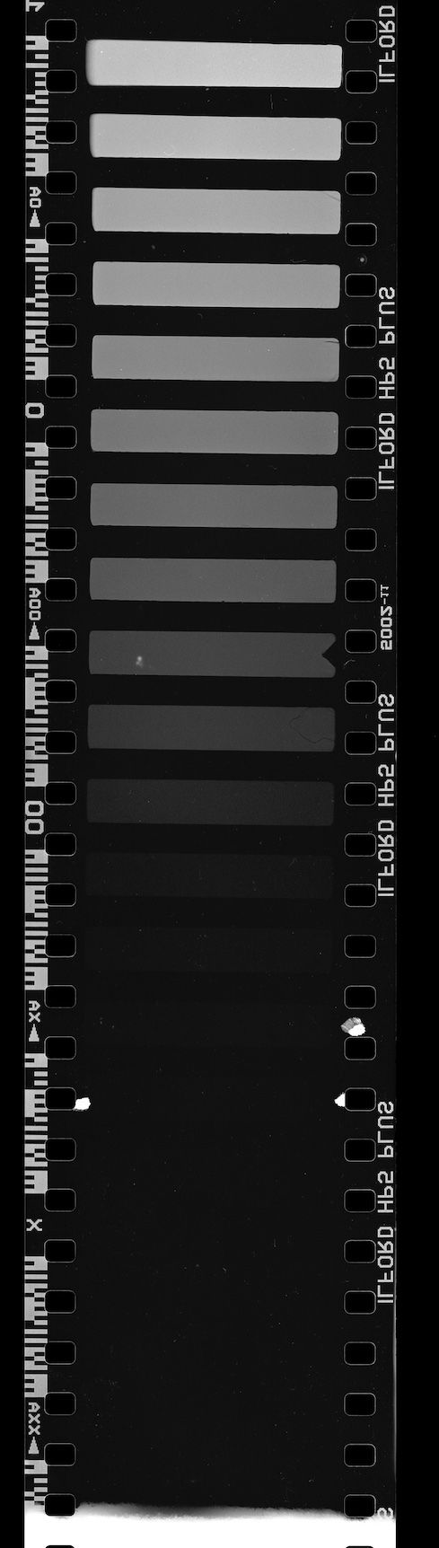

First test candidate: HP5 developed in Rodinal 1+25 for 6 minutes, 1 minute agitation. Very standard.
Exposed at half stops. The strip with a notch is the 18% tone. So I think I got 2-3 stops under the 18% and 4 stops over. Please note that the highlight range was not enough to reach any sort of maximum density. You can see the max density in the lower part of the image.
But I cannot find the toe shape. It seems to be pretty linear or something is not right.
I tried to analyse the negative with my enlarger meter but it failed a bit; the film must be measured from directly under the enlarger head and I got bad readings. Then I analyzed with Epson V600 scanners "pick color" tool. That way I got something happening in the toe area, but that might have been just measuring error. Now measuring from this scan output file, it seems to be really linear:
So is HP5 this linear in reality? Or do I have bug somewhere? The exposure times are based on my measurements dead on.

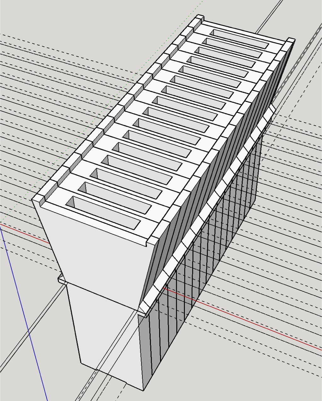

It uses WS2812b LED strip. That was my base idea, no need for external drivers and low amount of soldering. I cross-checked few leds and they output really same amount of light. I could of course calibrate, but for now the accuracy is enough for me. I'm going to use this to really extreme tests so that level of accuracy is probably not needed.
The actual device is very black blob so I think 3D render is much better:
It is just a bunch of chimneys to get distance to the leds. Pretty simple actually.

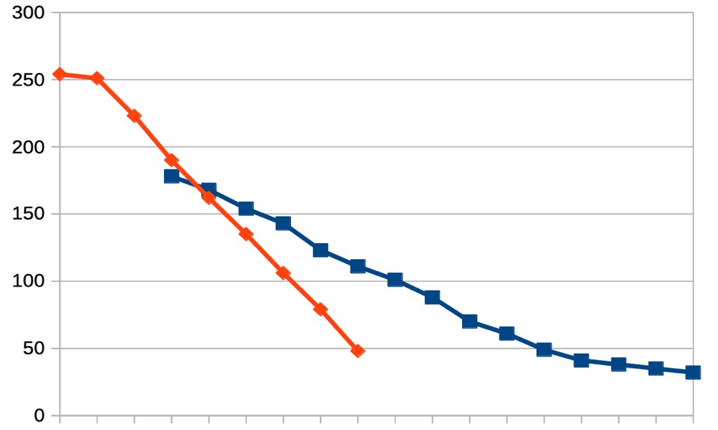

Is there something off here, I scanned Stouffer + first test strip together in single scan:
And plotted together (I left linear Y-axis as it shows the "problem" much better):
Orange=Stouffer, Blue=film
Data here (first film, then Stouffer):
178 254
168 251
154 223
143 190
123 162
111 135
101 106
88 79
70 48
61
49
41
38
35
32

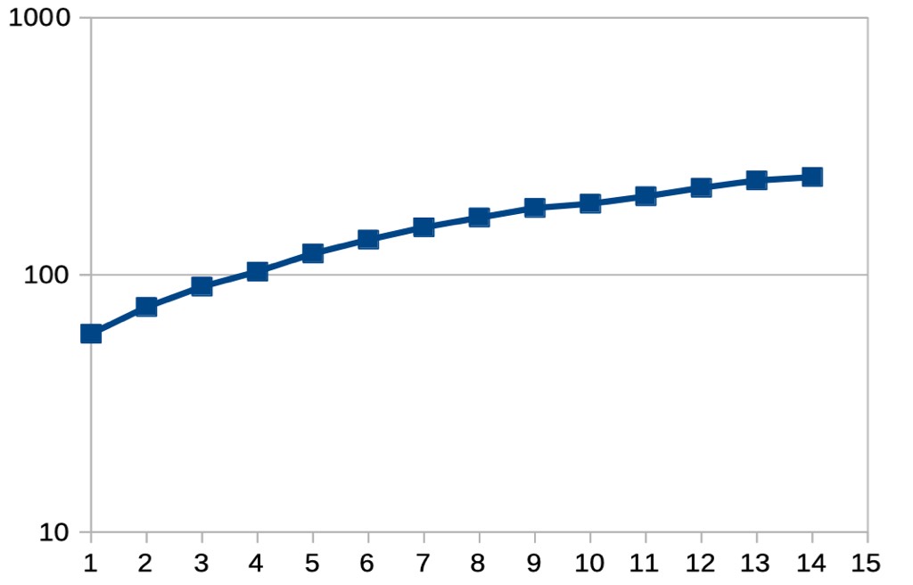

Basic rule about graphs: they should show for each axis which quantity is plotted, and the unit, as in: distance (m) or duration (s). Your graph shows neither.
Plus, you get numbers out of your scanner. They are expressed in some color space, and their relation to the luminous flux passing through the film is (a) not logarithmic; (b) non-linear and complex, with many different forms floating around. See e.g. : http://www.brucelindbloom.com/index.html?Math.html; I give below a sample at random:

Cool down. That facepalm was for myself. I corrected the graph to logarithmic as result so I guess that is obvious I'm the one with the mistake.

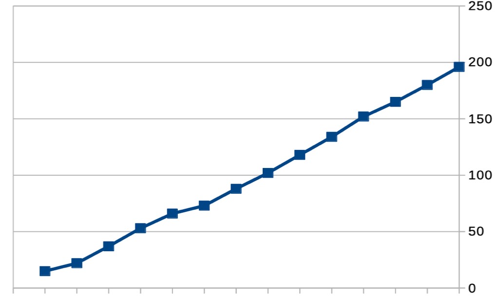

Some of my own analyis from previous scan:
Stouffer wedge is half stop and the plot of it is really linear so I think we can use that. I calculated that half stop is 29 in grayscale value. Also the data from film scan looks pretty linear so I think we can trust that too.
I then calculated the difference between my film slots in stops and with some filtering I got result that the slots are about 0.22 stops apart (or 0.066 in density). So the compression in density is 0.44 (from "real stops" to how the film represents this).
Did I get this right?

"Corrected" graph was so obviously unlike a logE-D graph that it gave the impression you were poking fun.
My other comments stay. You plot graphs but not clear what is on the vertical axis.
I understand that. I cannot afford poking anyone here because I'm super interested in your input and ideas.
The units are missing because I guessed those are obvious. Y-axis is just the grayscale value and X-axis is the strip position. So no "real" values, just relative to the scan itself.
