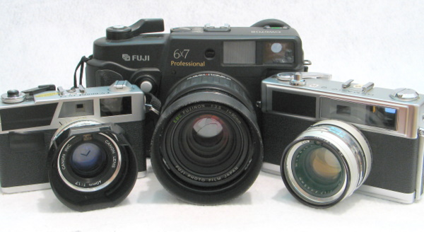

...at what level of enlargement you think you can see the advantage of medium format over 35mm? I ask because I set myself this little task and compared 35mm and 6x7...
When I was shooting Tri-X film for newspaper publication, it made little difference if I used 35mm small format or 6x6cm medium format film to print 3 or 4 column images. However, when I tried to get high-quality 16x20-inch exhibition prints from the negatives, it made a big difference because the medium format images were so much better.
Evidently, I am not the only one who can tell a difference. Once, as I was preparing a presentation for a photography class, one of the other guest lecturers (a sports photographer) asked to see my portfolio. When I pulled out the first 16x20-inch photo, the first words from his mouth were, “Oh, you shoot medium format too.”
