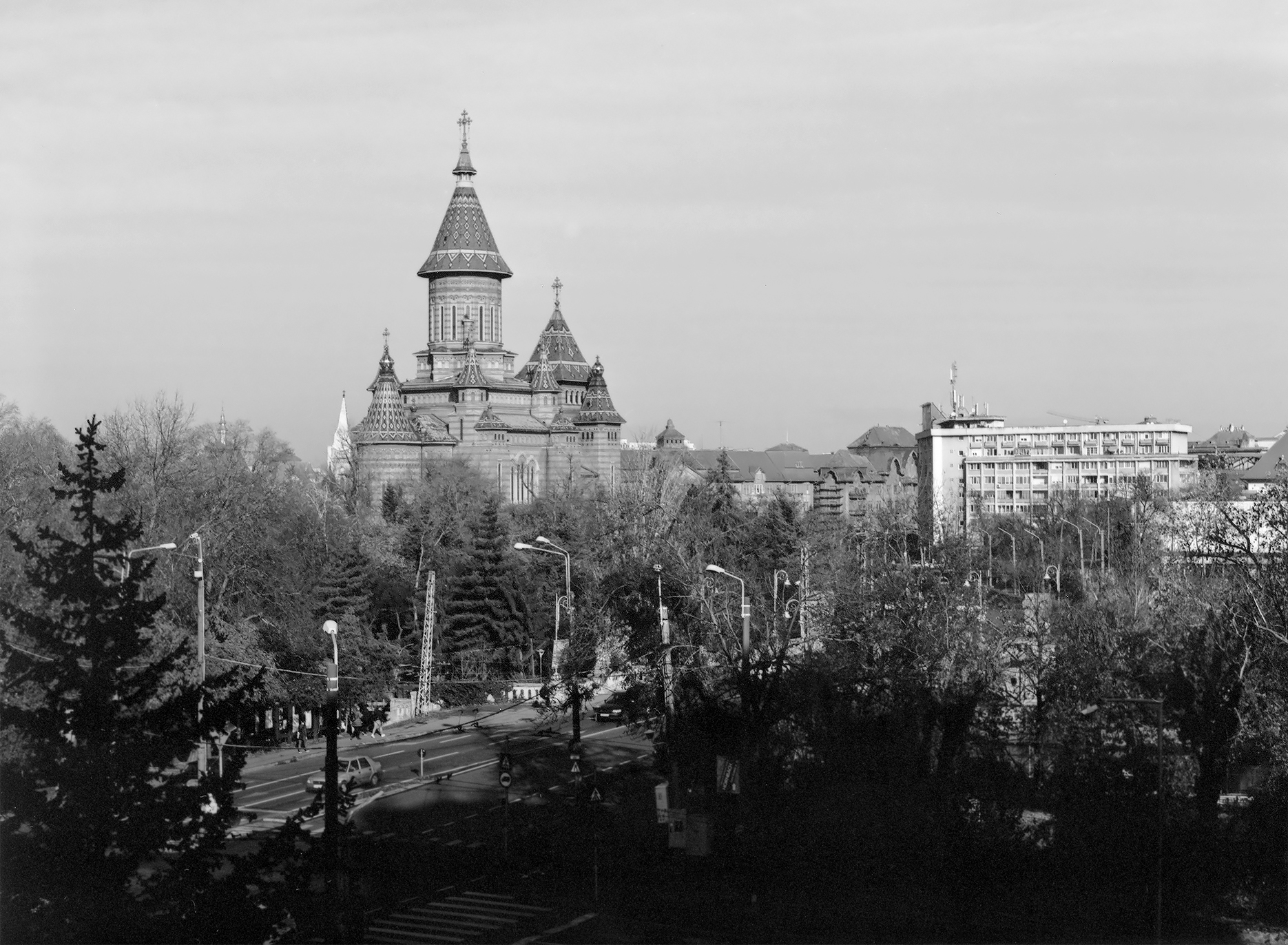

ADOX CMS 20 II developed in ADOTECH IV 1:14 for 11min. Shoot at ISO 50 (I forget that EOS 300 camera in manual mode uses spot metering and unintentionally put the sky into zone V), 1/90sec f:8. The light was very harsh being early in the morning with very deep shadows. Printed on Fomaspeeed Variant 312 without any filter (normal contrast). Enlarged with Laiser VCP 6000 and El Nikkor 50:f:2.8@f:8.

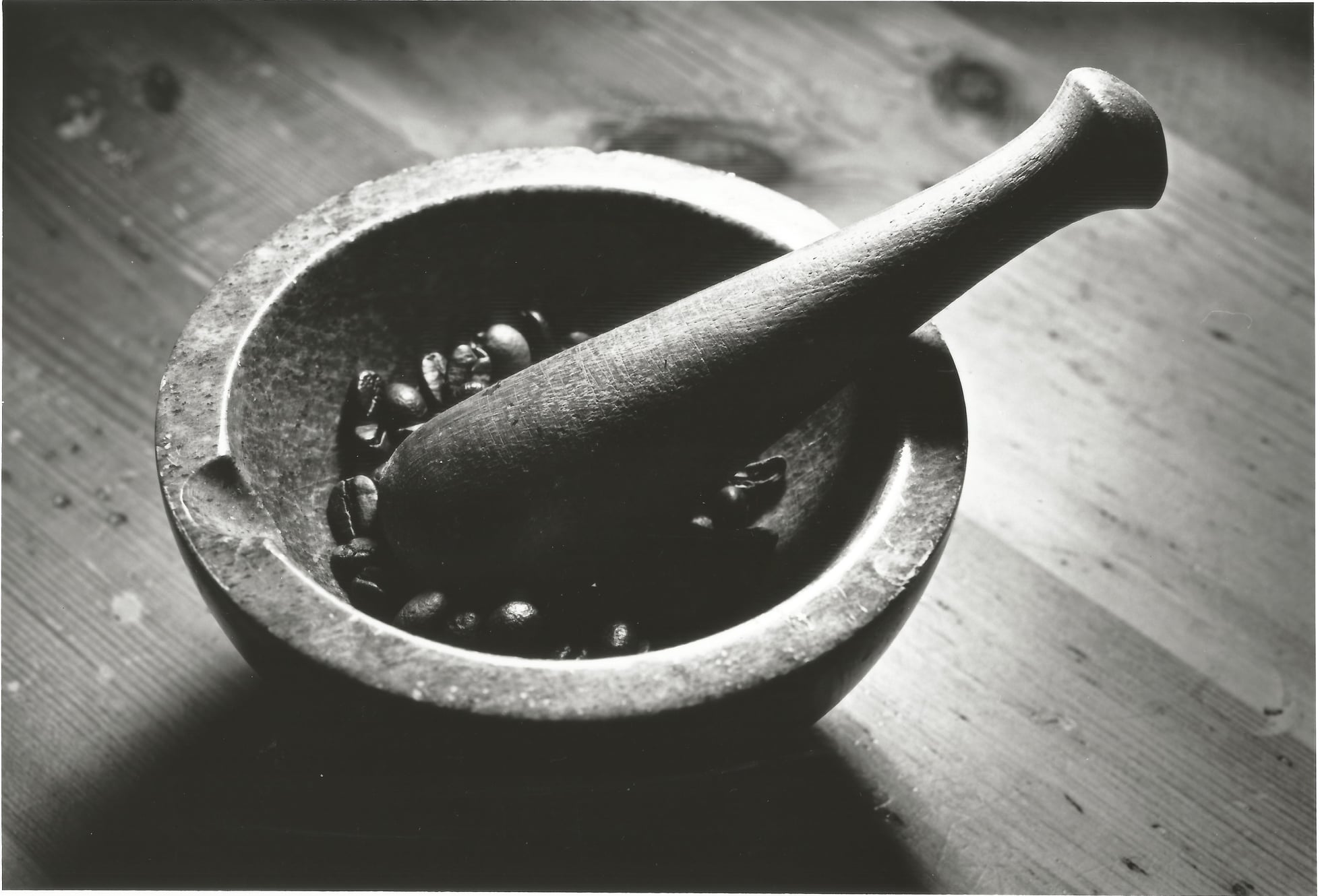

First time back here for a while and apologies for resurrecting an old thread. I've had pretty good results with CMS20ii in POTA (home made) . This was rated at 12 ISO and shot with an Olympus OM1n and 50mm f3.5 macro lens. Developed for 9 minutes at 20 deg C with 10 secs gentle agitation every minute.

I'm glad somebody else is still using CMS20II. Last week I just used my last roll of 120 but recently have been really enjoying using 35mm. Two things immediately come to mind, the first is the Adotech developer is superb (follow the instructions and it works to give a full tonal range), and secondly I've also had good results from 510Pyro which I also used with the original CMS20 way back when. I rate the film for both developers at 6 ISO but this depends on how you meter, but from 3 ISO to 12 ISO is good. The 510 Pyro seems like it can be problematic with higher dilutions than 1:100 which I'd always used in the past. I had a nagging doubt that maybe a higher dilution would be better especially for 35mm, so I tried 1:300 (semi stand) and it was horrible, I think it was just too weak and there was an obvious chemical fog from exhausted developer. With quality 35mm lenses (I use either Leica or Nikon cameras but I'd also include Olympus in a list) I think the results are medium format quality if done well, maybe not a direct equivalent with a Mamiya 7, but not enough difference to turn your nose up and pooh pooh it as an option.

Yes I recall he did describe a specific way to do this. Do you mean that any speed above 20 blows the highlights or below 20? While it is difficult to gauge the highlights in the shot in#56 the problem there seems to be with the lack of shadow detail on the trees in the foreground and this was at 50
