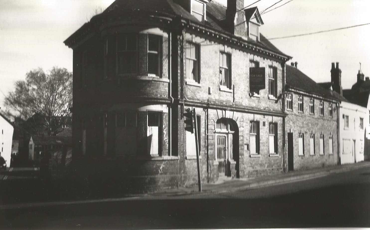

    I got a roll, just to try and developed it in DK76B (like D76) at 1+1 for 15 minutes. It didn't come out as high contrast as I had expected. See attached for quick proof print.
    It was a sunny morning, or sunny as it gets in Gloucestershire in March.

    Is that a poor scan or is the sharpness on this negative that low?
  16. Richard Searle
    Richard Searle Subscriber
    Ads Enabled
    Messages:
    30
    Joined:
    Jul 15, 2003
    Poor scan.

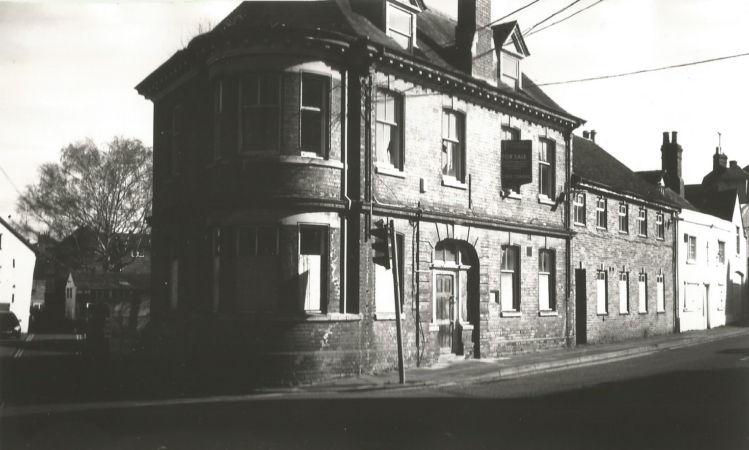

  17. Richard Searle
    Ads Enabled
    Messages:
    30
    Joined:
    Jul 15, 2003
  18. Alan9940
    Alan9940 Subscriber
    Ads Enabled
    Messages:
    945
    Joined:
    Jun 17, 2006
    Location:
    Arizona
    Shooter:
    FWIW, in my experience the sharpness of this film is exceptional, at least when developed in CMS developer; which is the only one I've ever used.

    I have only used Adotech to develop this film, with very satisfactory results btw. Though you indicate it came out better then you expected, the image seems extremely contrast y to my eye. That may be your developer, your agitation, or it may just be the time of day when the exposure was made. It could also be a little bit of each. Traffic Surveillance films are notoriously sensitive to developer and to agitation.
    Considering the time of day it would appear that you used a very open aperture setting and it has resulted in some softness in the main building, particularly in the upper story. It can be so easy to miss focus by just a tiny bit when you are wide open, or close to it. This film is so sharp it shows these focus issues very quickly. I certainly do not have the sharpest eye any longer but it seems that the actual focus my have been on the building just to the right of center.
    I suspect that this negative may be difficult to print well in the darkroom.

    I thought the first scan was less contrasty with more detail in the highlights and shadows and overall better but we are back again to the old question: Is it the scan/scanner or the negative that may be at fault?
    The proof of the pudding is in the print. It would be great to see a print from the negative,if possible
