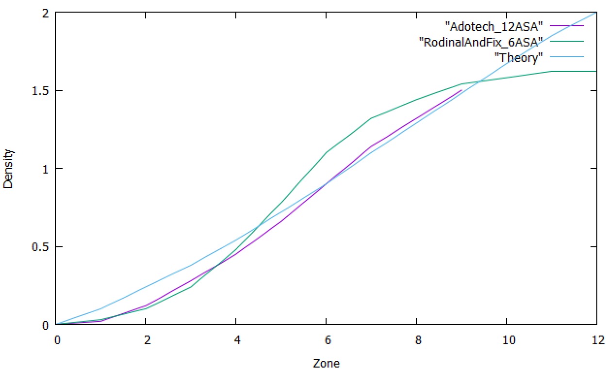

I know that is an old thread. But I have something to contribute to the CM 20 / Orthopan UR films (which is Agfa High Definition Pan, a document film).
From time to time I tried to get a normal contrasty negative form it, without the usage of the very good but expansive Adotech developer. Now I found a solution. It consists of mixing Rodinal with a tiny amount of fixing solutions. I explained (in German) how and why it works:
https://aphog.de/forum/index.php/Th...CMS-20-weichklopfen-mit-Hausmitteln-Wirklich/
The recipe:
- 3 ml of ready to use fixingsolution. I used Adofix Plus 1+4
- a tiny amount of NaOH which can be got form drain cleaner. It serves for neutralizing the acid in the fix. If you use neutral fixer, you don't need that.
- water to 500 ml, 20 deg Celsius
- 7 ml Rodinal
Expose for 6-12 ASA. Develop 15 mins with continuous agitation. You get negatives which are easy to print. In comparison to Adotech you sacrifice one stop and get a slightly higher contrast of 0.75 instead of around 0.65.
The image shows a comparison of the characteristic curves of the film i Adotech (thought having 12 ASA) with my Rodinal formula (thought having 6 ASA).

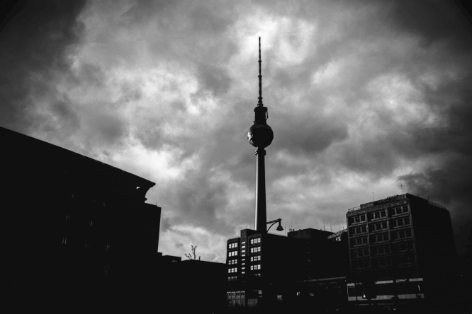

This is how Adox (35mm) CMS II looked over here developed in Diafine @ 22°C / 3:3.
Ignore the vignetting, this stems from an improper lens shade,
but as you can see it's very very contrasty (Acros gets very contrasty as well but that's a story for a different thread).
I decided to shoot this film and develop it in Diafine after seing the remarkable results here and here
this is the first version of the CMS film though so things might have changed now - would love to see others' results with CMS (II) in Diafine.
Cheers.
locutus
Jun 9, 2009
579
Finland
With what colour filter did you shoot that? i guess you used a deep orange or red filter to keep the definition in the sky?
