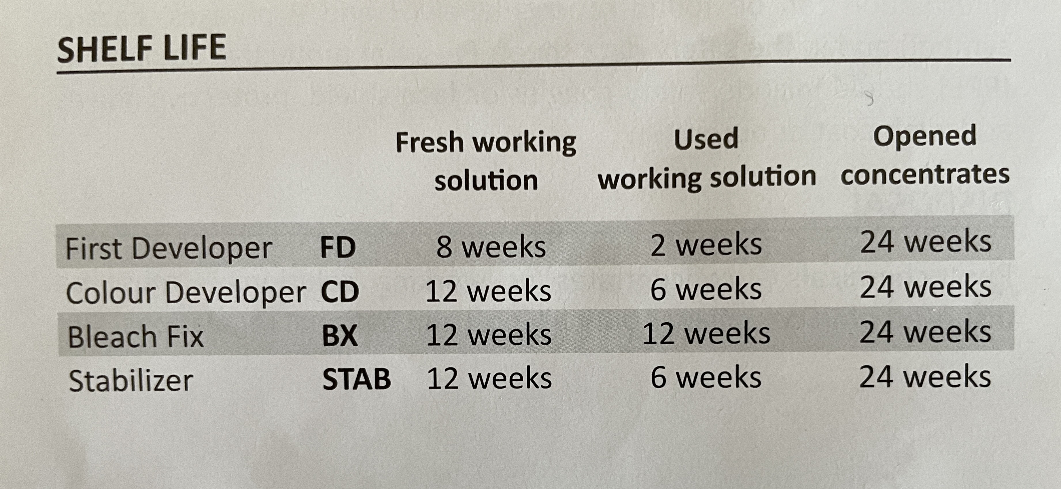

I used the Tetanal E6 kit for several years, in the 2.5litre kit form, to process 120 size Provia 100f films in a Paterson tank ... one by one (no doubling up). I would make up typically 550ml of working solutions (thus getting 4 lots per kit over several weeks) and typically process 5 120 films in each batch of working solution (sometimes 4, very occasionally 6) over a few (3-4) days. Each time I made up the working solutions, I would use Protectan (or similar) gas to help preserve the life of the stock solutions.
The Colortec E6 instructions said that the stock solutions would last 24 weeks (using Protectan) and I certainly would have kept mine almost that long (5 months?) to make the last batch of working solution and never noticed any obvious degradation from the resulting transparencies. 24 weeks seems pretty good to me, and since Adox seem to be offering only 1 litre kits, 24 weeks would surely be very good.
Of course, I've never run test strips or done any objective sensitometry/densitometry, but nothing stood out as problematic.
Am I missing something? (Quite possibly!).

I split up the 5L Tetenal 3 bath kit into smaller bottles and used it over a 5 year period with excellent results. If Adox has duplicated this formula should be great. E6 is a rare bird these days. Not cheap
I bought the 2.5 litre Tetenal kit for many years, and would make up 500ml of working solution at a time to process typically 4-5 120 films (occasionally 6). According to the instructions (see attachment), the stock solutions would keep for 24 weeks, and I used Protectan/inert-gas and would occasionally keep them a bit longer ... although not the 5 years reported by mshchem!
When the Tetenal kit became unavailable, I used the Bellini 6-bath 1 litre kit, again making up 500ml of working solution at a time. As far as I could tell .... but obviously I could not do proper comparative tests ... the results with the Bellini kit did not seem any different to the 3-bath Tetenal. I wrote to Bellini about the storage time of the working and stock solutions and got the response:
  • Stock solution (concentrate) in original bottle opened once and capped, with air squeezed out of bottle: 5 weeks.
  • Working solution (mixed for use): 7 days.
  • Unopened bottle of stock solution (concentrate): 1-1.5 years after purchase.
(They did not distinguish between the developer/bleach etc).
Both the Tetenal and Bellini kits were/are excellent as regards image quality. I once tried the Cinestill (Daylight Chrome) kit but it definitely gave different ("flatter") results and did not work so well for me.
