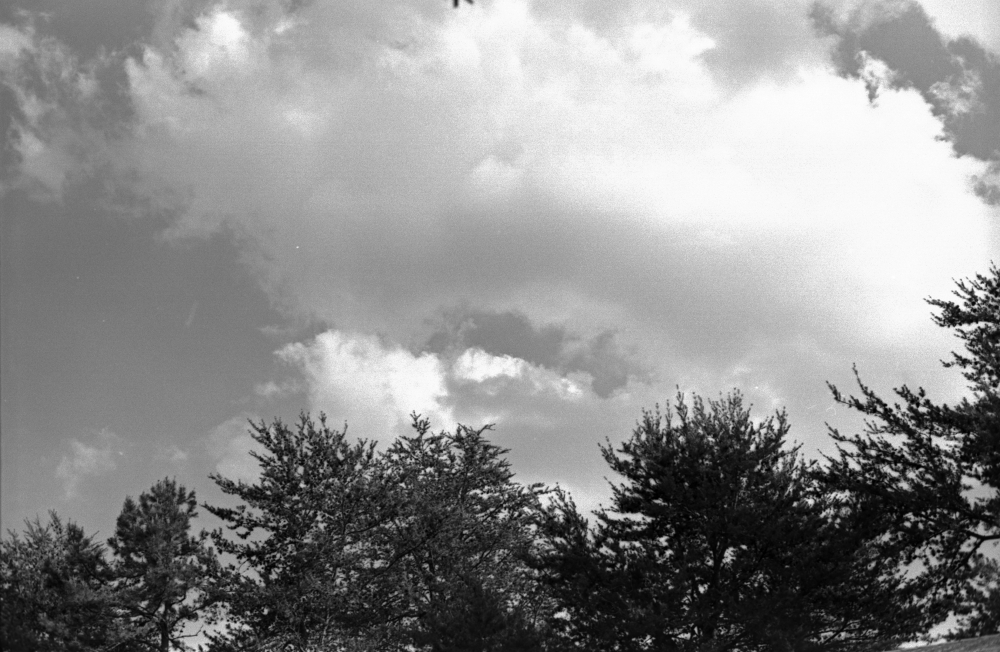

I've got negatives that disagree with this claim -- from original CMS 20 as well as from 1990s vintage Imagelink and Fuji HR microfilms, and from Copex Rapid.
Definitely some considerable gradation, and the extended red sensitivity helps pull clouds out of the sky at an exposure that doesn't completely lose the conifer foliage.
Original Adox CMS 20 at EI 25, developed in my Caffenol LC+C; shot with my Pentax Spotmatic SP and Super Takumar 50/1.4.
View attachment 330419View attachment 330420
