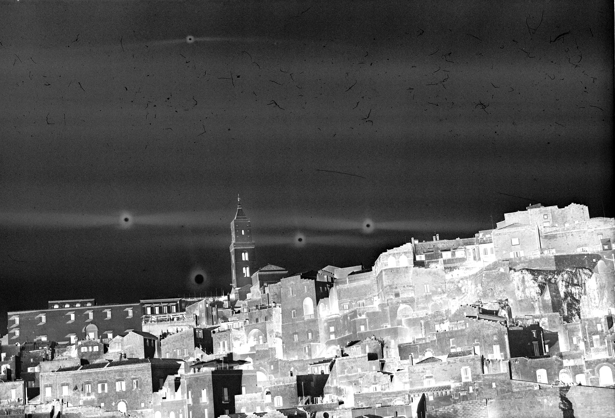

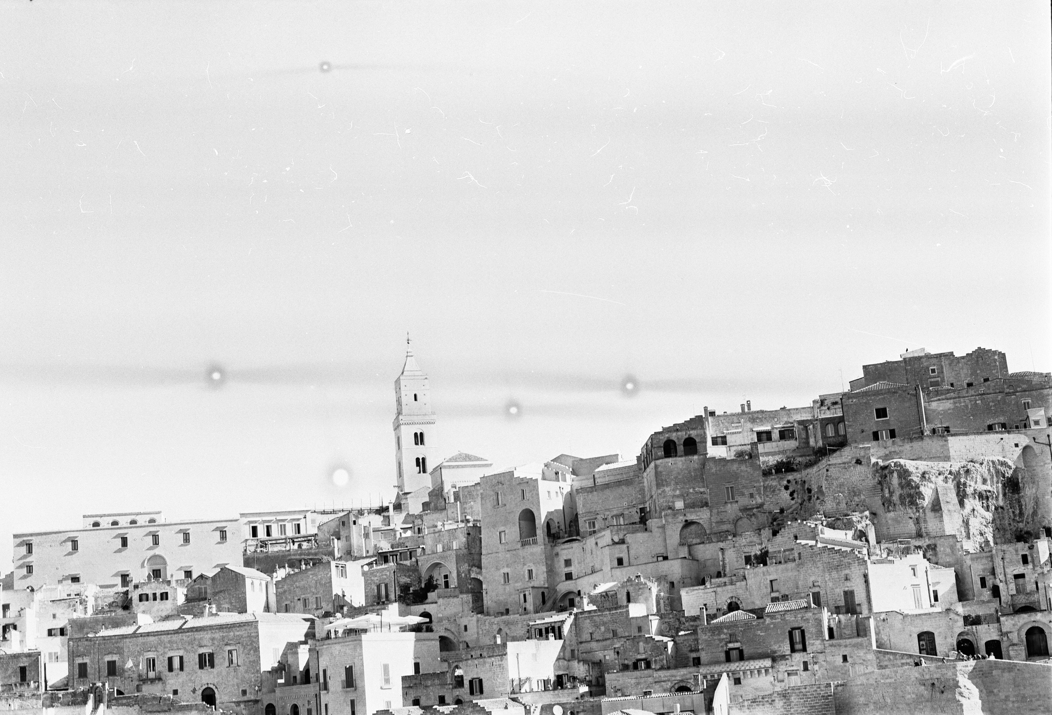

Hello guys,
I would like to know your opinion about the light spots you see in the picture below.
I took this shot a few months ago and developed it only recently. The film is Adotex CMS 20 II Pro. This is not the only picture of the roll showing light spots, which, however, in other shots appear with different sizes and in different positions. Given this and the fact that in all other rolls I've taken thereafter there is no trace of such spots, I wonder whether they are, rather than light leaks due to pinholes in the curtains, artefacts stemming from a wrong development. Or, in fact, are they tiny light leaks, which become only noticeable at long exposure times?
As you can see, the film is highly scratched too. It was my first experience with it, and I must admit I had some troubles when loading it into the reel. It kind of jammed. The are also "bands", which are likely due to an uneven development. Yet, I was careful during the first 30 sec. of agitation not to be too harsh, and so was I at each single inversion to be repeated every following minutes. Perhaps, the fact that the room temperature was of 26 Celsius degree didn't help. When developed in ADOTHECH IV at ISO 6, the solution must be at 20 degrees; I poured the developer in the tank at that temperature, but the stop bath and the fixer were at room temperature.
Is there anyone familiar with this film who can enlighten me a bit? Thanks a lot!

What you consider as scratches is dust.
Why it settled only in that part of the frame has yet to evaluated.
Thank you dear! Good to know it is just dust and not scratches. Regarding the uneven distribution, I thought that the scratches (dust) were all over the negative, and that they were simply more visible in the lighter and less detailed parts of it. True or not, I can definitely improve in this respect and try to keep the negative away from dust particles.
I still wonder about the cause of the light spots. I really don't know whether they are light leaks or something else; for examples, air bubbles that were not dislodged during the development. In this respect, let me add this: I developed two rolls in the same tank. The light spots are in some frames of one roll and only in a single frame of the second roll. In the second roll, though, tI can see an uneven development in the shots taken at lower exposure values. To give you an example, you can look at the two pictures in attachment. The first one was taken indoor with an EV of 6, the second one outdoor with an EV of 13.
To make things clear. I don't think there is any problem with the film itself. I believe I did something wrong when developing it, and I'm trying to figure out what exactly. Thanks again for your help!

I have never seen marks like that before. White dots with dark tone around them... which on the negative would be black dots with light tone around them. The other stuff appears to be black lint-like stuff stuck to the film...

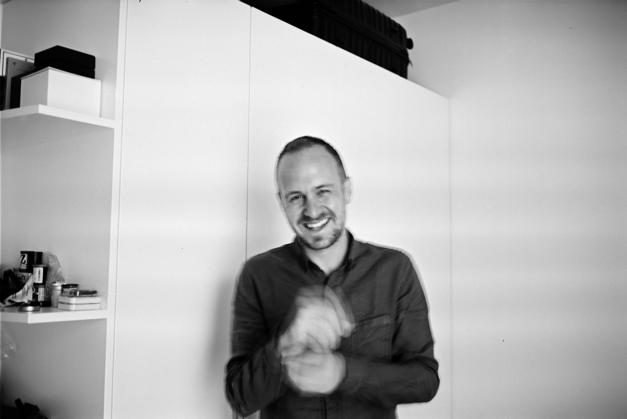

Sorry for the low res quality but I've just copied this from a digital contact sheet done with my Epson. But the results are the same if I use my Nikon Z7, the spots are NOT due to the scanning method. They appear on frames at the beginning of the film, and are random in that the frame before this is clear, and the frame after is clear. Subsequent batches of CMS20 II are also clear of spots. When I was getting these spots I was only using Adotech IV as the developer and following the instructions to the letter, but I'm not blaming the developer as the last two thirds of the roll are clear of faults of any sort.
