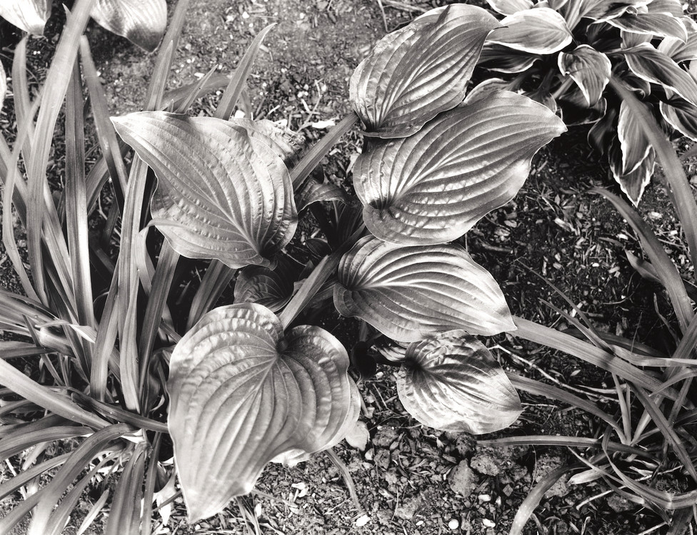

Just one more to illustrate highly dilute semistand in D-23.
Beyond about 1:4, D-23 loses a lot of alkalinity because there's not enough Sodium Sulphite left in solution to make it all go. But - higher dilutions are of interest because the more you dilute D-23, the less it acts like a solvent developer (because there is less Metol in solution). That means the developer doesn't nibble away at the grain as much and you get - in theory - sharper negatives. The fix for this is to dilute D-23 highly but add something to kick the alkalinity back into a better place. This works well for larger formats (Image 1) but can really make grain visible with smaller formats (Image 2).
Image 1:
9x12 Fomapan 100 exposed at box speed (EI 100) and semistand developed in D-23 1:9 with 0.5g/l of sodium hydroxide (lye) added. I If you look closely, you can see a single strand of vegetation rendered sharply in the bottom center of the image. That's the high acutance due to the extreme dilution.
Image 2:
35mm Double-X exposed at box speed (EI 250) and semistand developed in D-23 1:9 with 0.5g/l of sodium hydroxide (lye) added. By reducing the solvent effect significantly, the grain is rendered with great acutance and just beats you over the head. That's not necessarily a bad thing, and could be used to good aesthetic effect, but I'm not a fan of this for the general case.

Trying to use low or moderate scenes to prove "box speed" ability using certain developers is not really a fair fight. Try it with a full range scene. For instance, Foma 200 is indeed capable of reproducing around 11 or even 12 full stops of range under routine development, but not at box speed - more like half of that (100). Now try your semi-stand or whatever trick using the same parameters. Go photograph an extreme range scene, and see if you still get full linear response or not.
Second issue : what is highly dilute D23 with all its sulfite grain-solvent effect doing to the edge acutance? I've never used it for anywhere near that length of time.

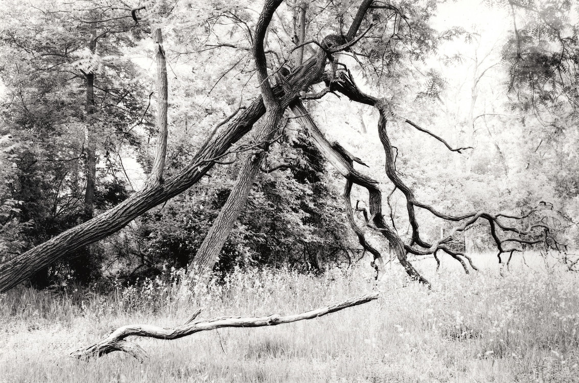

I don't have a Fomapan 200 image like that, but I do have this one:
Image 1
9x12 Fomapan 100 exposed at box speed (EI 100) and semistand developed in D-23 1:9 with 0.5g/l of sodium hydroxide (lye) added. Between the deep shadow in the bushes and the sun beating down on the branches center right, this was a challenging SBR. There is plenty of negative here to interpret and play with. The entire SBR is held well without compressing the mid-tones to the point of complete boredom. I've still not settled on a final interpretation. That said, this particular glade in the woods is one of the mountains I climb periodically as I've not yet found the expression I really love there...

The 9x12 scene of logs is sharp as testified by the one strand of grass? you pointed out. Some of the highlights look a little blown on the end of the logs but for all I know the end of the logs themselves may have weathered and dried to a near white with little texture
The 35mm scene of "tickets" is equally sharp but again the front sign with fantasy on it looks a little blown out as if the sign artistry has serious faded and may be that just the problem i.e. it has just faded and is not blown out My first thought here, had it been a print was that a higher print contrast was needed. On the other hand the trees in the background do appear to have detail which a higher contrast might destroy
Maybe the whole of the tickets' painted frontage has seriously faded in real life so what I am looking at is the genuine way it is and diluted D23 in low agitation and long development has captured the scene in a way that conventionally process D23 could not manage?
The only way to be sure would have been to have taken another neg and developed it normally I suppose
Yes there is grain when I use my software on screen magnifier that I think magnifies it at least 4 times so I wonder what restricting the dilution to 1+4 but using low agitation would have done i.e. what might be the gains and losses compared to 1+9 plus lye?
Finally the forest scene in the light conditions looks to be one of those scenes where the challenge to make it look more interesting is a very difficult one under any processing regime but the detail on the trees' bark does look full of detail

The key to evaluating the images posted is not ISO but exposure. The photographer's meter can be set at lower or higher than box speed and the resulting image be underexposed, overexposed, or correctly exposed, depending on the metering skill of the photographer. You really need to conduct a film speed test according to ISO or Zone System standards for each film, developer, and development routine you employ, and work on metering consistency. Then, of course, there is interpretation during printing.
For example, the image of trees in post #112 is lovely, but from a technical point of view, the sky is completely blown out, as are the highlights in several areas of the tree trunks. In addition, the main tree trunks appear to be unnaturally light. The only way to determine whether this image was exposed at the technically correct ISO/exposure would be to see a print exposed for the minimum time for maximum black at the film edge. As I said though, the image is lovely as printed regardless of how it may have been exposed.

This particular location at that time of day calls me back from time to time. it's a beautiful spot but it's a technical nightmare to capture. The range of light is all over the place and there is no exposure placement that makes it entirely satisfactory to my eyes.
Here's another day's attempt from a slightly different angle done in DK-50 1:4 + 0.5g/l lye. I find this one far less satisfying than the one I posted above. It has none of the atmospheric sense...

I think the highlights looking blown out may be a monitor calibration mismatch. Both on my monitor and in the actual prints, the areas you mention show good detail. My monitors are calibrated - initially with a colorimeter and then tweaked by hand - to, as best as possible match the prints. But that doesn't mean it will match your viewing setup. This is the bane of internet image exchange.
The advertising panel in front of the ticket booth is definitely very bright (it was under direct assault by the sun) but shows detail. If I cared deeply about this image, I'd probably burn that a bit.
I do have a plan to, at some point, try 35mm Double-X in a less dilute version of D-23. The 120 version of this film is really nice to work with so I have high hopes for the 35mm incarnation. Clearly, using a super acutance developer concoction like I did isn't appropriate for negatives this small unless you're seeking that look.
I do know that it's possible to shoot into very high SBRs with high speed, small format film, and get very clean grain. Consider this print scan from a 35mm Tri-X negative processed in highly dilute Pyrocat-HD (1.5:1:300) and processed for an hour with Extreme Minimal Agitation - 2 min initial agitation and three equally spaced 10 second agitations during the hour. Apologies in advance for a lack of sharpness across the frame. It was shot handheld with a Nikkor 85mm f/1.4 lens that - while very sharp - has very limited DOF:
The image in post #112 was developed in D-23 1:9 + 0.5g/l lye, so a modified Metol developer. The image in post #116 was developed in DK-50 1:4 + 0.5g/l lye, so a modified Hydroquinone developer. The later image is darker with more detail, which could be attributed to film exposure, developer, developer routine, and/or print exposure.
