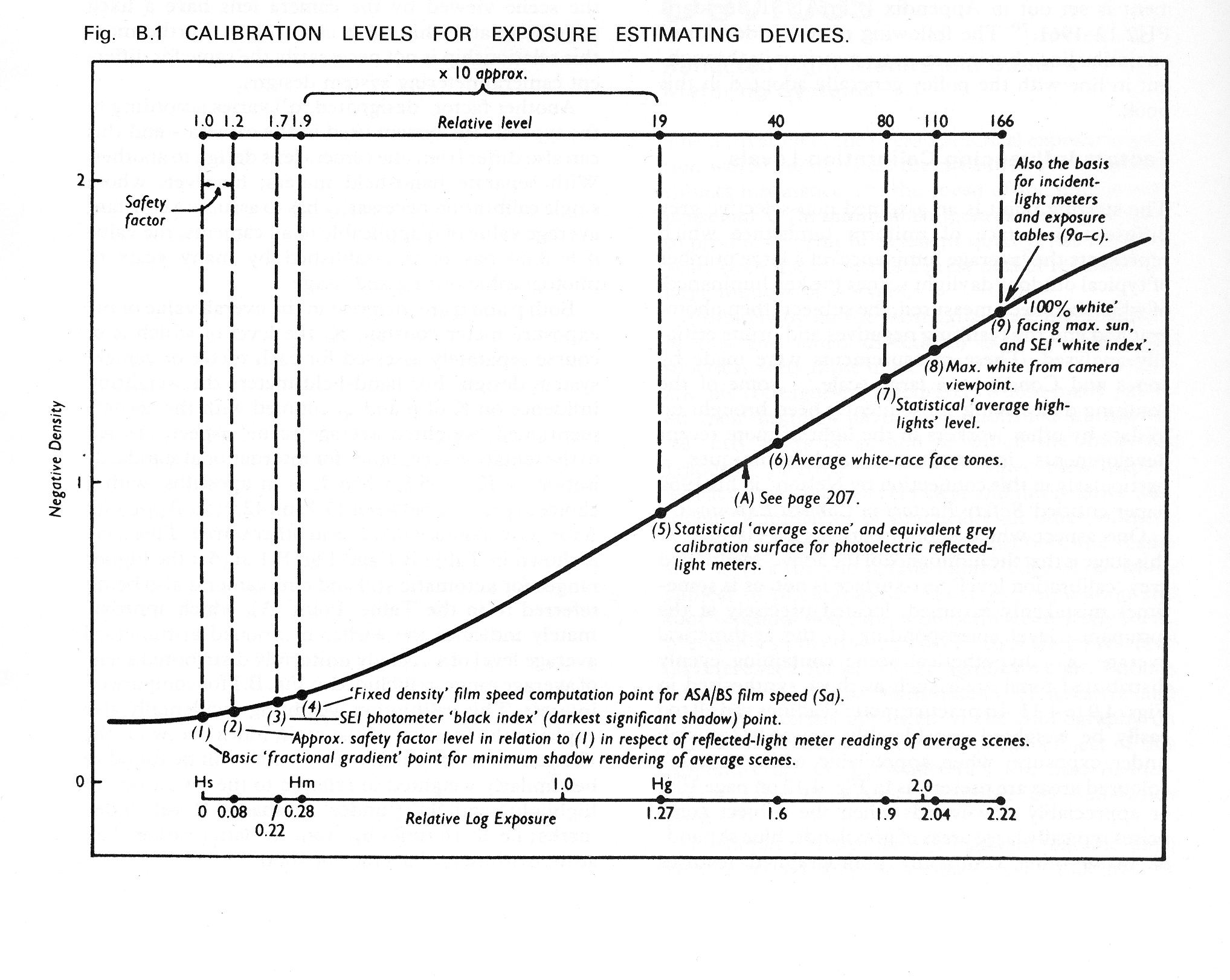

Jack Dunn in Exposure Manual has a very nice illustration of the relationship of exposure on the film characteristic curve. Other sources do the same but Dunn's is clean and easy to read.

3) I prefer to print from negatives that are not too dense;
4) I print with a diffusion light source. I scan with a relatively inexpensive flatbed scanner;
5) I have a spot meter, and I'm generally willing and happy to walk up to my subject to take close readings of highlight and shadow areas, but more frequently than not I use incident metering when the option is available.
Based on all those factors and preferences, I find that I get results that I like if I use an EI of XXXXX.
Here is a backlit digital image of some negatives that I am happy with, where I used that EI."
That answer includes the terms of reference that might help make it meaningful.
